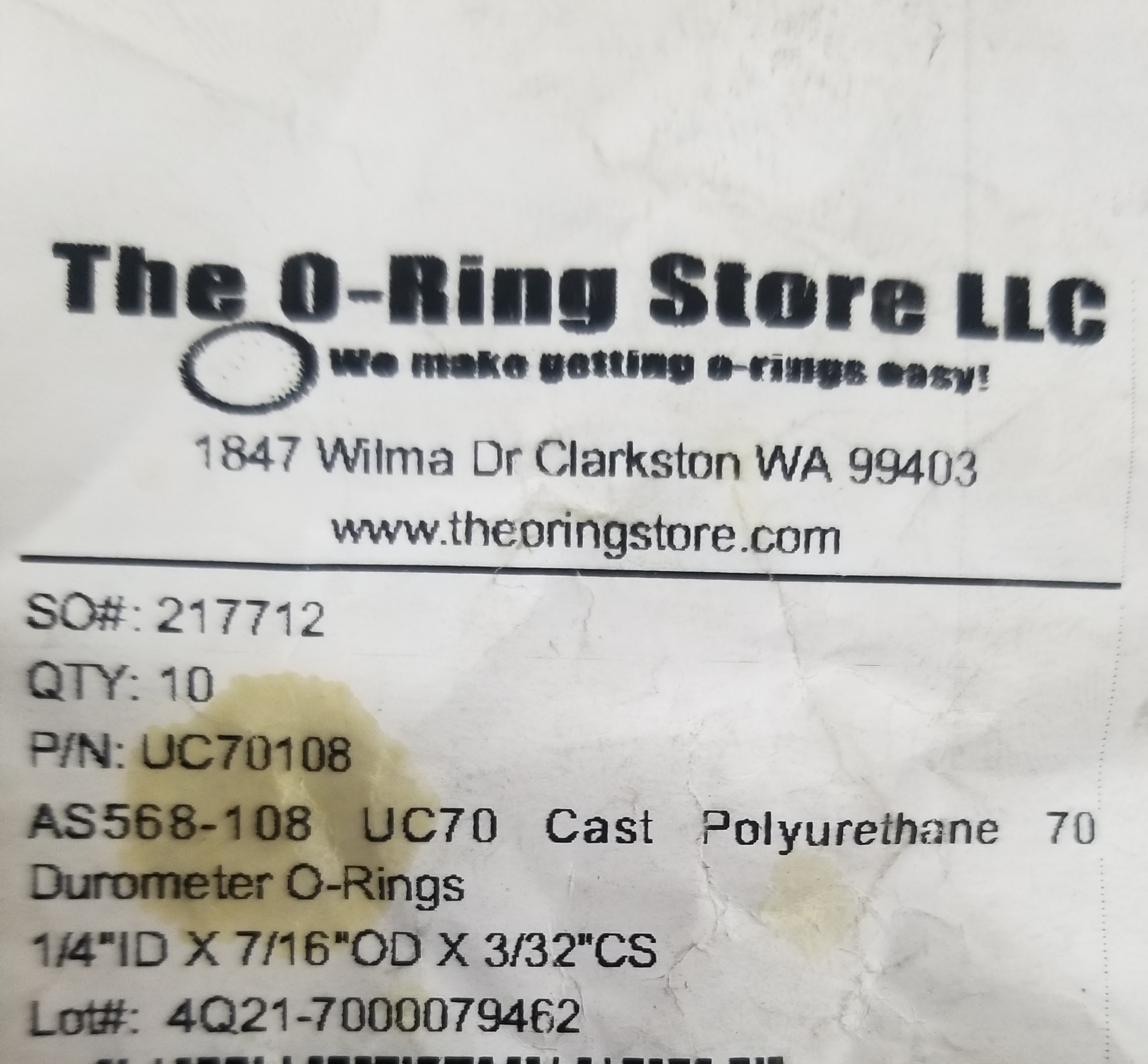

I bought some of these O-rings for the breach a while back they are fantastic, Also when I store the gun I made a little rubber block that I wedgr between the cocking lever and the barrel just barley enough to keep pressure off of the breech seals.
