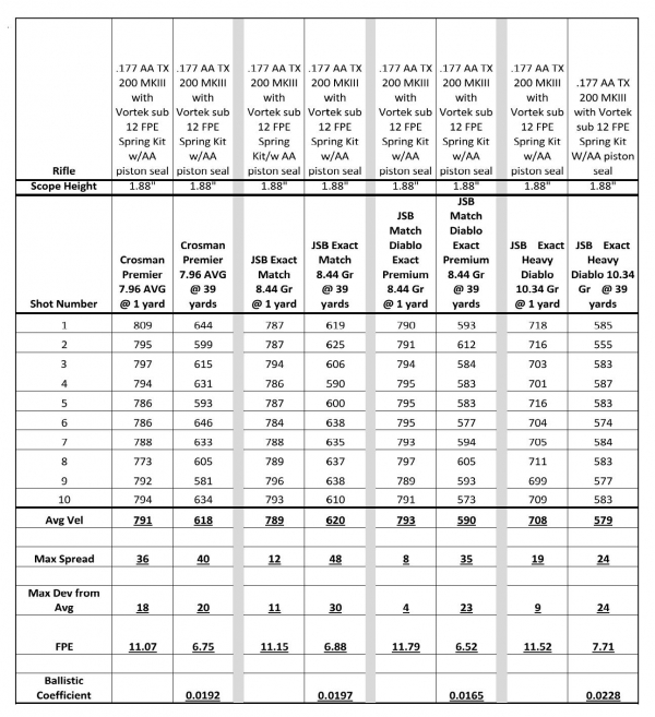

I have likely shot far more than 1,000 shots through my TX using (2) Chrony Pros - one at each end of the spectrum to get the most consistent comparisons possible, measuring up range and down range velocities on the same pellets, etc.
To quote ballistics pre-corrective work would not mean anything as they were all over the place, very inconsistent, and very frustrating.
I have attached the ballistics recently observed, under the same testing conditions, now that the rifle performing in terms of grouping and consistency, to my expectations. I hope this helps. BTW - all pellets utilized were weighed to within +/- .005 gr. I have not measured head diameter for consistency.
