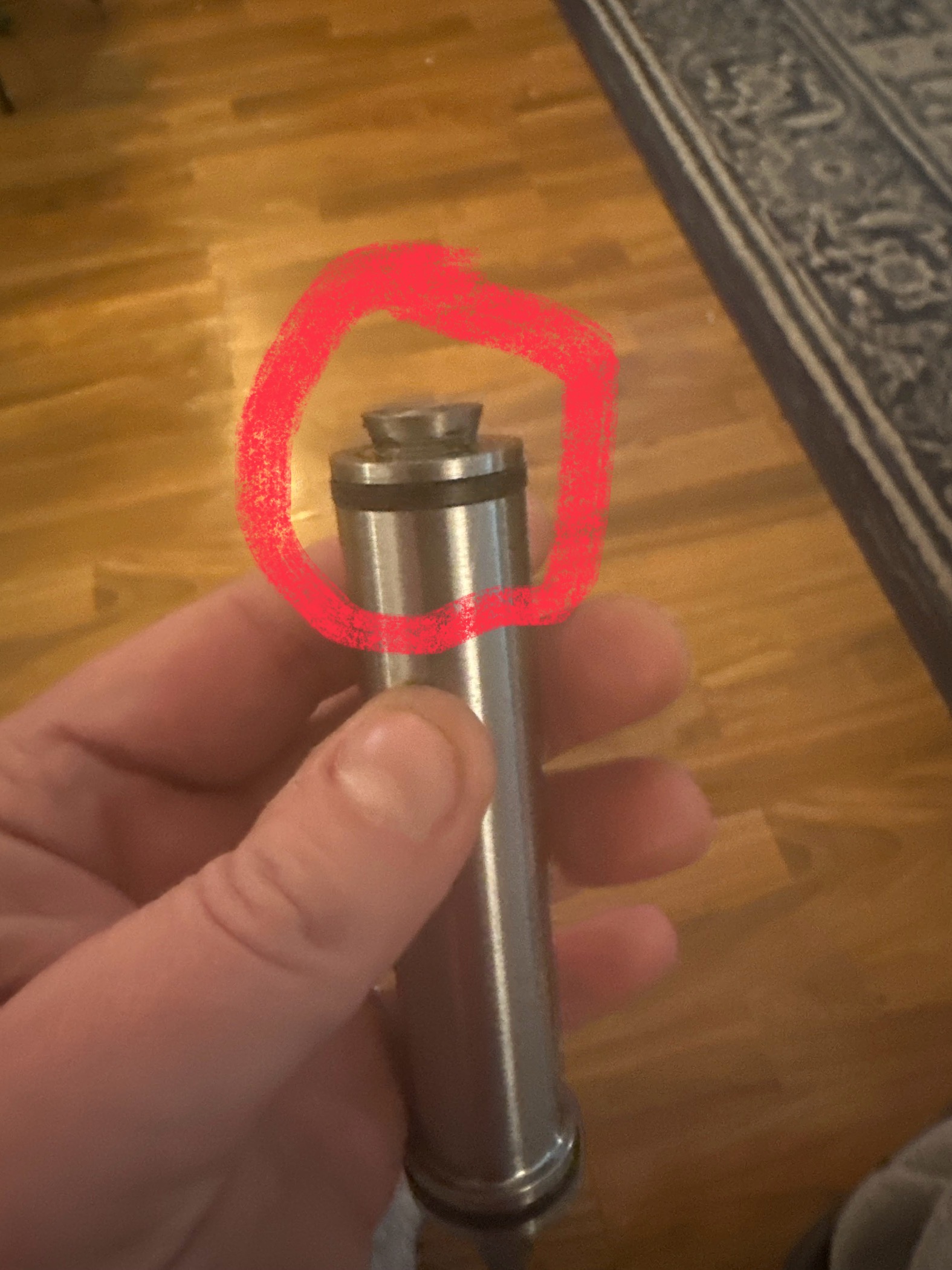

Hi All,
I have a quick question. I have an AA TX200 MKI and need to replace the missing seal that goes on the neck/throat of this piston. I purchased a Vortek AA TX200 Piston seal.... will that work? Thank you all for helping me out. kevin

Naa.. I think it's just how it goes and all .. lots prefer vortex seals i just use arh cause I use there springs and throw the seals in one order one shipping cost ..
I think you'll be fine.
You could always call or drop them a email on that and get that info straight from the hotels mouth on gun fit ..
Overall I don't think you'll have a issue. Looks right to use . And they don't list anything else for the tx 200 as a option..

There's nothing wrong with Vortek seals. Yours should work just fine.
Any seal you buy might be a tad loose (usually Vortek, sometimes factory) or a tad tight (usually ARH, sometimes factory), but that's because of slight differences in tolerances between the compression tube and piston seal. Either way, they straighten themselves out after a tin or two of pellets.
I know many folks who buy a Vortek piston seal for a better fit and ARH spring for longer life, then they have the best of both worlds. :)(y)

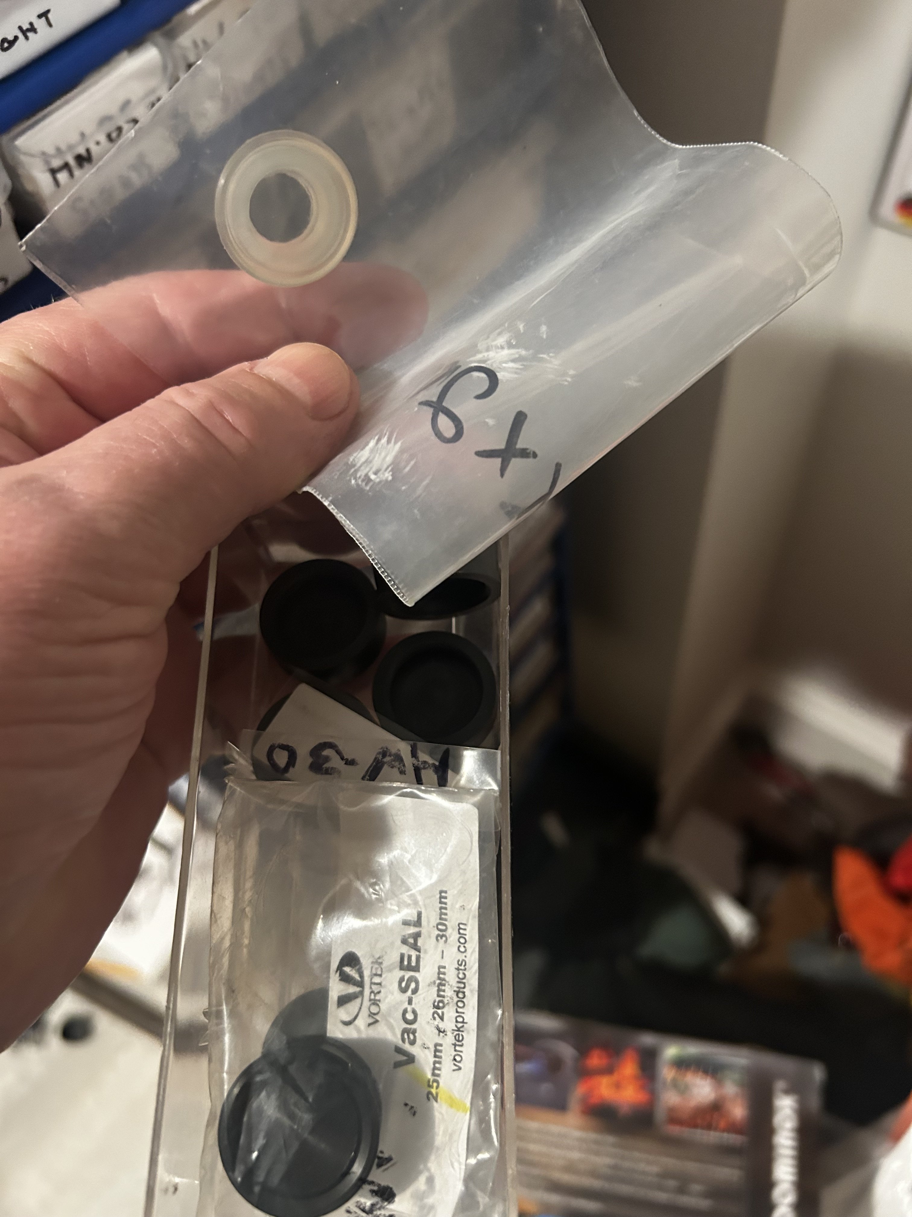

I don’t know if your MK1 is the same size piston as the current TX which I have. Can’t be much different. I bought about 50 Vortek piston seals last year. Most were 26mm then 25mm and last 30mm. Crow

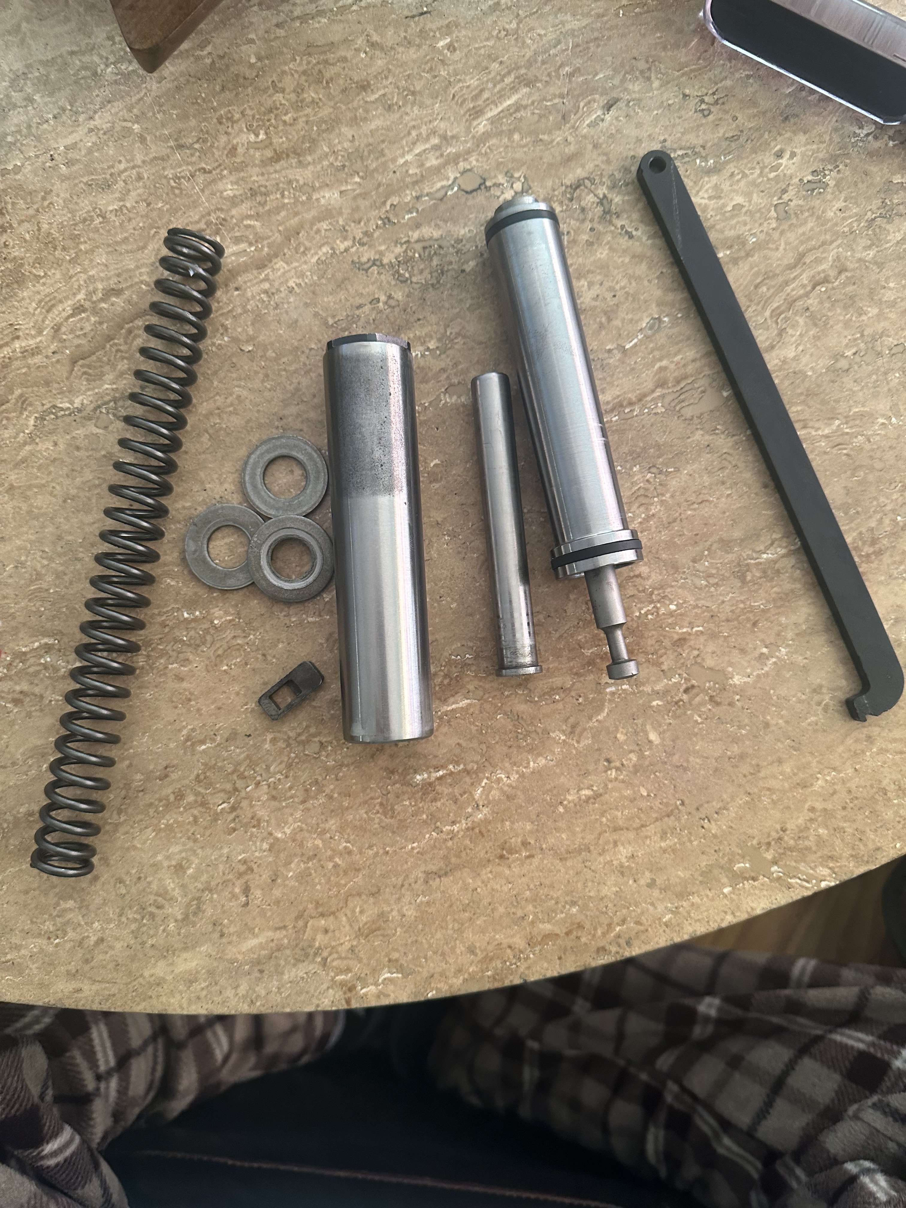

One difference is that the MKI doesn't seem to have a "top hat"; it also has 3 washers that i have not seen on the MKIII??? I have been VERY confused about this. I just ndon't want to mess anything up. When I took the gun down, the piston seal basically just crumbled... it was like 30 yrs old lol. The gun used to shoot like fire so i'm hoping to get her back in fighting shape. fingers crossed.
No aa guy but I think you may need to get this and go .. I don't recall as tx that did not hav a tophat and the mk1 was steel screw in coil .
Still could be replaced with nylon / synthetic aftermarket tune kit one as well
I'm sure a more educated air arms tx 200 huh will chime in with more correct info ..
