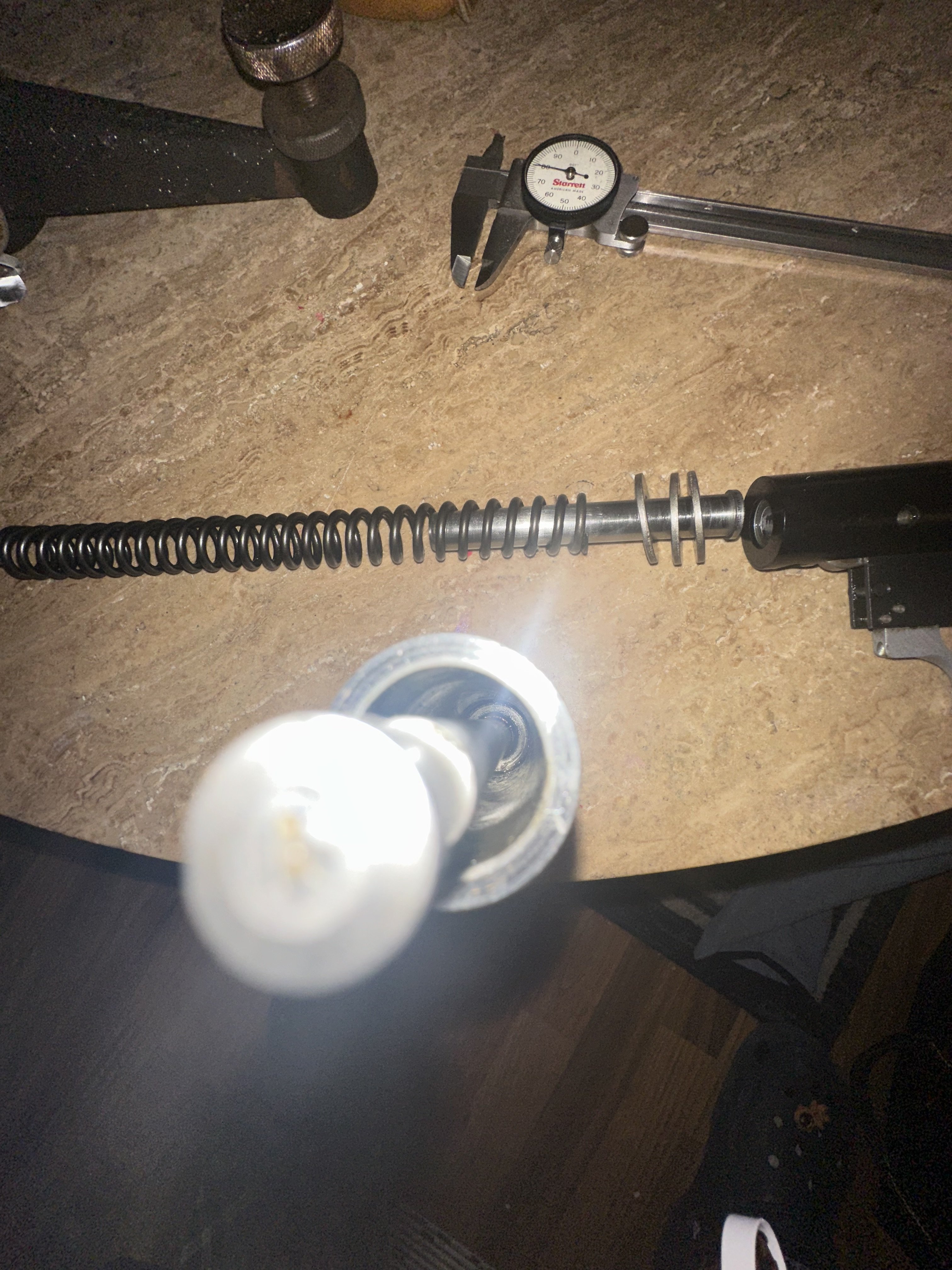

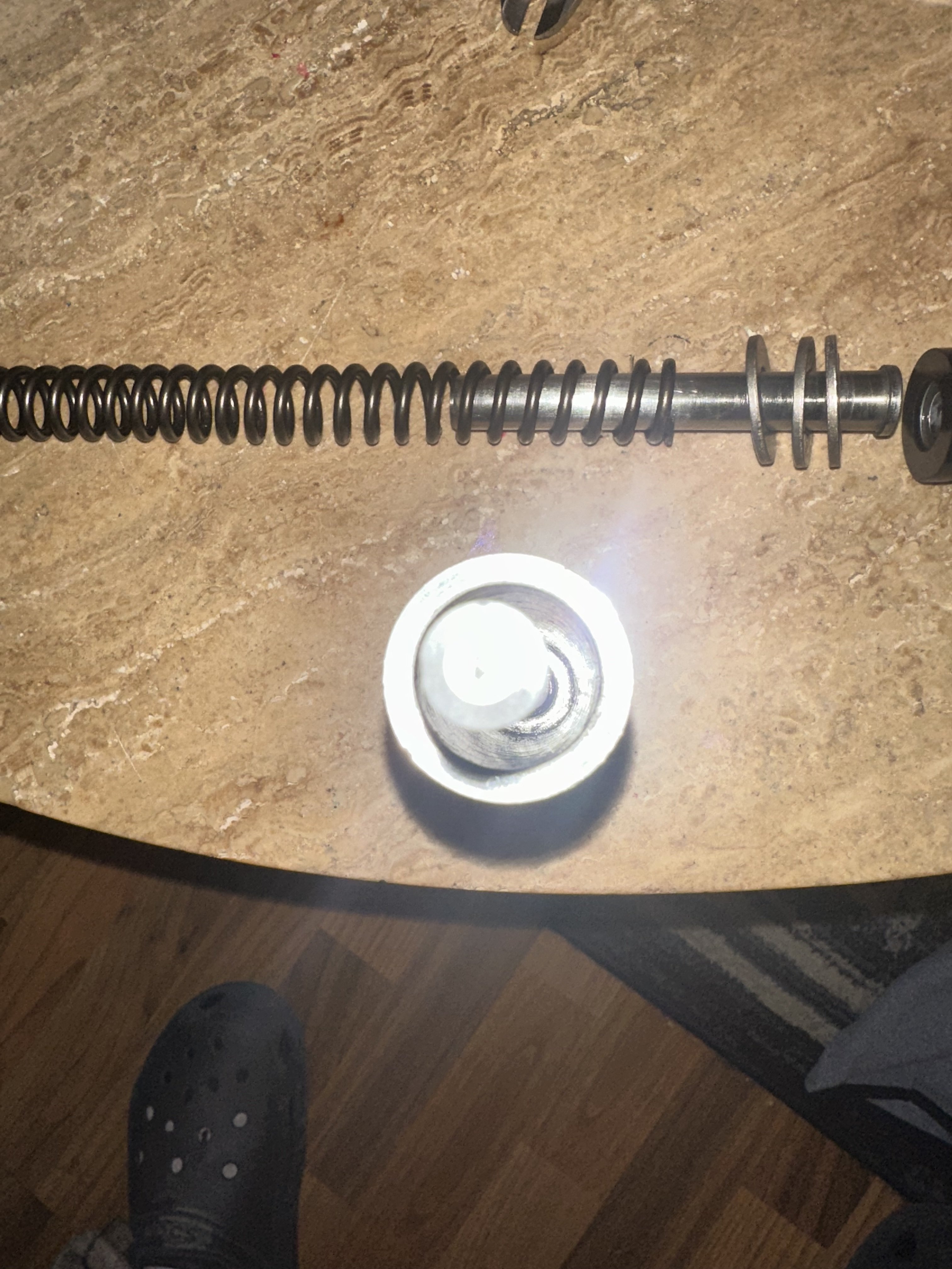

The top hat is probably stuck up inside the piston (held in place by old grease). You'll probably need to dig it out. Easiest way is to slam the bottom of the piston rod down on a piece of wood...The top hat...hopefully slides out.No aa guy but I think you may need to get this and go .. I don't recall as tx that did not hav a tophat and the mk1 was steel screw in coil .

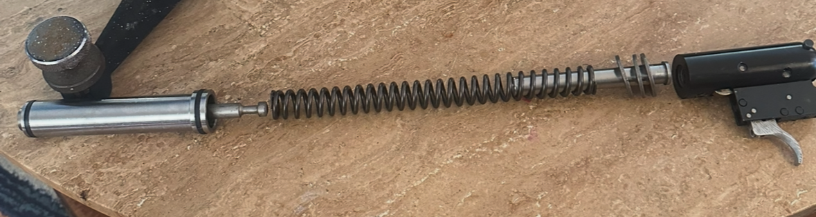

Here's the weird thing.... it's not there. i know it's crazy, but Tom at Vortek told me to me grab a few measurements, and do a few procedures like the one you described.... no top hat. The inside depth of the piston is correct as well. Tom just said, "wow, thats an old gun." It has never been taken down so it came from AA like this. The spring wire is .125" and it has 28 coils. The 3 washers also puzzled Tom. Maybe I am not looking at this thing correctly. I think I am putting it together correctly?!?The top hat is probably stuck up inside the piston (held in place by old grease). You'll probably need to dig it out. Easiest way is to slam the bottom of the piston rod down on a piece of wood...The top hat...hopefully slide out.
If not, shine a light into the piston to see if there is a top hat there (maybe do that first). Many ways to remover that stuck top hat (google).
Ya could be . I just figured I seen that mk1 screwed in to the spring coils . But ya I could see that stuck as well. Happens time to time ..The top hat is probably stuck up inside the piston (held in place by old grease). You'll probably need to dig it out. Easiest way is to slam the bottom of the piston rod down on a piece of wood...The top hat...hopefully slides out.

THANK YOU! I found this chart a few days ago, but I lost it. My new PG4 kit is on the way. When I get it, I'm gonna first just replace the piston seal and shoot a few groups and try to chronograph with phone??? Then replace everything with Vortek Pro Sport Kit and test it. This might get intresting lol. Also is the phone chrono worth a download or is it gahbage? Any suggested apps, I dont mind paying if it's good or at least decent.I can't ... Then maybe the reason for the washers to make up that gap of a missing tophat ?

As a former owner of two lefty Mk1, they did not come with what you have pictured. That looks more like the piston weight/front guide that was used in a FAC TX -The top hat is probably stuck up inside the piston (held in place by old grease). You'll probably need to dig it out. Easiest way is to slam the bottom of the piston rod down on a piece of wood...The top hat...hopefully slides out.
Thank you very much for this reply! I am so jealous of the lefties. I have always had a stupid cheek piece digging in my face. I'm not sure I can shoot with a left handed stock lol.As a former owner of two lefty Mk1, they did not come with what you have pictured. That looks more like the piston weight/front guide that was used in a FAC TX -

Now looking at tx200 stuff what left at ARH i seen this was interesting seeing you have 3 washers
"One thick rear spacer washer replaces the OEM 3 metal washers ."
