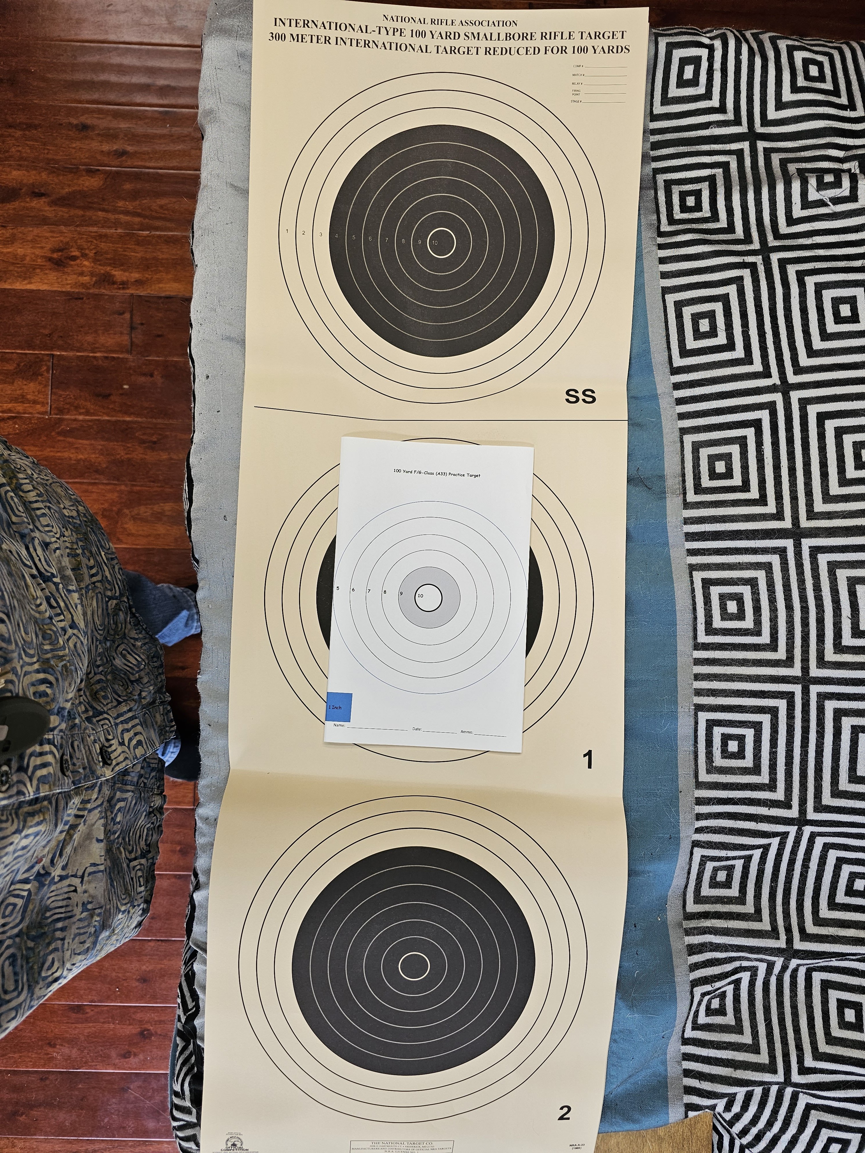

I digress. As i may have mentioned it was very still so I set up at 100-yards. I was using NRA A33 targets used in 100-yard F-class.
I shot the messed up AA Field Heavy 10.3 sorted to 10.3 but poor lot match. I shot AA Field Heavy 10.3 sorted to 10.4 but a reasonable lot. I shot AA Field Heavy 10.3 sorted to 10.4 and waxed. These last are sorted and waxed 10.4's from an older known good lot. I use them as a control. I am running low on those. Lastly, I shot Zan 10gr slugs.
The AA Field Heavy 10.4 waxed shot 2.2" over 7 shots. I shot 7 as I am running low on them.
The Zan put 7 of 9 shots in 1.72" with 2 flyers making all 9 in 3.50" overall. I am pretty sure that leat 1 of those wild ones was me. Maybe both. I don't know why I shot 9 and not 10 shots.
The AA Field Heavy 10.4's that are "decent" but unlubricated put 8 in.1.8" with 2 flyers making it 4.5" for 10. I don't think those were me this time.
The AA Field Heavy 10.3 sorted but mixed lot that are a poor fit shot 6.2". I shot 15 as I couldn't find a pattern.
