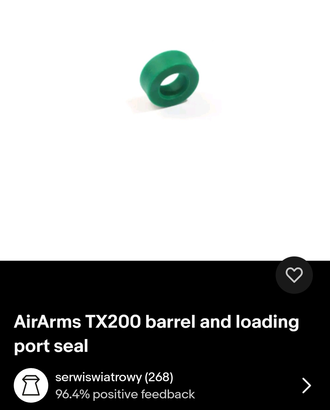

This breech seal wear looks pretty standard. If it was dieseling it would cause a failure like this as well. Yes, this can cause SD variation as well.

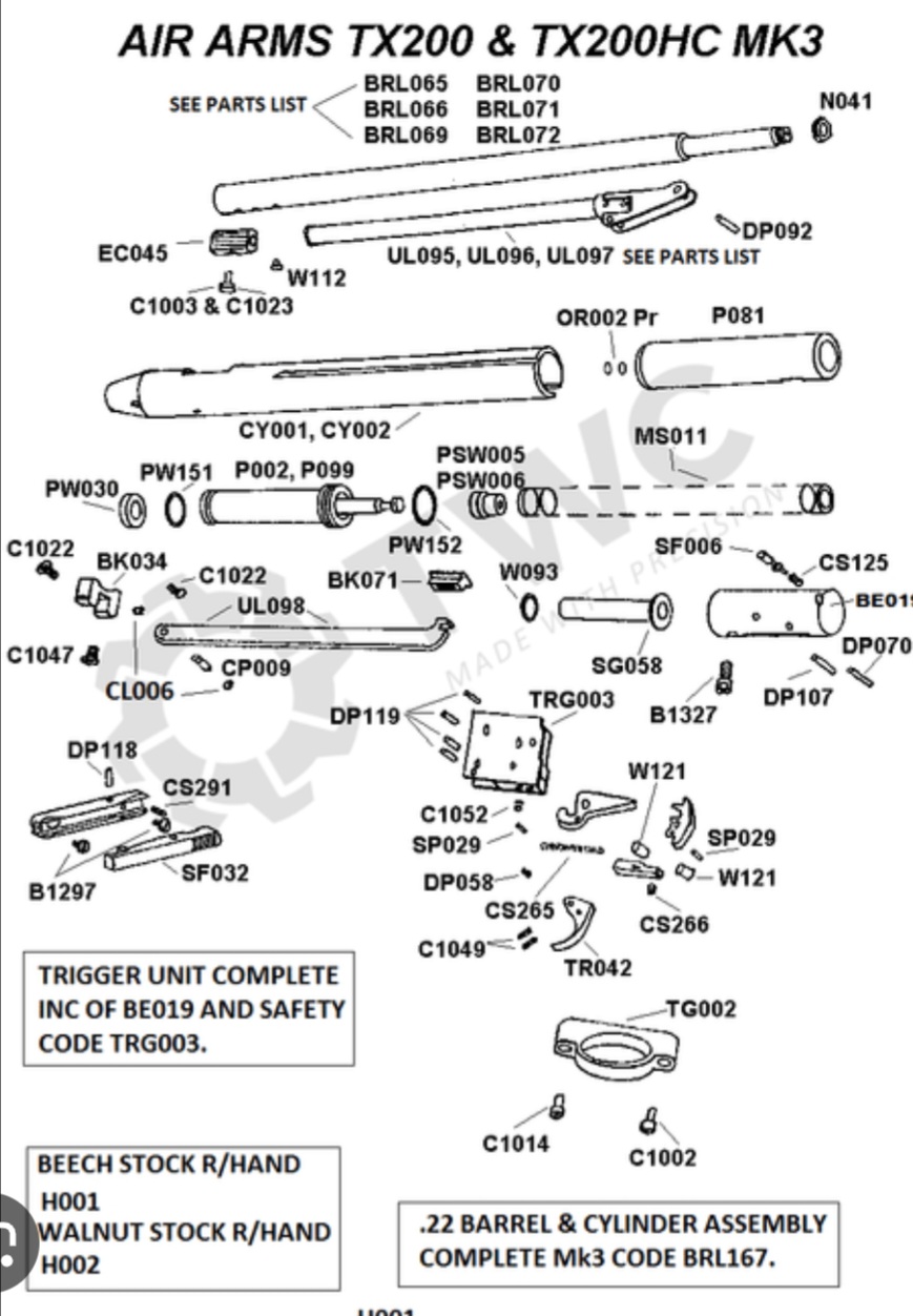

If you are talking about PW30 it looks bad to me and is needing replacement. I was thinking we were looking at part OR002 Pr. It too looks bad but as Hateful N and others pointed out failures are different.

I seen custom air seals Australia has some but did not check if they were there moly impregnated type seal..
Then i guess a guy could try some powdered moly like sold at amazon and just try to burnish some in a regular seal with some then lube ...? ..lol
