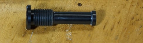

Can I put a moderator on a tx200? I need it as backyard friendly as possible. It’s a tx200 Miii .177
Thanks. Was afraid of thatThat will be a challenging endeavor as the TX200MK3 (not HC) shroud is not threaded. Not impossible, mind you, but you may need to think outside the box.

I'm not sure how that could fit a TX200. The cocking lever retention fitting goes right up to the muzzle.https://buck-rail.com/product/

Right. The retention fitting is the problem for the slide-on style.I'm not sure how that could fit a TX200. The cocking lever retention fitting goes right up to the muzzle.
Mr. SantoCan I put a moderator on a tx200? I need it as backyard friendly as possible. It’s a tx200 Miii .177
That piece is for the TX200HC. I have an HC that could be fitted easily with a moderator, but they are illegal up here in Canada. Ridiculous, I know.looked on line and got this , it is the end cap on the TX200 shroud . Not sure if it contacts the barrel end but it is 1/2 x20 threads so a female to male thread adaptor might work , ill check on UK forum im on .
