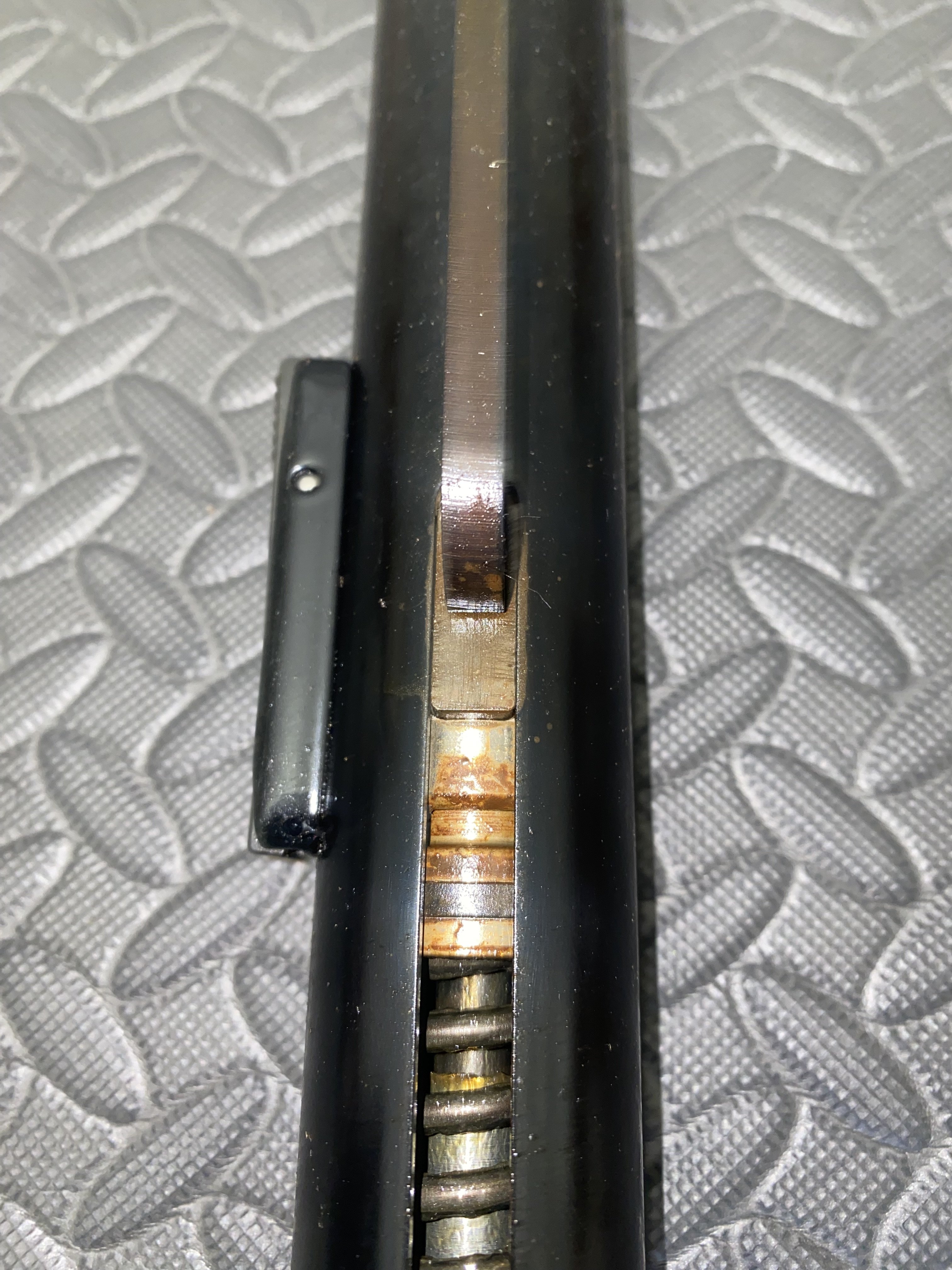

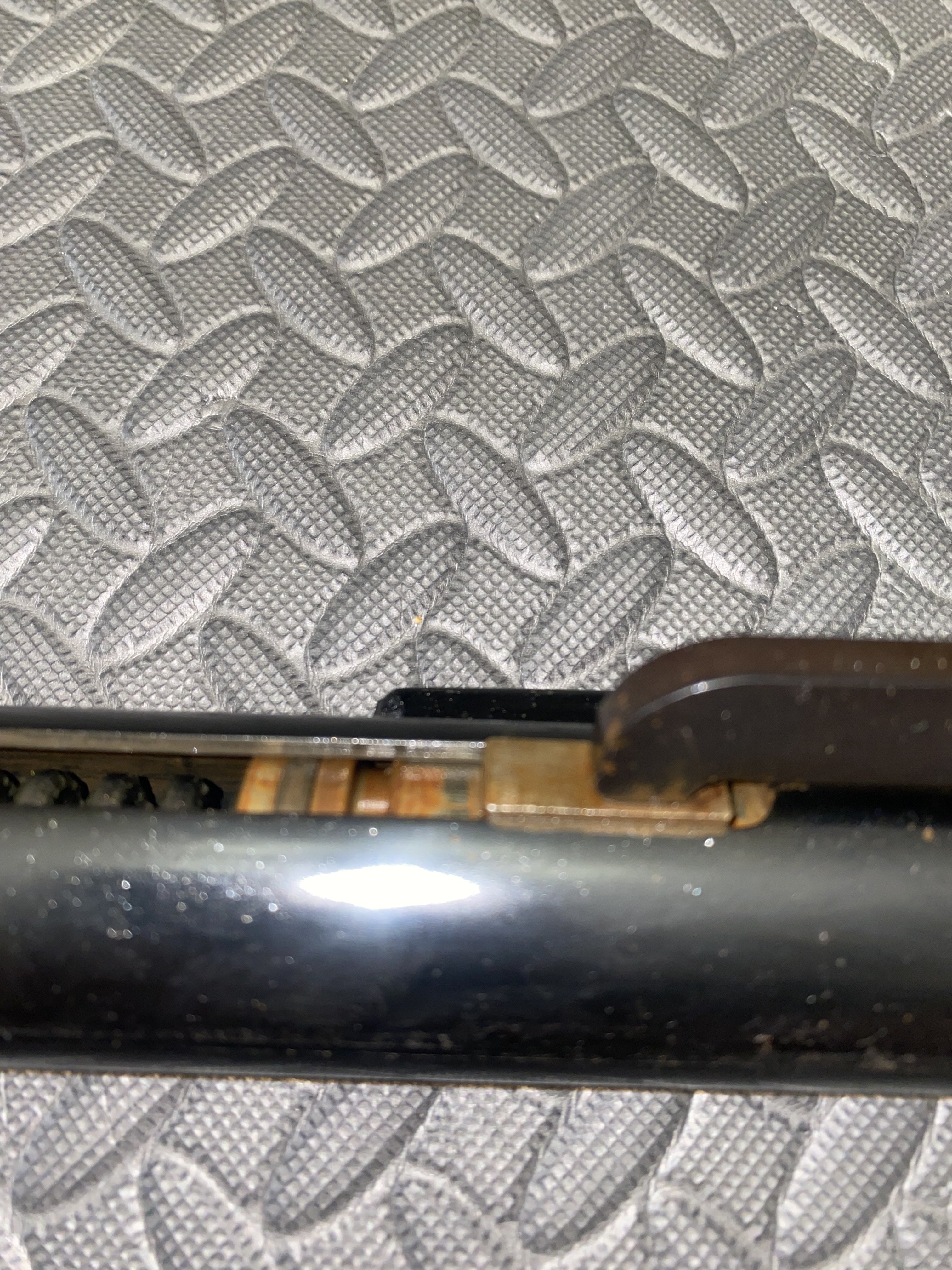

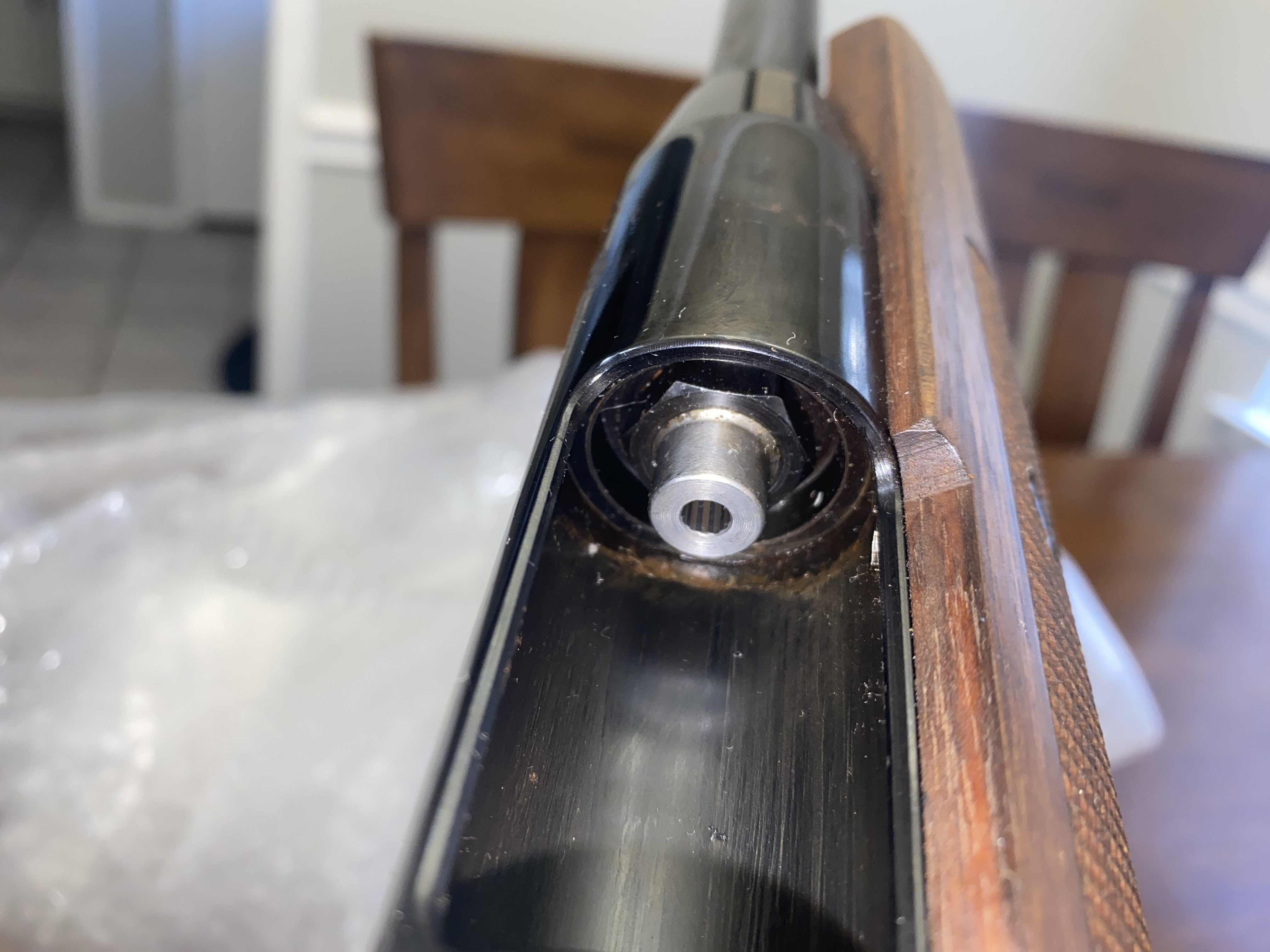

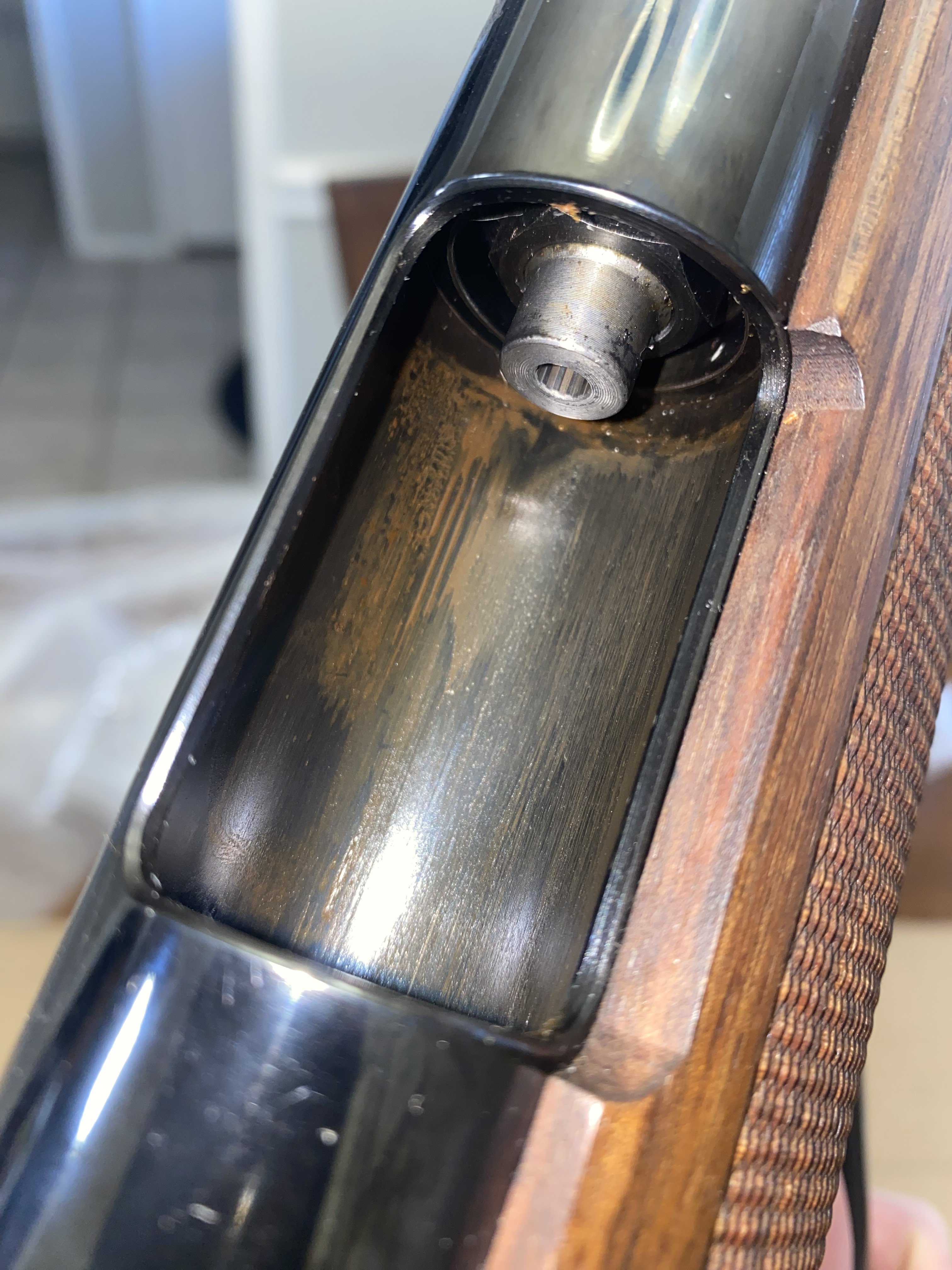

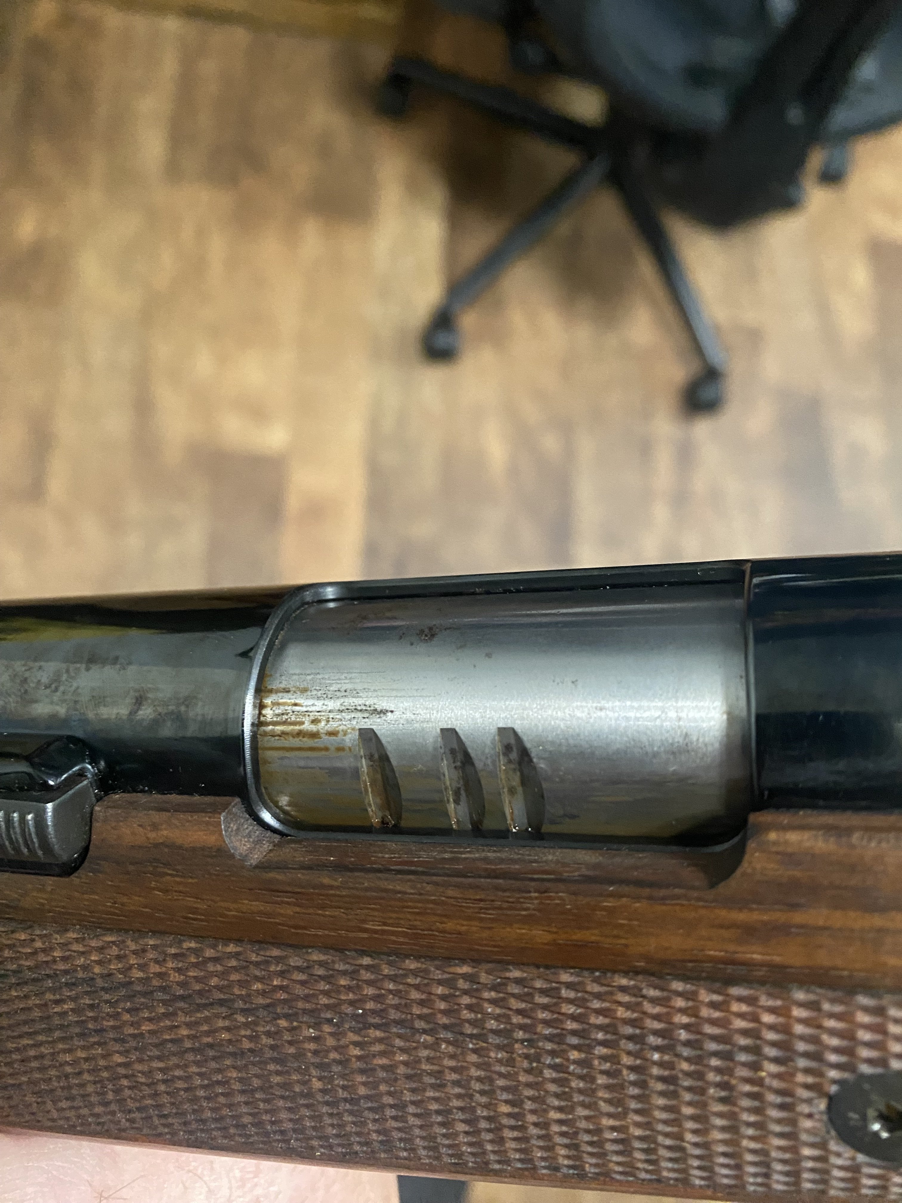

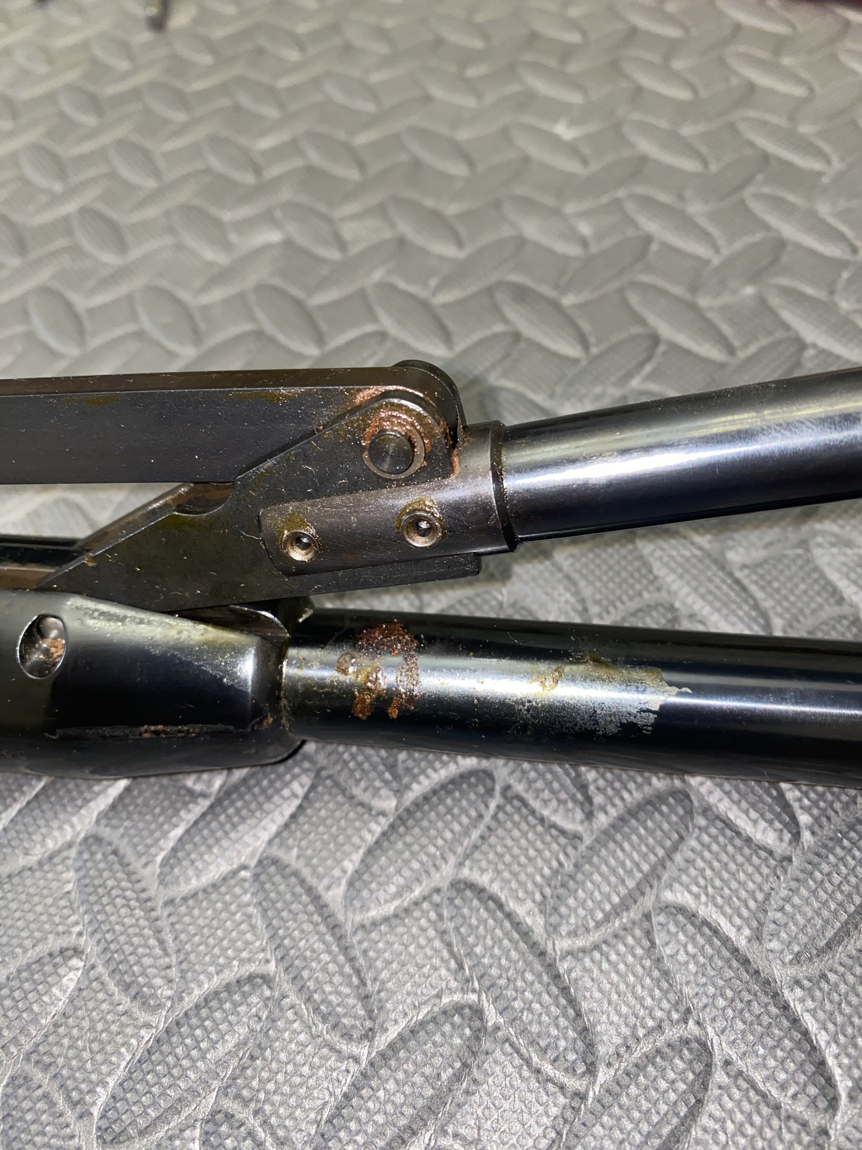

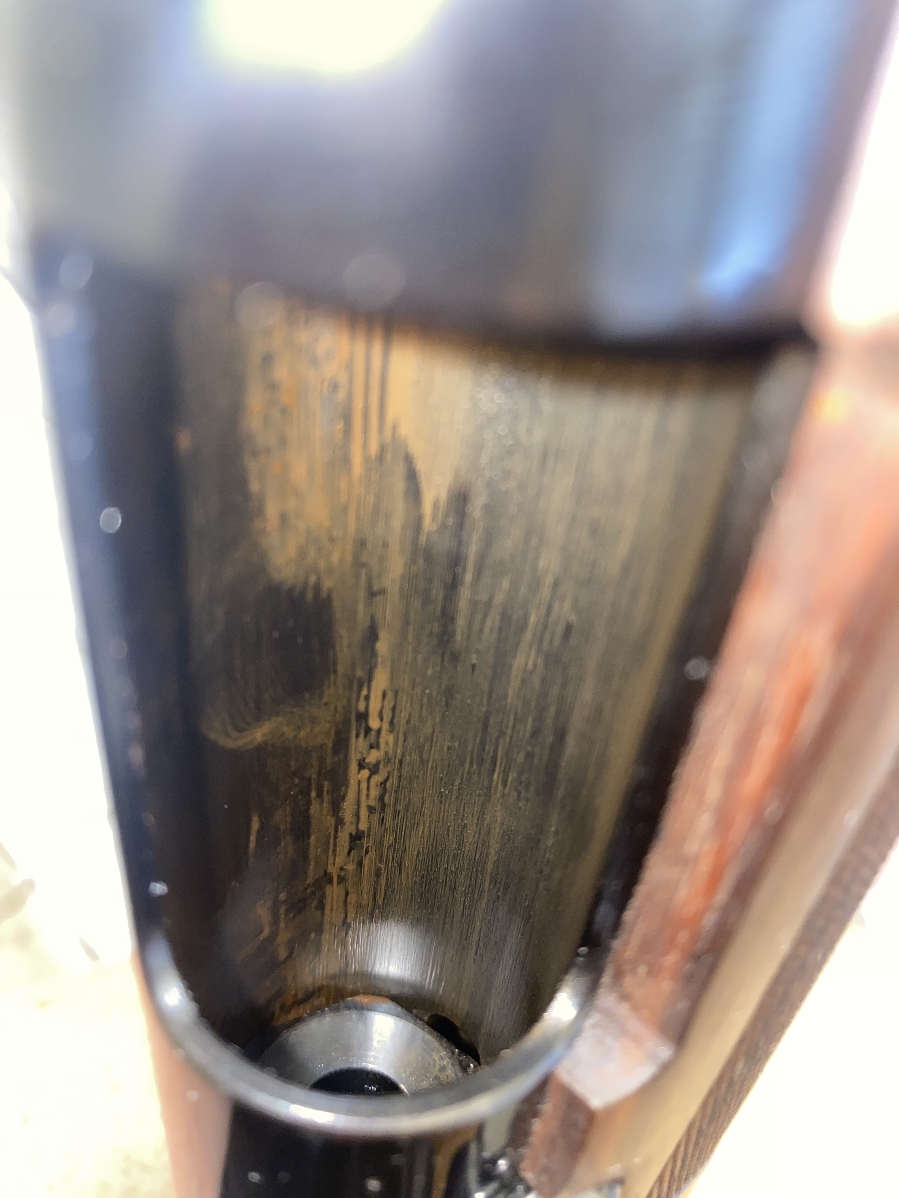

Edit: The gun needs a lot of work. Pulled the action out of the stock and there is heavy heavy rust all over the bottom of the barrel, the cocking linkage circlip rusted solid, and rust residue all over the piston that I could see (didn't do a full tear down). .

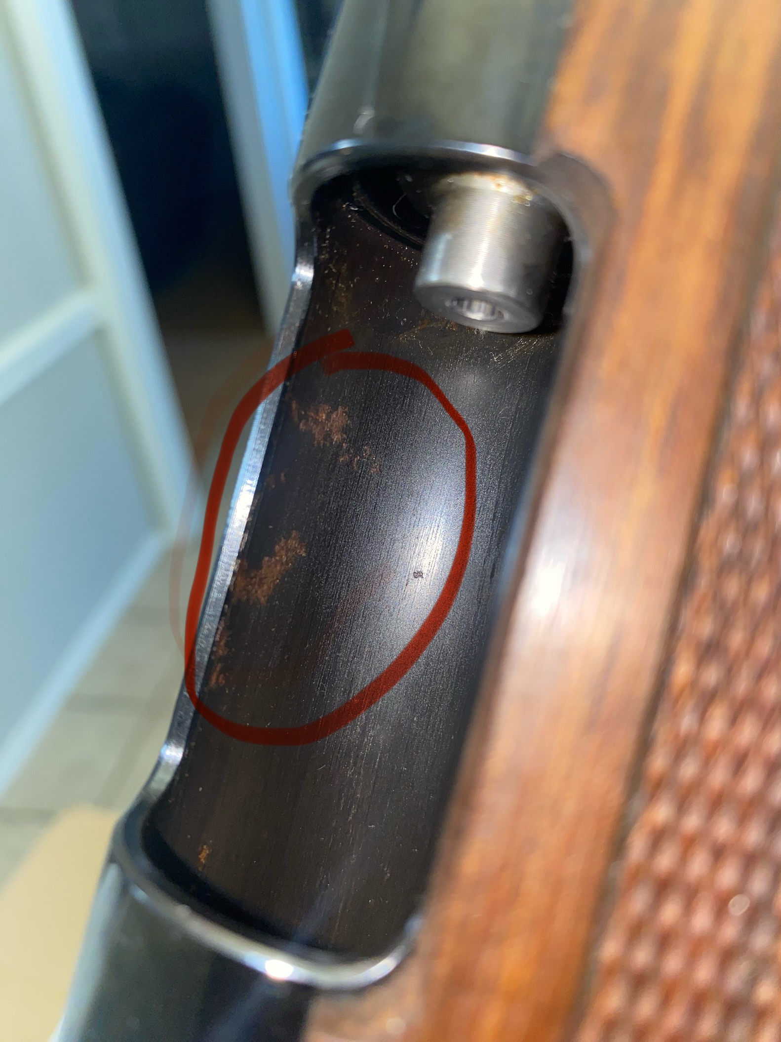

The circled areas are raised chunks of rust as far as I can tell. I can catch my fingernail on them.
Strip the gun apart and clean everything out, barrel and all. Then see how much rust or grease is left. If it's rust remove it with a razor blade and sand with 600 or steel wool to get it clean. Then you can cold blue those spots and rebuild it with a clean lube. That's what I would do.

if you look at the wood at the loading area it has the look that it had water on it and i agree disassemble and clean
so, the question was rust or grease and the answer is rust stained grease and i have seen grease get that brown rust color from age
I thought the same thing, water got in there.
Reactions: BABz58
Wow! submerged? Shot in a rain storm and put away?🤔
It had pitting on the receiver and barrel that I was willing to deal with and get cerakoted. But after pulling it out of the stock and seeing how far spreak the rust is, I think it def was submerged or left in a rainstorm as you said. Who knows. Sad to see what would have been such a nice rifle reduced to this. There was some really nice grain in this walnut stock too.
