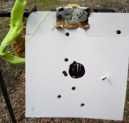

I just did a test . Kinda goofed it but you'll get the jist.
This is " good" uns and cull tin mixed .. 7 are cull tin . grouped in/at dot good'ens

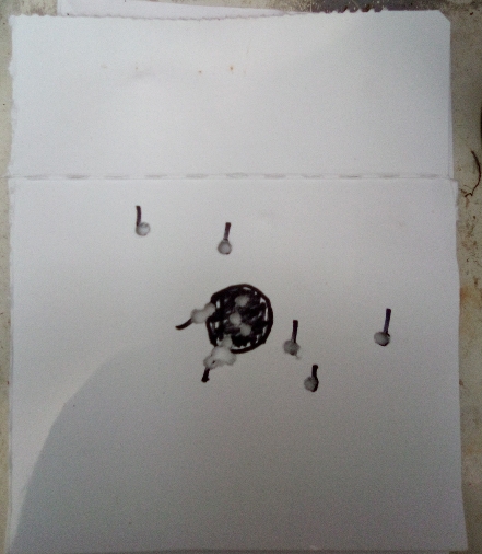

This is all cull tin pellets .
Lol... One popped my clip one did not even hit anything ( a true flyer).

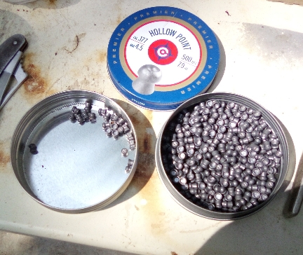

You can see why i do a cull tin. Dime dot @30y irons cphp.177
The smallest of a few random out of the cull tin was 4.32mm head size . With that only the skirt engaged any rifling ..lol.
