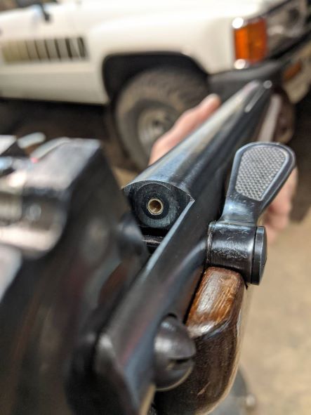

Out of curiosity how do you make the transfer port smaller? Weld it up and re drill? I was under the impression you could make them bigger but not smaller.
That's one way to do it, but probably the hardest way. I usually bore the port out much bigger, and then use a press fit bronze sleeve that's pressed in with the receiver/compression tube heated. Then redrill the port to your desired size. It's always worked for me.
Some guys drill and thread the port and use drilled out set screws to change port size. I don't like to do this because it's ugly, more work, and the length of the port (which is as important as size) is altered due to the length of the setscrew used.
