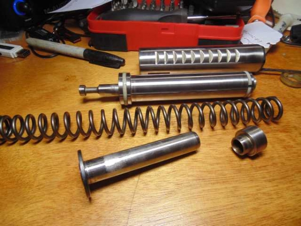

I have one of those older Mk II rifles also. It has a shorter 83-84mm stroke than the newer Mk III's that have 91mm stroke and is highly cherished. Due to age and neglect, mine had a totally shot main seal which is very common with standard AA seals. You can identify an OEM Mk II spring by its having 2 collapsed coils on one end. It also has a LONG steel tophat that can be replaced with one of delrin also.
FYI, Air Arms only changed to 91mm stroke when they introduced the Mk III to allow more than 12 Ft # to compete with Weihrauch in the US market.

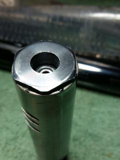

The Mk II has many evenly placed anti beartrap grooves on the compression tube where the Mk III only has 3 and the front 2 are close together and the third spaced a little further back..... Here's my MK II apart and a stock photo of a Mk III
Mk III

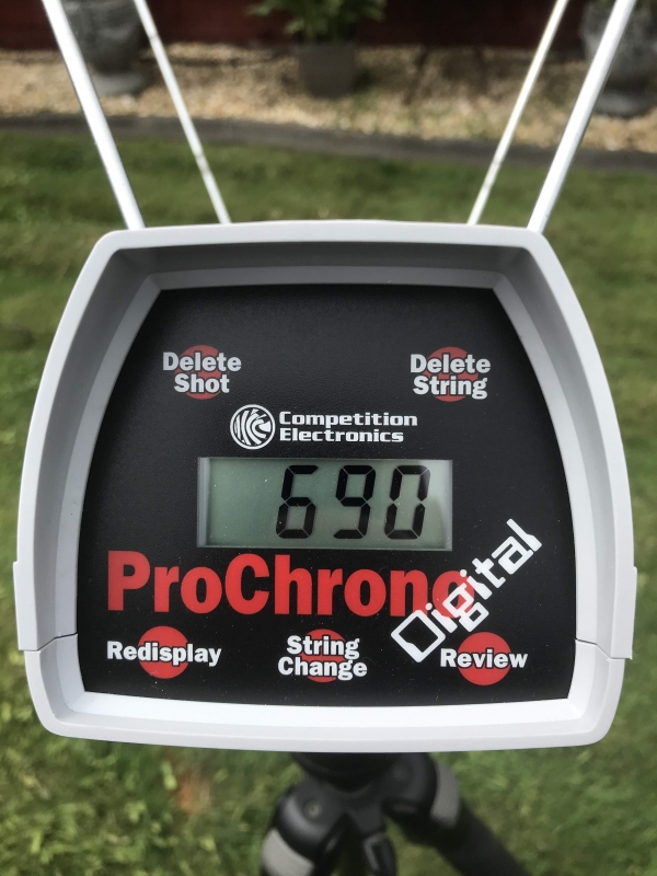

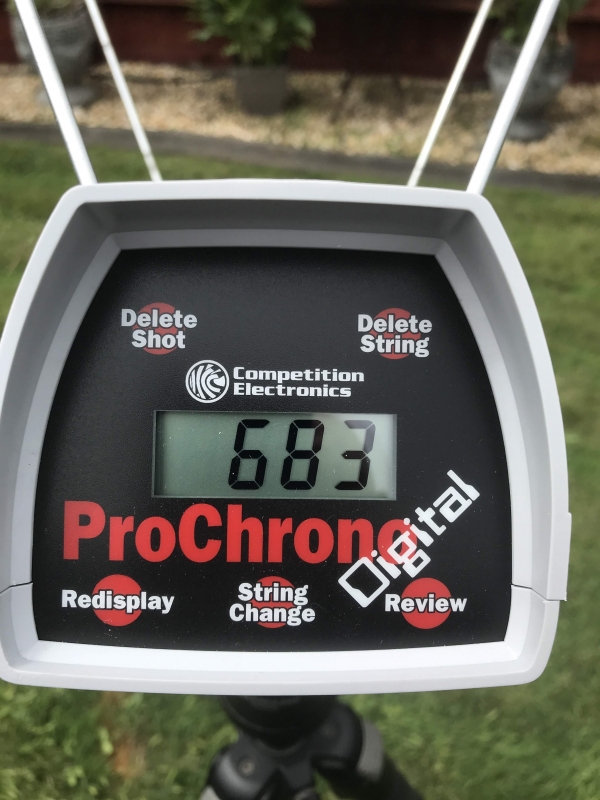

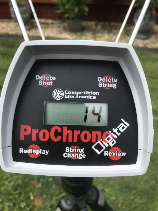

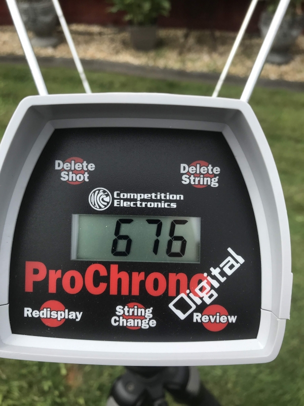

Okay, so I broke out the "lie detector" today.
Suspecting seals I conducted the tests with a fairly heavy pellet to provide some dampening.
https://imgur.com/lWslwNf
High
https://imgur.com/5yMhU58
Low
https://imgur.com/10DXeGI
Average
https://imgur.com/6k8g6Hh
Extreme Spread
https://imgur.com/ioLD2Sw
Standard Deviation
https://imgur.com/OyP6mh1
https://imgur.com/1Vpi0rP
With the 10.34's averaging 384 fps for 3.39 ft-lb.
Well THERE'S your problem!

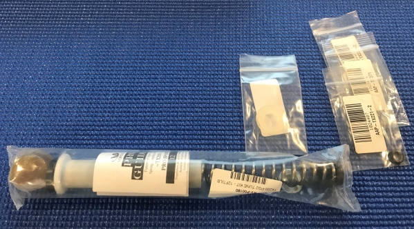

I have a 12 ft-lb Vortek kit, barrel seals and an additional new factory style piston seal.

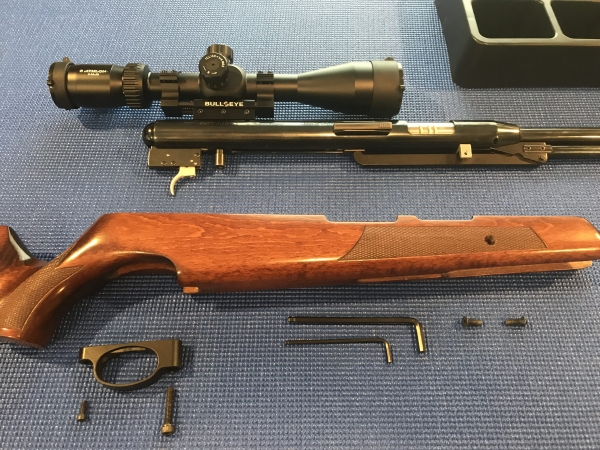

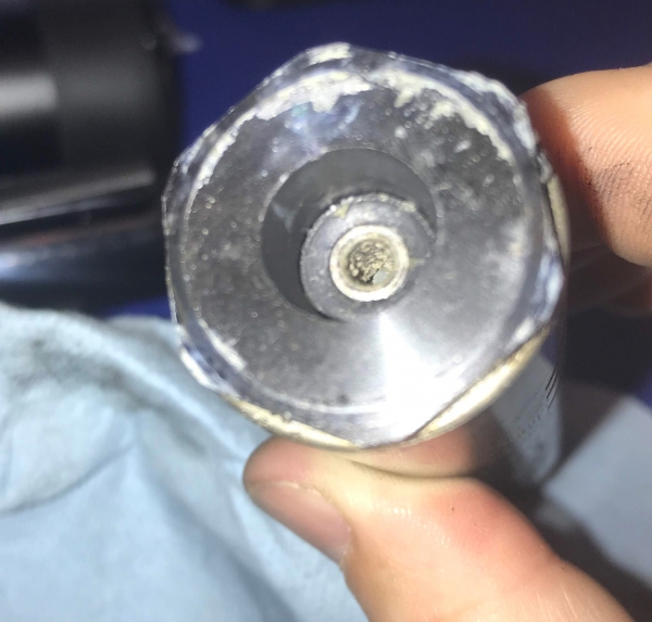

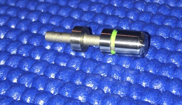

Got it disassembled today.
This ain't right.

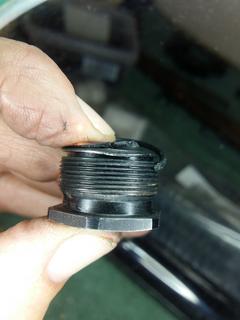

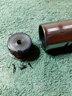

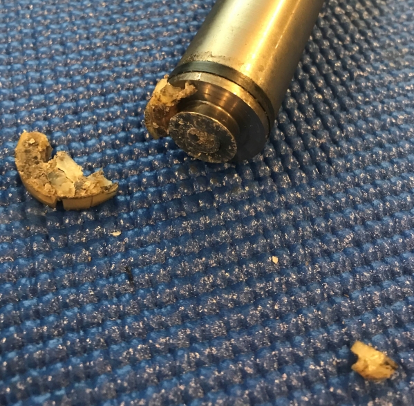

Debris in the chamber.
Center tube broken off from the base washer.

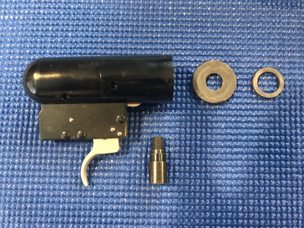

Out with the old, in with the new.
Polished the compression tube while I had it out and radiused the safety button.

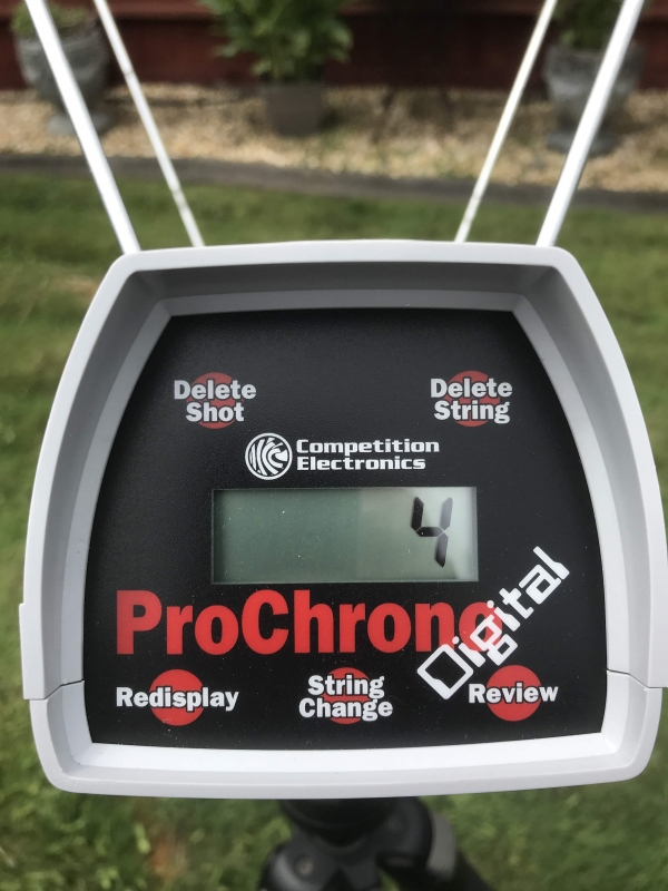

New numbers.
High
Low
Average
Extreme Spread
Standard Deviation
That's more like it!
10.71 ft-lb with none of the washers added.
Also happy to report accuracy has returned!!
