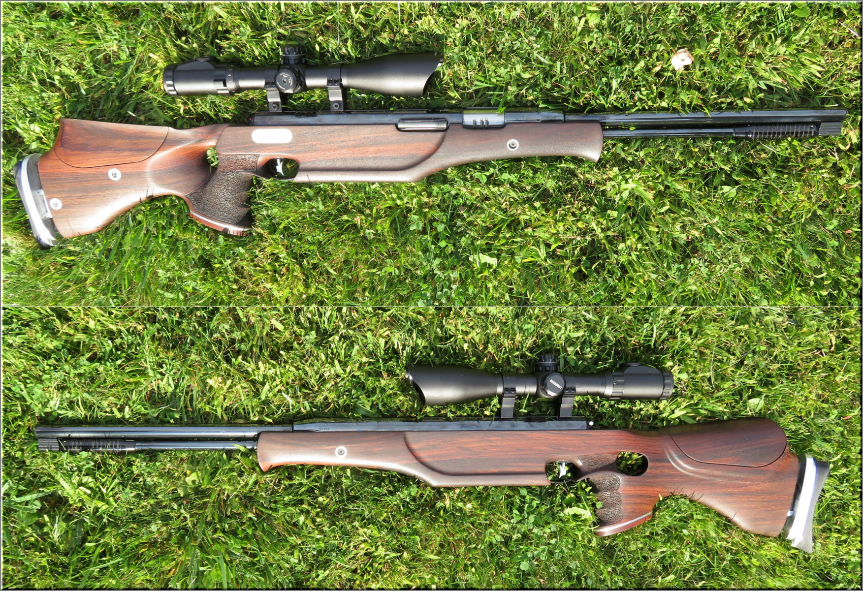

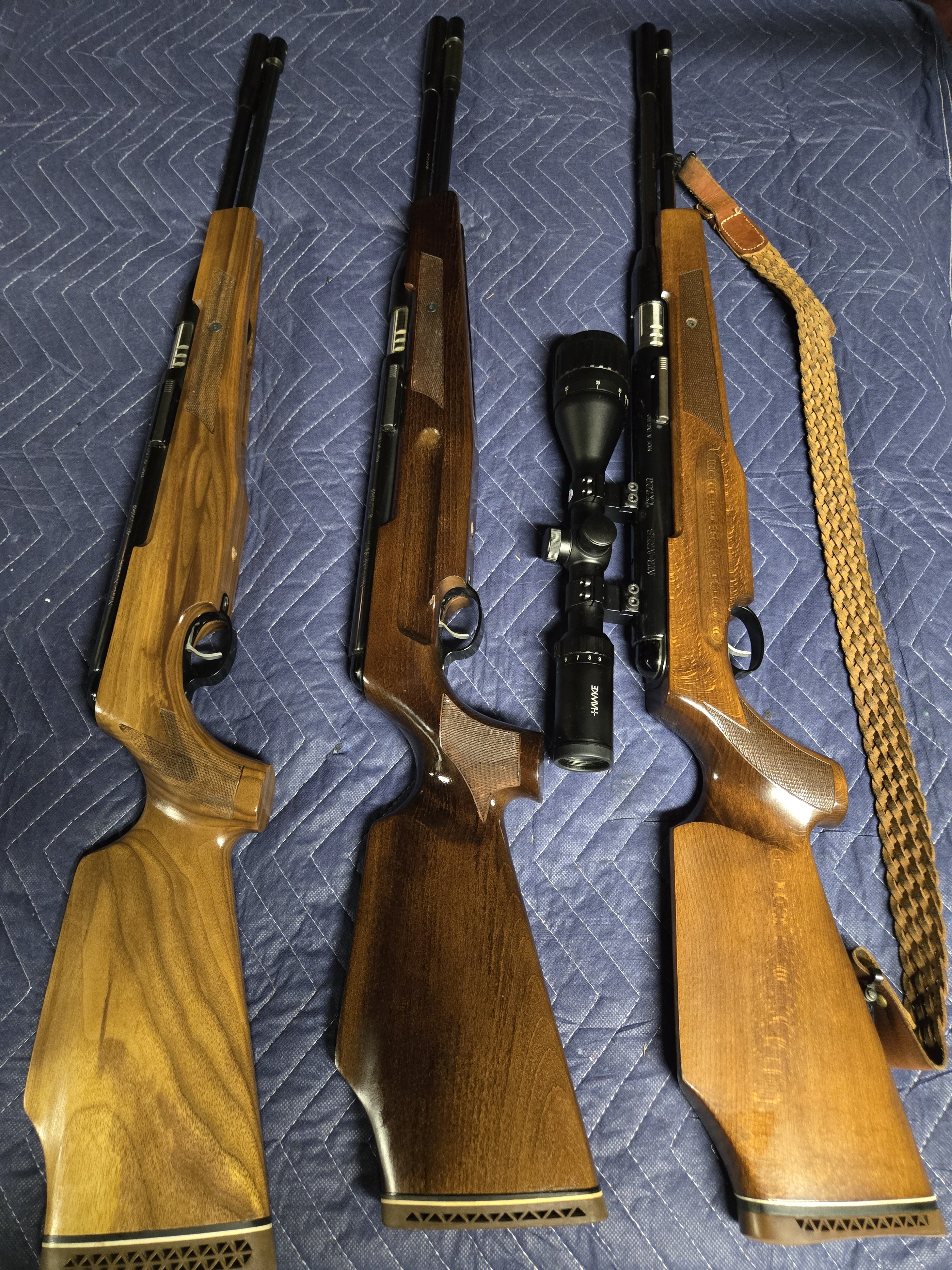

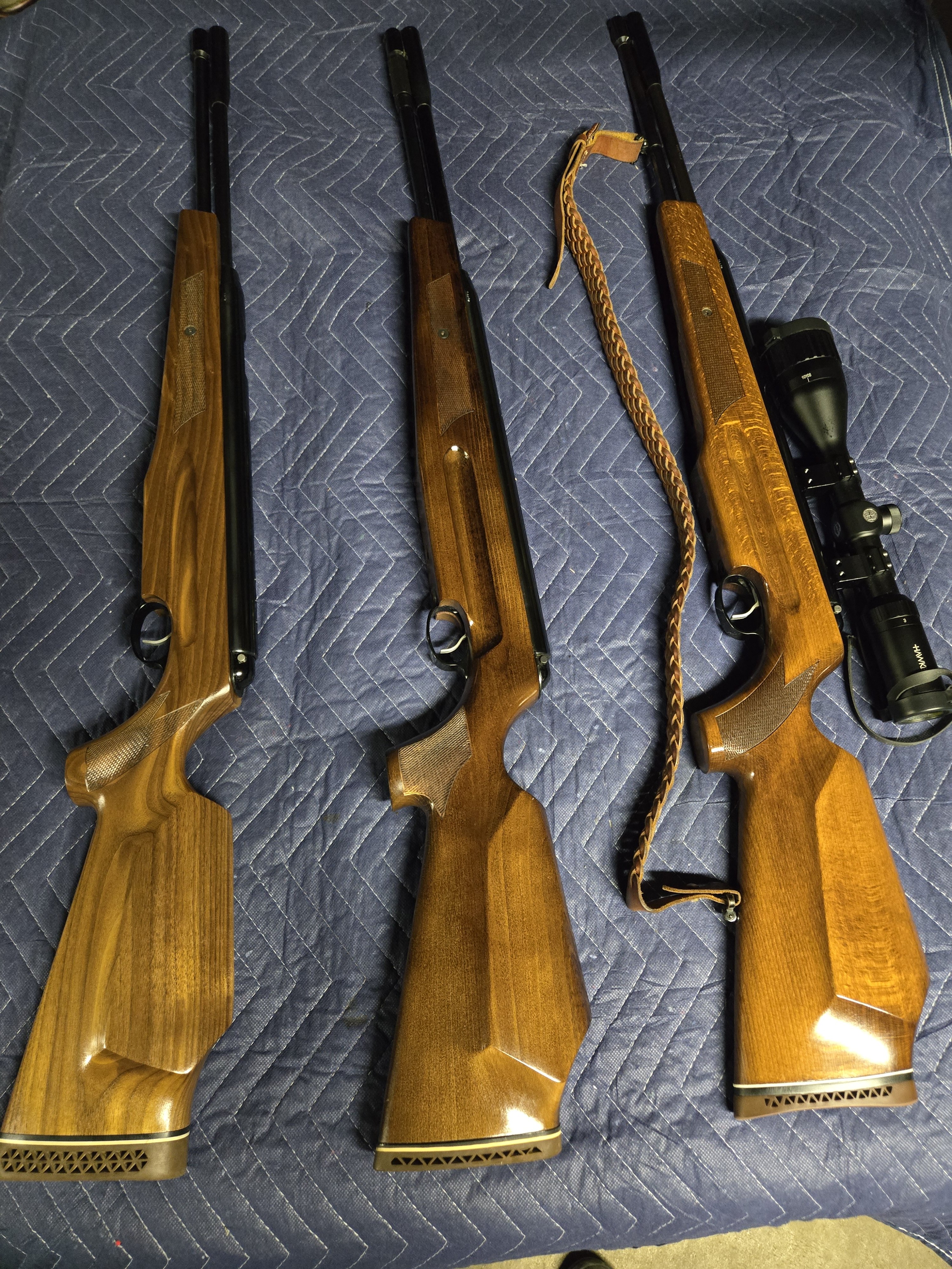

The 2 pictures are rifles from my collection. Enjoy!
