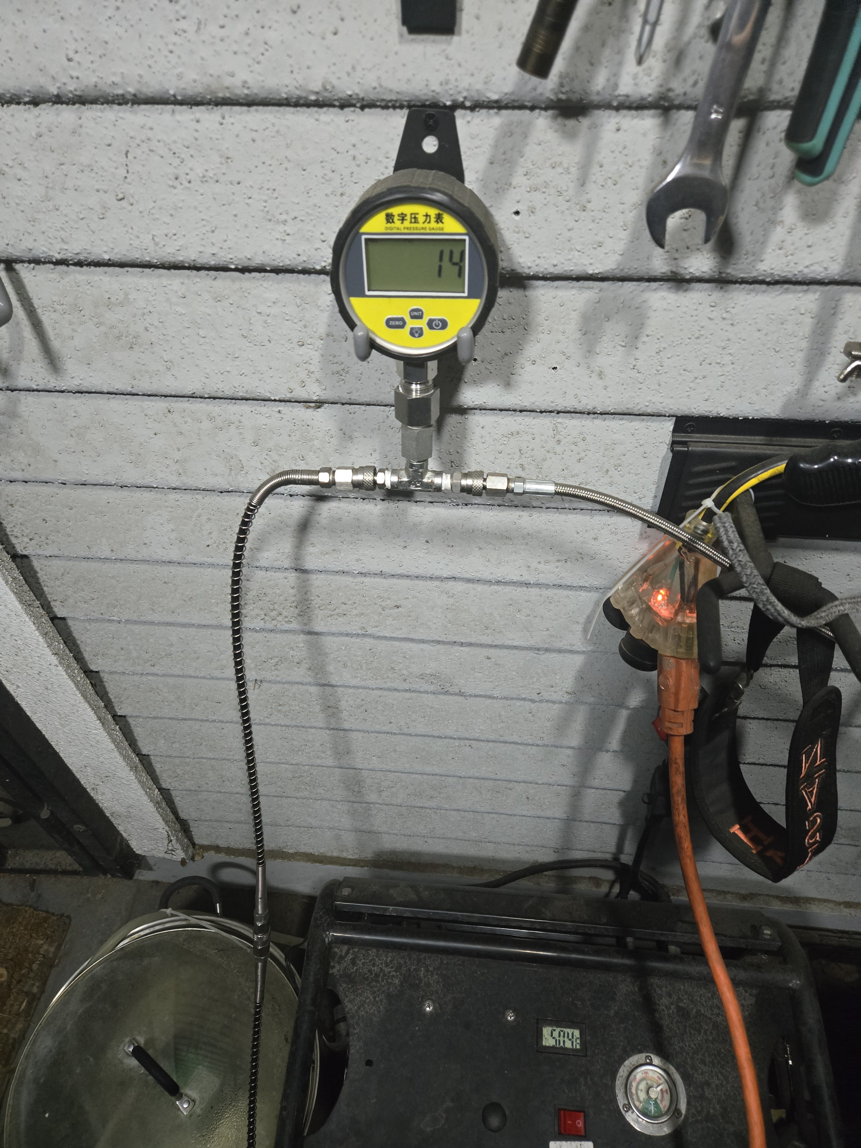

I think the difference is the 042 has automatic shut off. Not required but I like not having to watch it fill.
I also put a large gauge inline.
I'm pretty sure I have all the parts for at least one more using an analog guage.

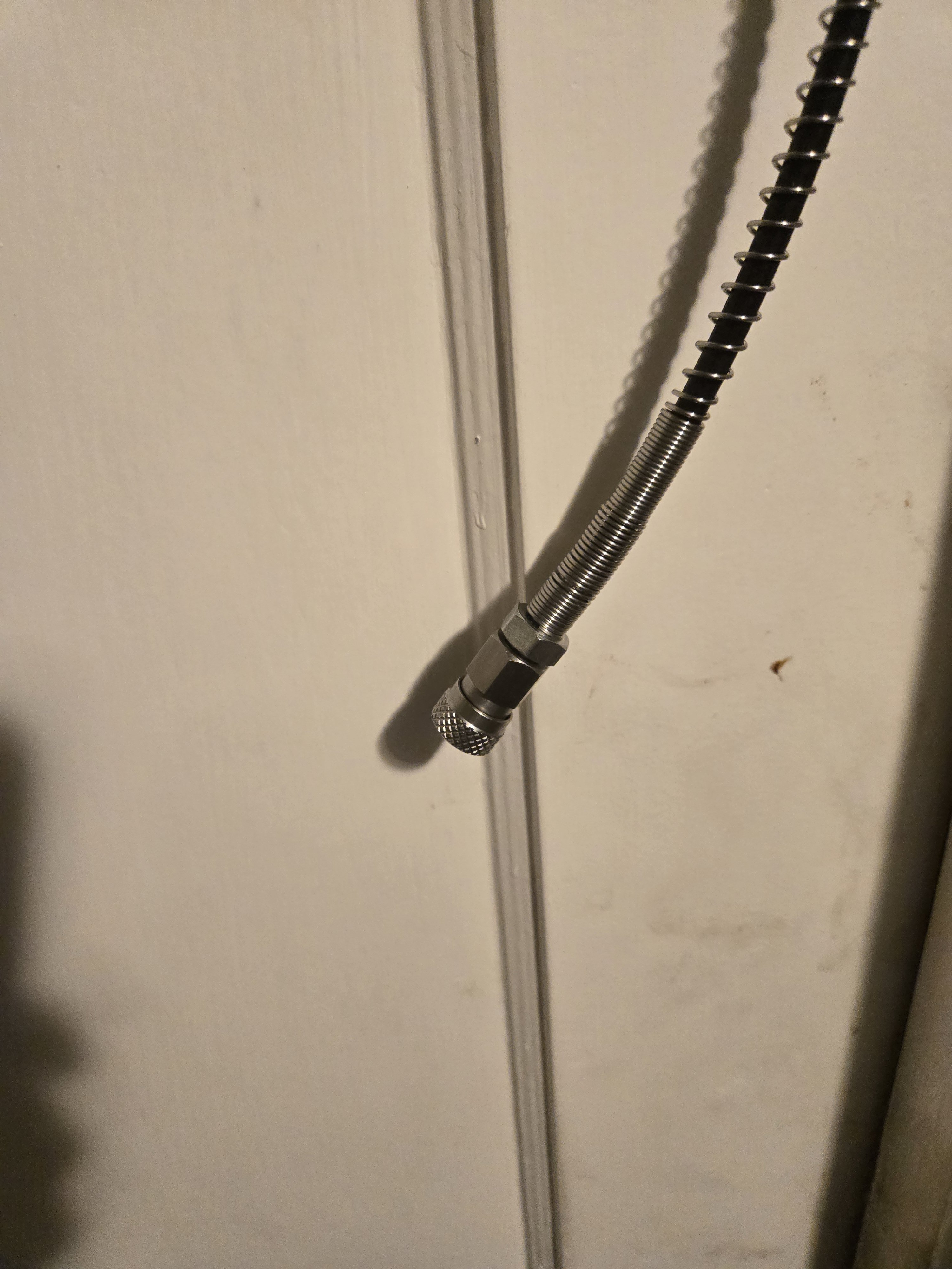

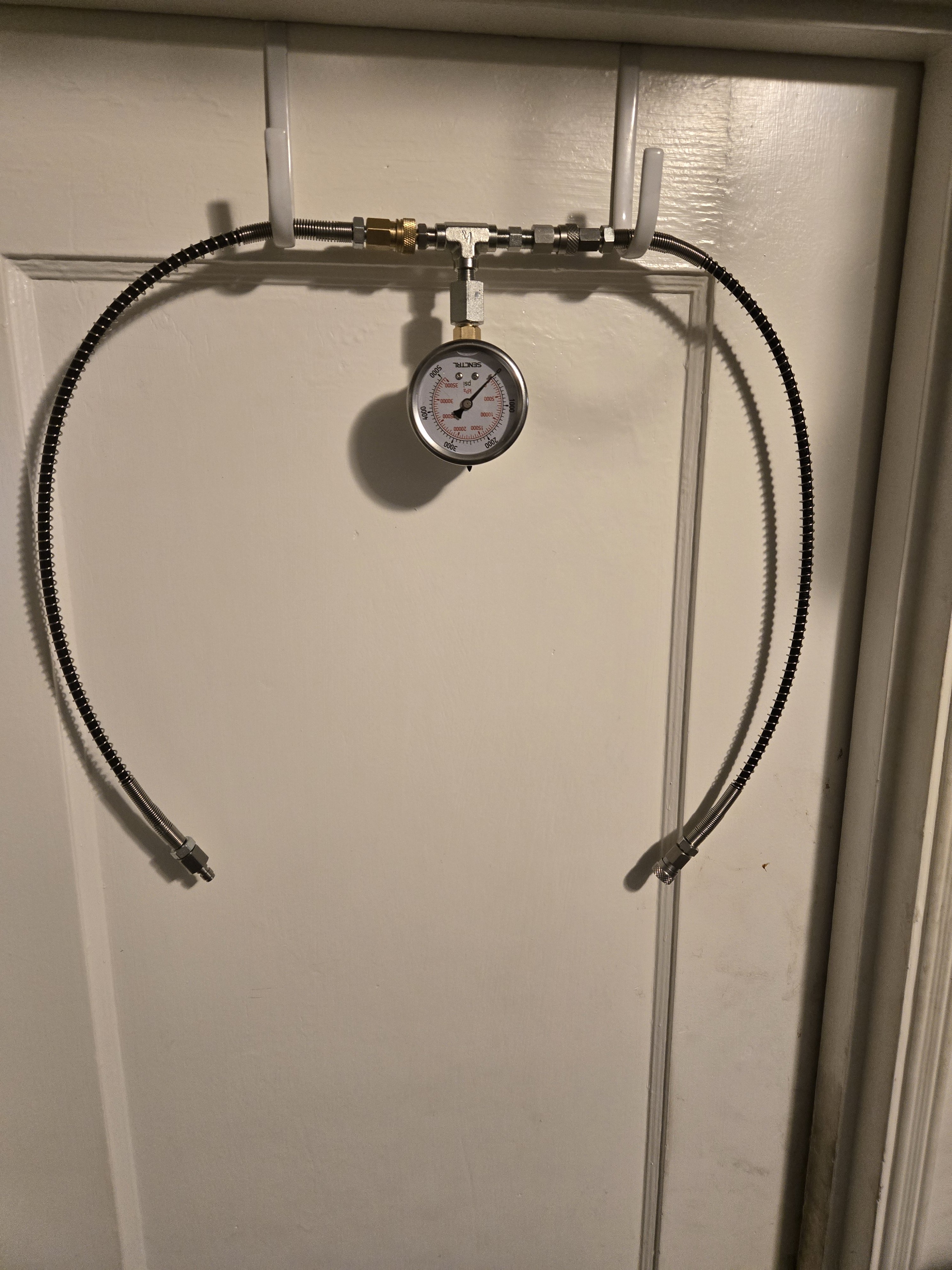

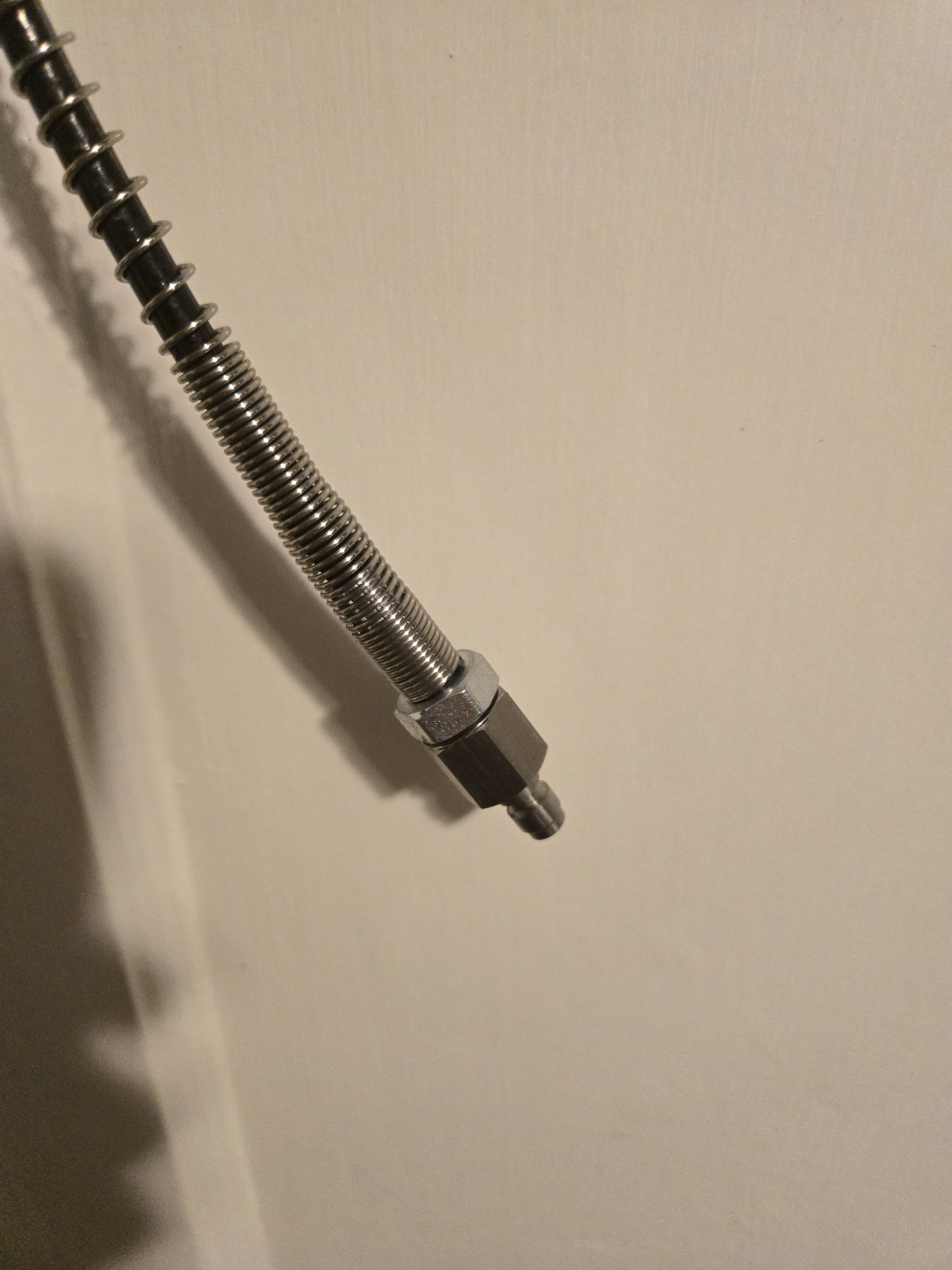

Yeah, my parts bins have everything for an inline large gauge. You would need to tape and seal the connections. Everything is NPT but the ends are quick disconnect. You just plug the pump outlet hose in one end (has male QD) and connect the other to whatever you are filling (has female QD). I mounted mine to the wall.

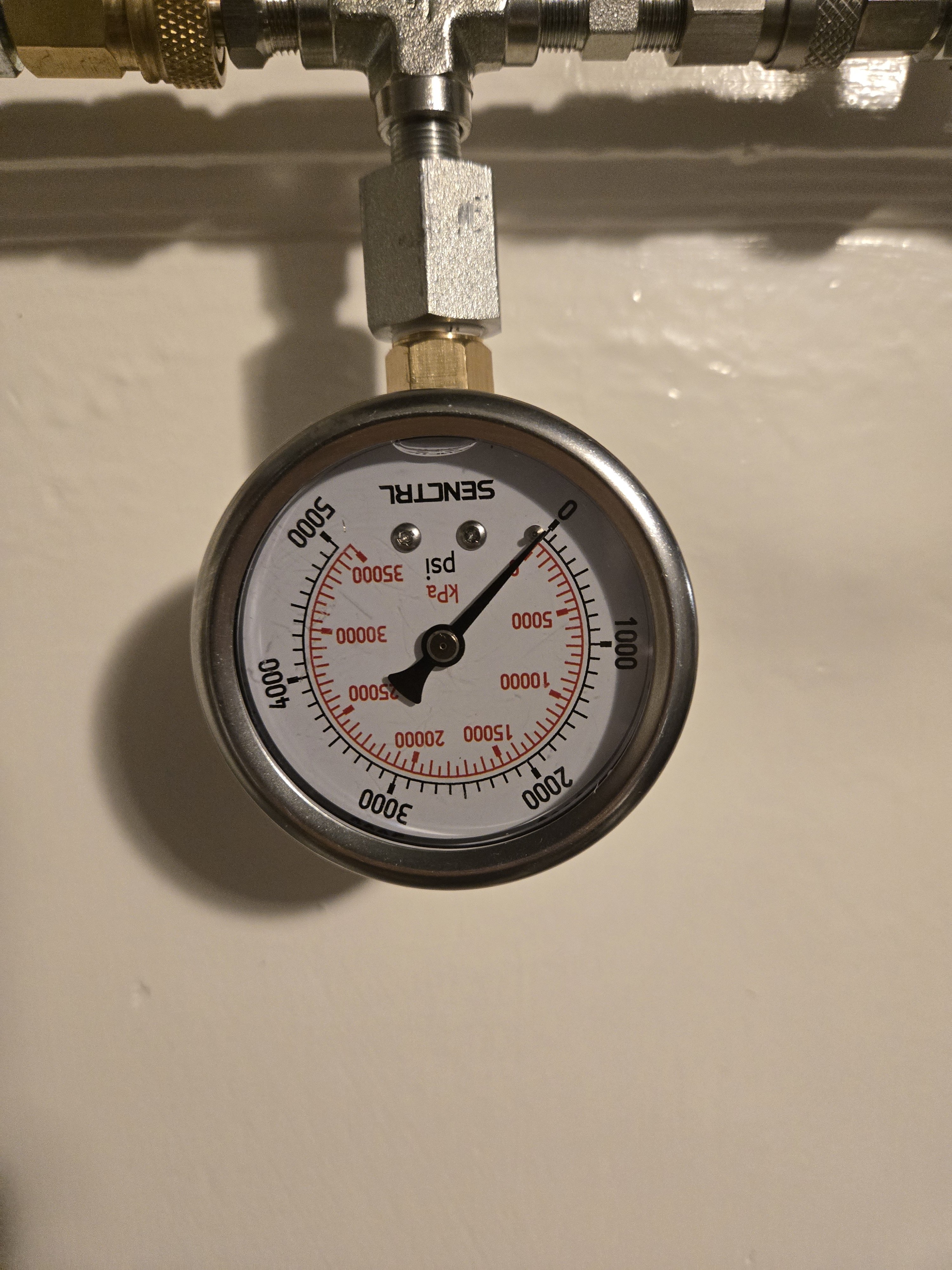

I can't read the gauge on the pump when it is running so I added one i could read that wasn't vibrating. MUCH BETTER.
