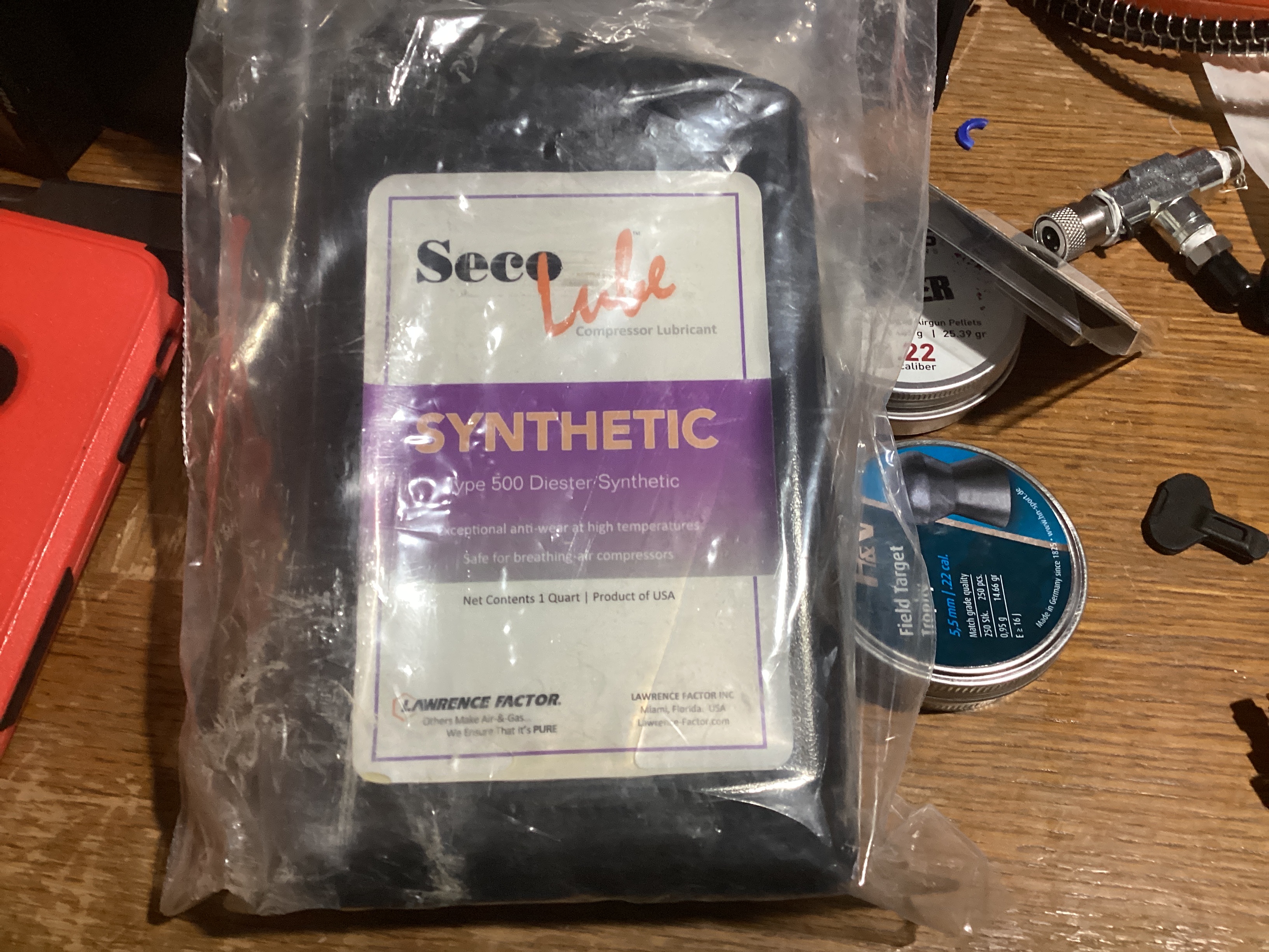

I think it was around $25 a quart, and they really nailed me on shipping. But it’s enough for 2 fills

@OldVet, you need a non detergent synthetic compressor oil made specifically for high pressure compressors. Most motor oils have detergent additives to suspend contaminants which are removed by an oil filter. Air compressors don't have combustion so detergents which don't allow contaminants to settle in the crankcase are counterproductive. Filtertechs.com sells SecoLube oil but there are other brands such as Anderol, Bauer, Coltri, and several others. Don't buy compressor oils made for low pressure shop compressors. Shop compressor oil is not much better than motor oil in a high pressure compressor. Some Chinese owner manuals recommend #46 hydraulic fluid. That is another lubricant to avoid if you want your compressor to last.

@OldVet, you need a non detergent synthetic compressor oil made specifically for high pressure compressors. Most motor oils have detergent additives to suspend contaminants which get removed in an oil filter. Air compressors don't produce combustion contaminants so detergents are detrimental to their longevity. Filtertechs.com sells SecoLube oil but their are other brands such as Anderol 755, Bauer 0024, Coltri 755, etc. Don't buy air compressor oils made for low pressure shop compressors. Shop compressor oil is not much better than motor oil in a high pressure compressor. Some Chinese owner manuals recommend #46 hydraulic fluid. That is another lubricant to avoid if you want your compressor to last.

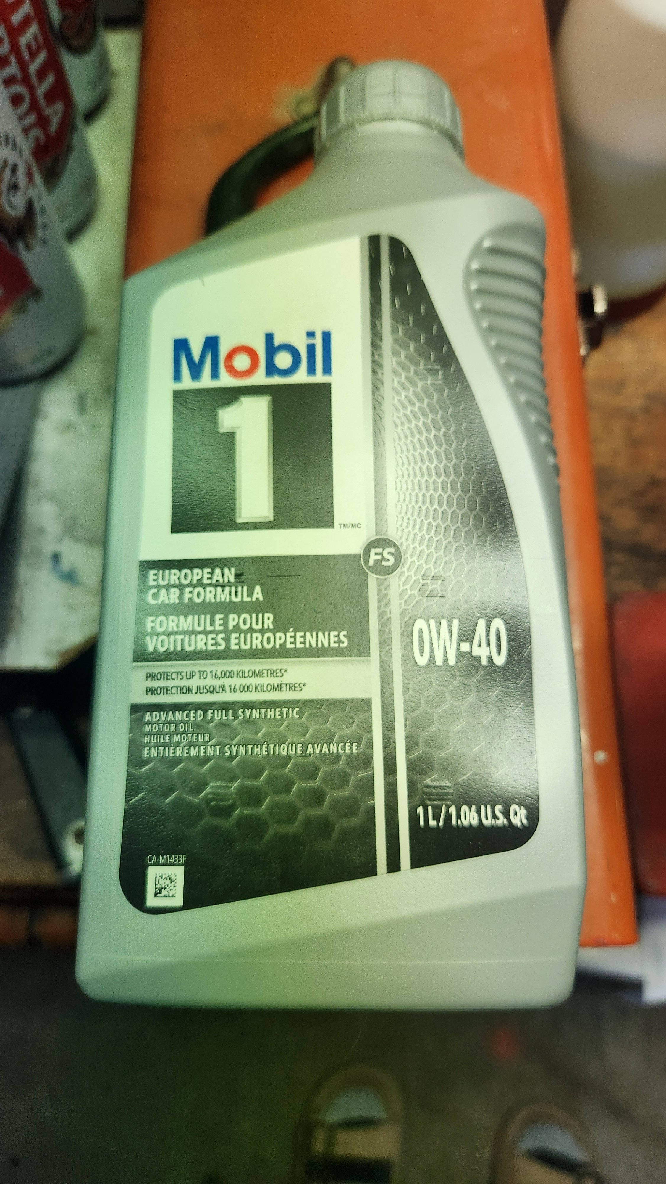

In addition motor oils are made to be pressure fed by a oil pump through babbitt bearings or some sort of pressure lubrication, while the majority of all compressors that we use are just, splash lubrication. So the importance of having proper oil for the right application can be critical in the longevity of your compressor.
Allen
Because it has detergents to wash out the bearings and keep them suspended in the oil. Normally you would have a filter in a turboed engine to filter those contaminants out. In a cheap compressor there isn't one so those contaminants may as well be sand. In a non-detergent oil the contaminants do not stay suspended.
Allen

I'm just curious have you been useing this brand for many years in your compressors.?
I have about 67 hrs on my YH.
Using this twin turbo oil since last spring, that is about 5-6 hrs run time.
I am refilling 2 large 14L scba tanks usually from 200 to 300 bars, that work party takes several hours with cooling down.
