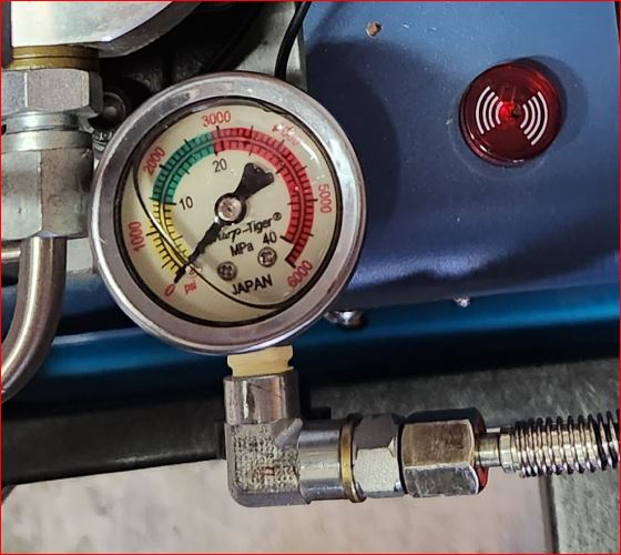

Not a tuxing but a YH, first time the auto shot off started making me psycho I replaced the gauge (and wires) to a manual gauge - and better quality.

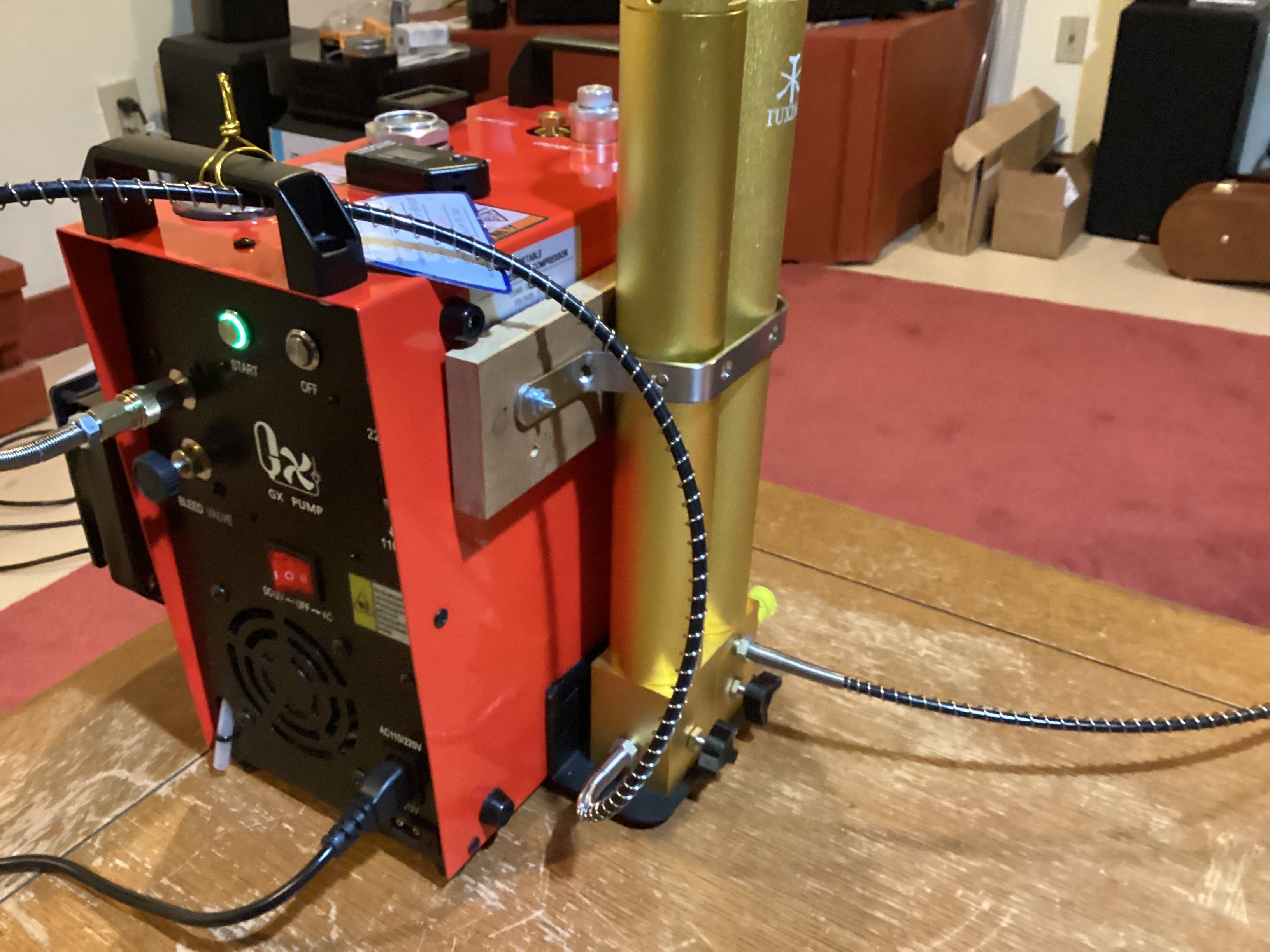

easily tested, plug just air hose , Record time to shut off.
Add in the tall golds , plug air hose , Recorder time
yes it takes my Gx around 20 minutes just to fill this crowded volume. The media inside is not dense.
The Gx is slow and cool but it shows the work being done before getting to your air tank.
With my Tuxing twin this also happens but at a much faster pace.
