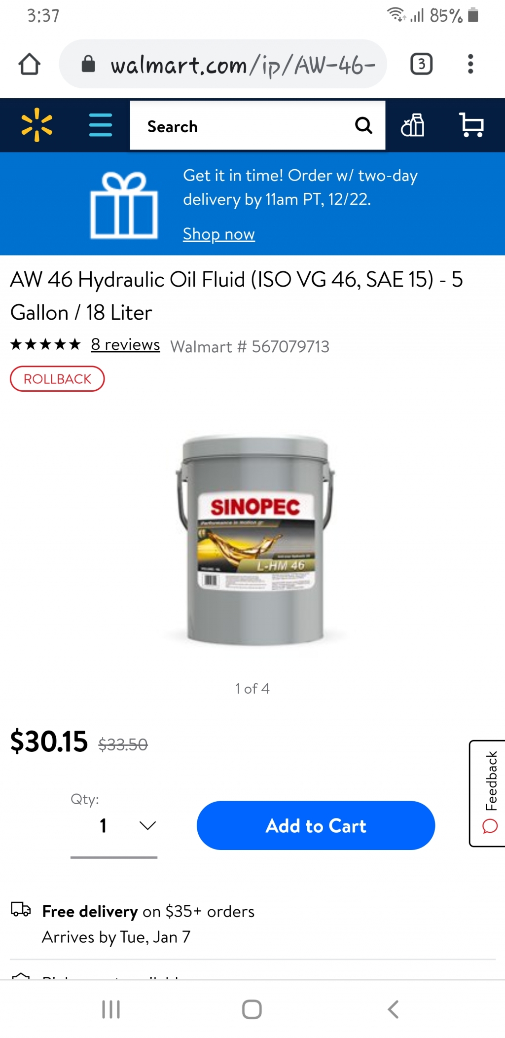

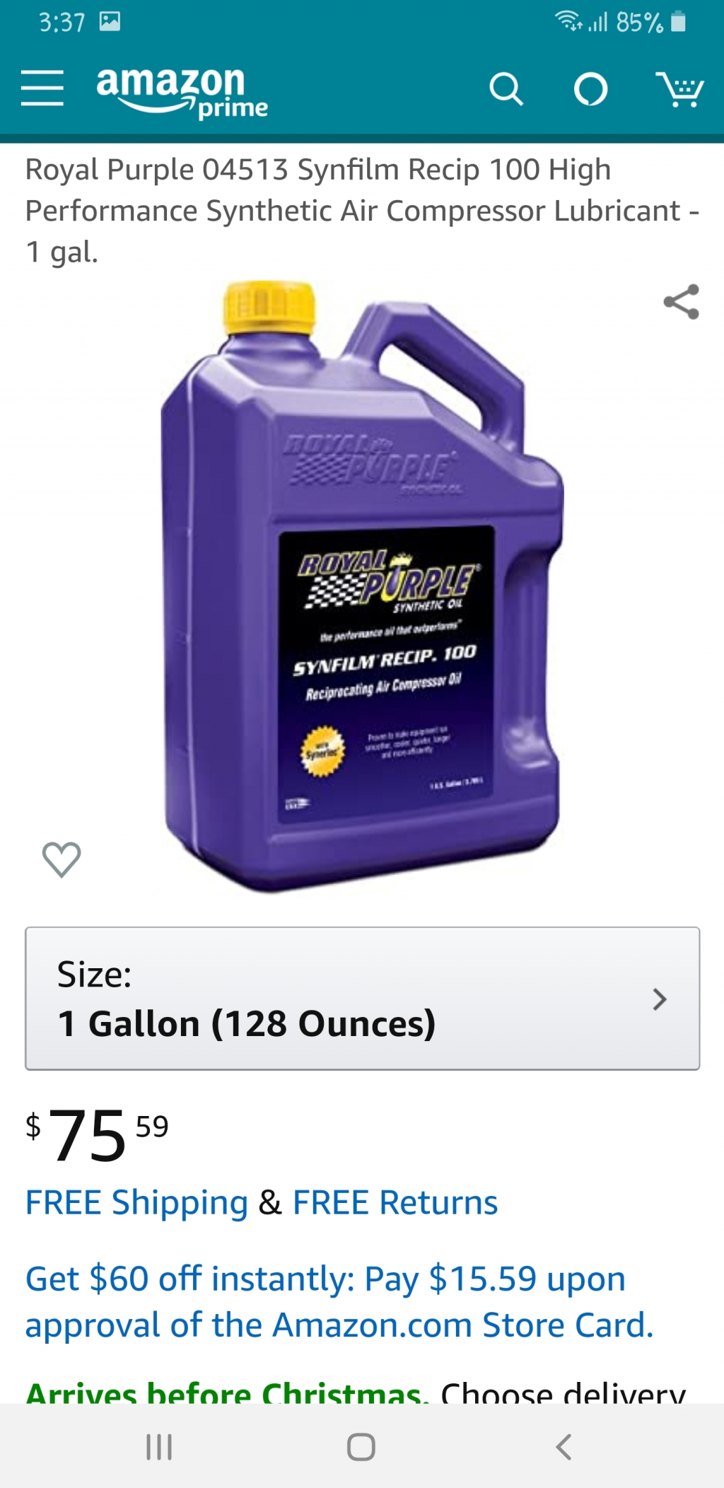

I own a yong heng and manual says to use hydraulic oil 46. I found 5 gallon bucket for about $30. But I seen people say dont use hydraulic oil. They said to use the royal purple. I found 1 gallon for $75. Wth...$75 for 1 gallon?? Really? So to get 5 gallon of royal purple is $375. Smh. The other which the manufacturers recommend is $30 for 5 gallons. Which oil to get? Is it really worth over 10 times the cost to get royal purple? Or it doesnt matter which oil I get.
