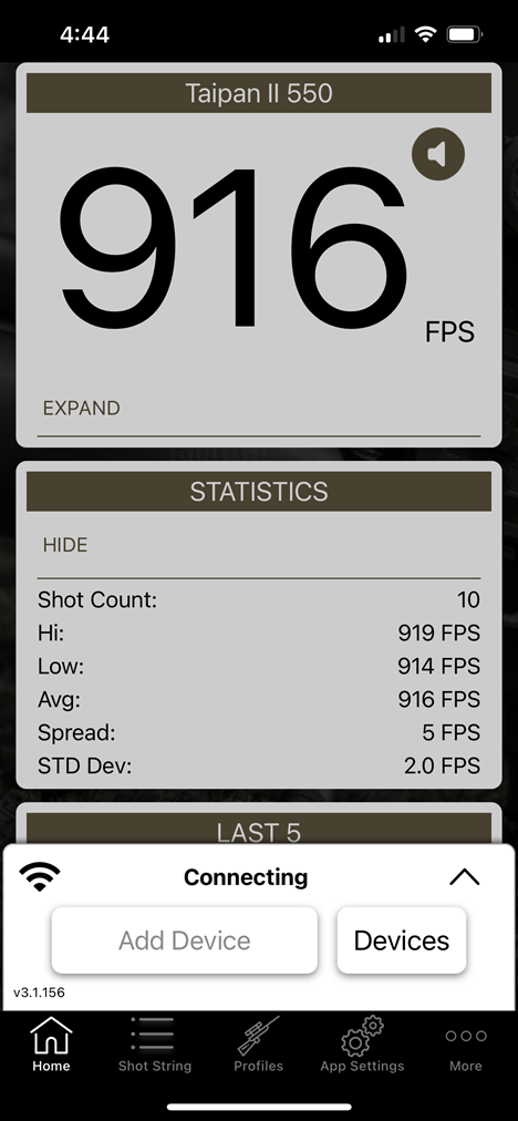

The T2 is a real solid gun. Only one I like better is the Epic 2. But it's a longer gun with same barrel length and about 4-5 hundred more. Taipan will do what they do, and they do it well.The ES on 16 shots starting at 200bar was 6fps! I assume it’ll settle. LOL.
Looks like I’ll get 40 shots from 260-180bar, at 54fpe.

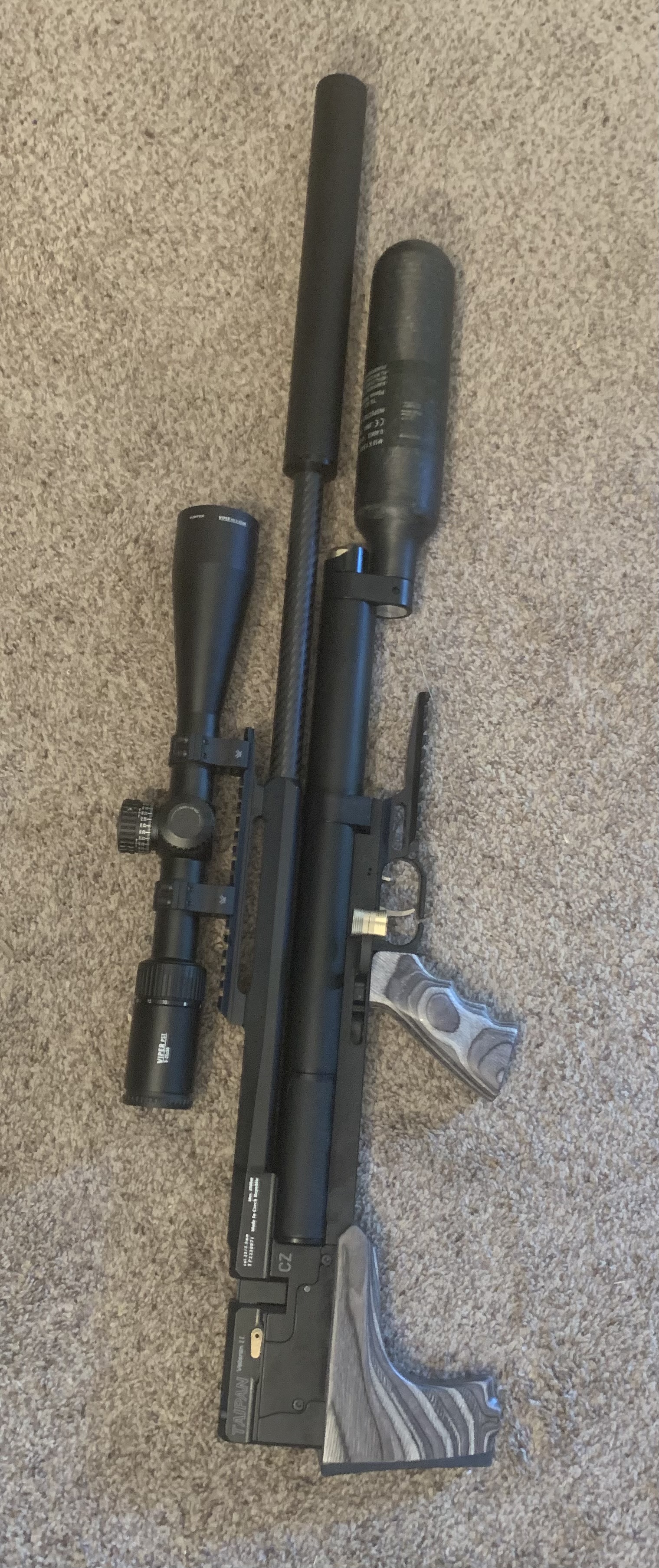

You know, I am not sure. It is held by 2 bolts, one under the front of the trigger guard and another inside the grip. If the Mutant is using the same wood stock as the Veterans, then it should fit properly.Wondering if a Mutant standard would drop in that chassis stock. I really like the look.

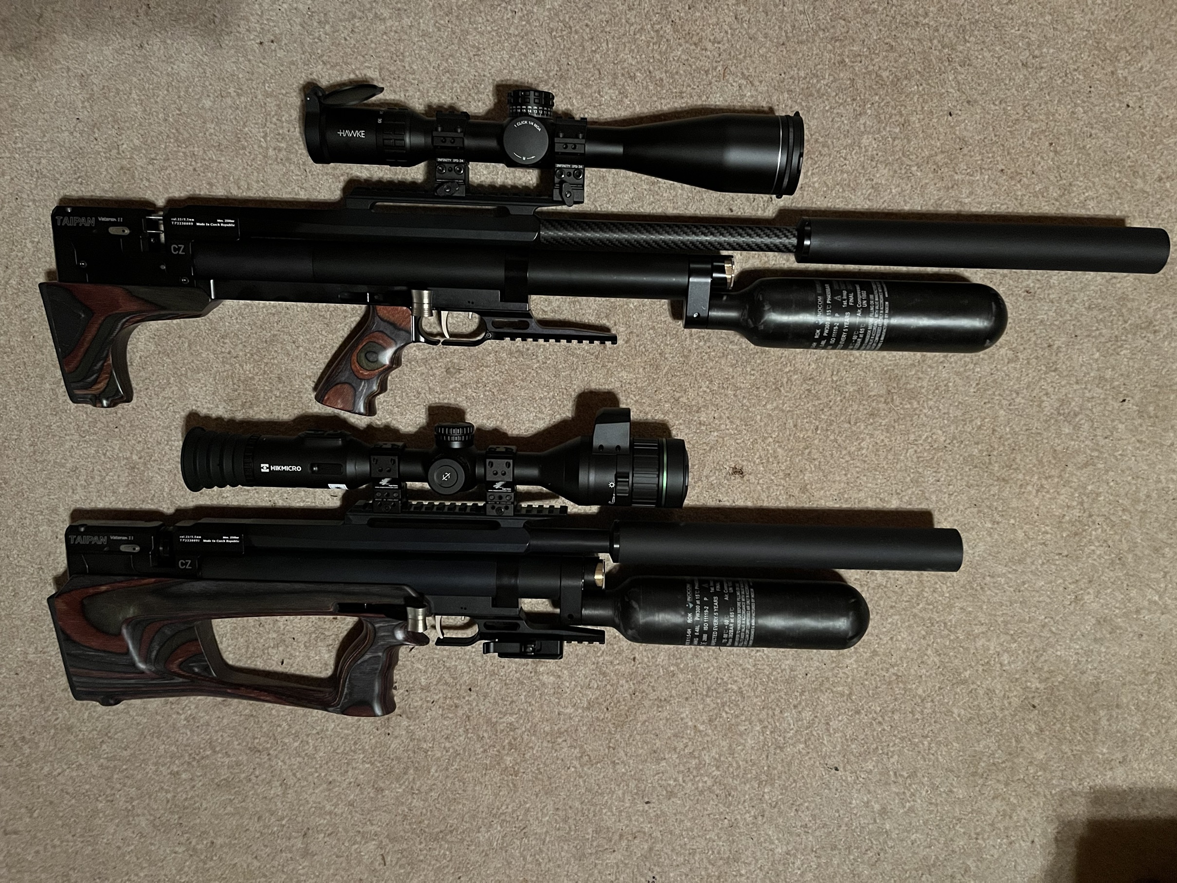

Good looking pairI have a good mix of guns, but these always are at the top of the list for performance and always working well. Both do pellets and slugs well and they are both .22. @weevil - keep shooting it. The more you shoot, the better it gets!
the Taipan is Beautiful in an Ugly kind of way, kind of like an A-10 Wart hog (Thunderbolt ll)![]()

Absolutely NOT ugly !!!
