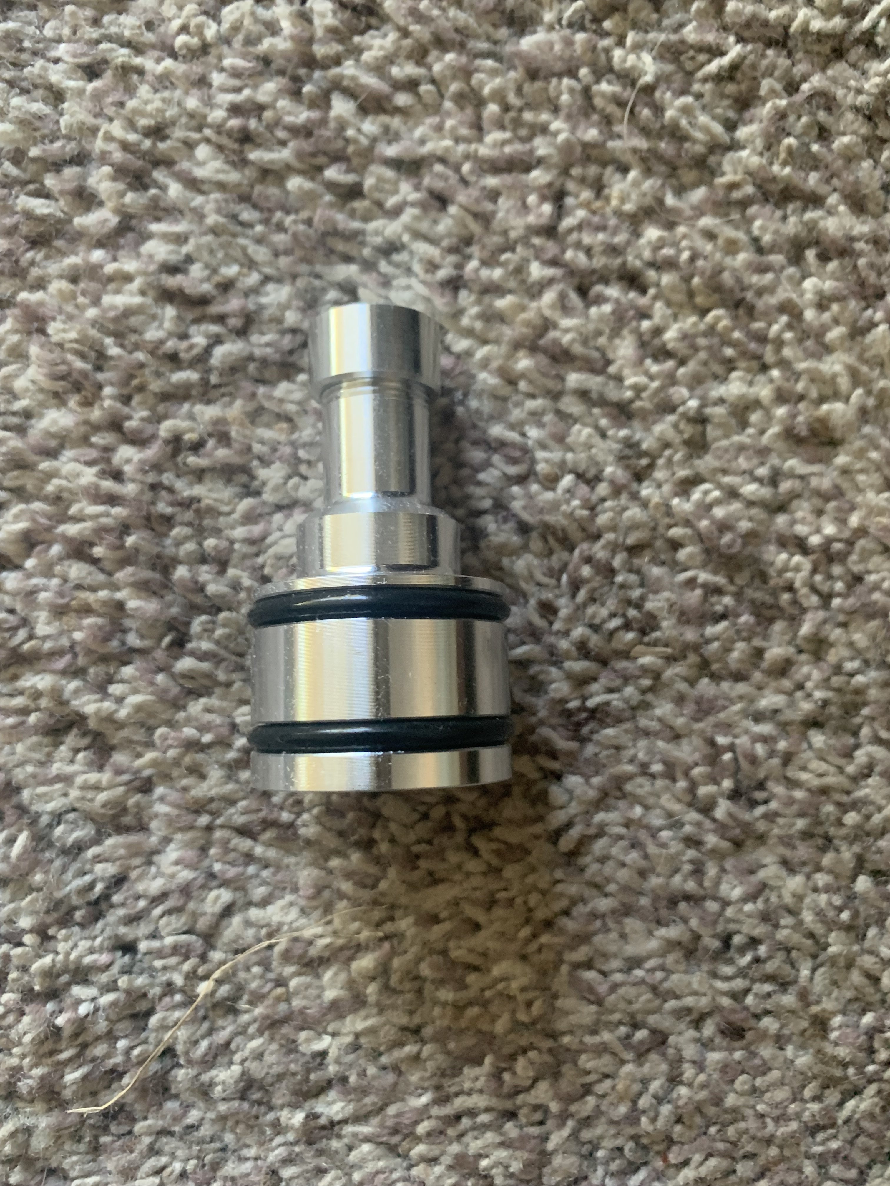

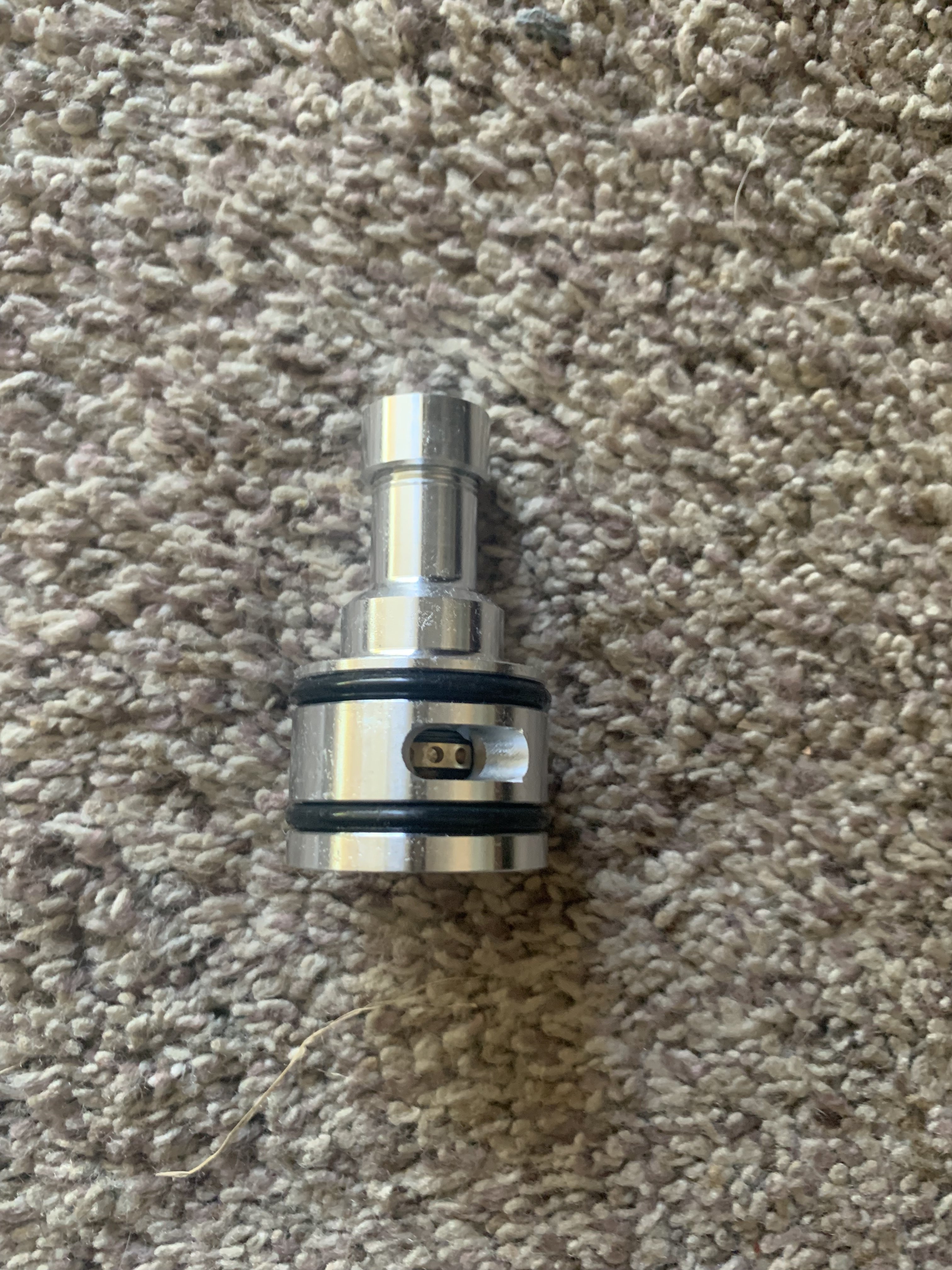

Looks to be the same regulator design as OG Veteran.
The length of that plenum spacer could maybe be fiddled with a bit, but it spaces the regulator in the tube in the correct location for the vent hole, so a different sized spacer of too much/too little and I think you'd get into trouble.
One of the sets of pins also fits the valve, again, assuming they're using the same valving as first gen Vets (and they probably are, since so many of the other parts are the same from Vet 1 to Vet 2.
Don't remember which of my Vets this valve came from, but red marker is there for 125bar. Thinking maybe it was the .22 Long.
And the pins for the valve...
