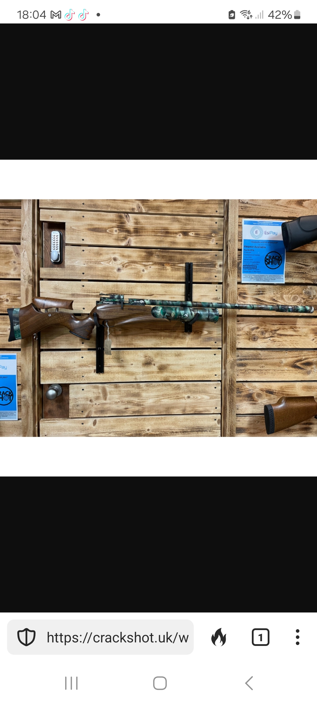

It's a Daystate redwolf in walnut stock.
As another reply has said...why was it painted in the first place? I don't know the history of the rifle as its come through a dealer but it's definitely a brush job as its not a smooth finish

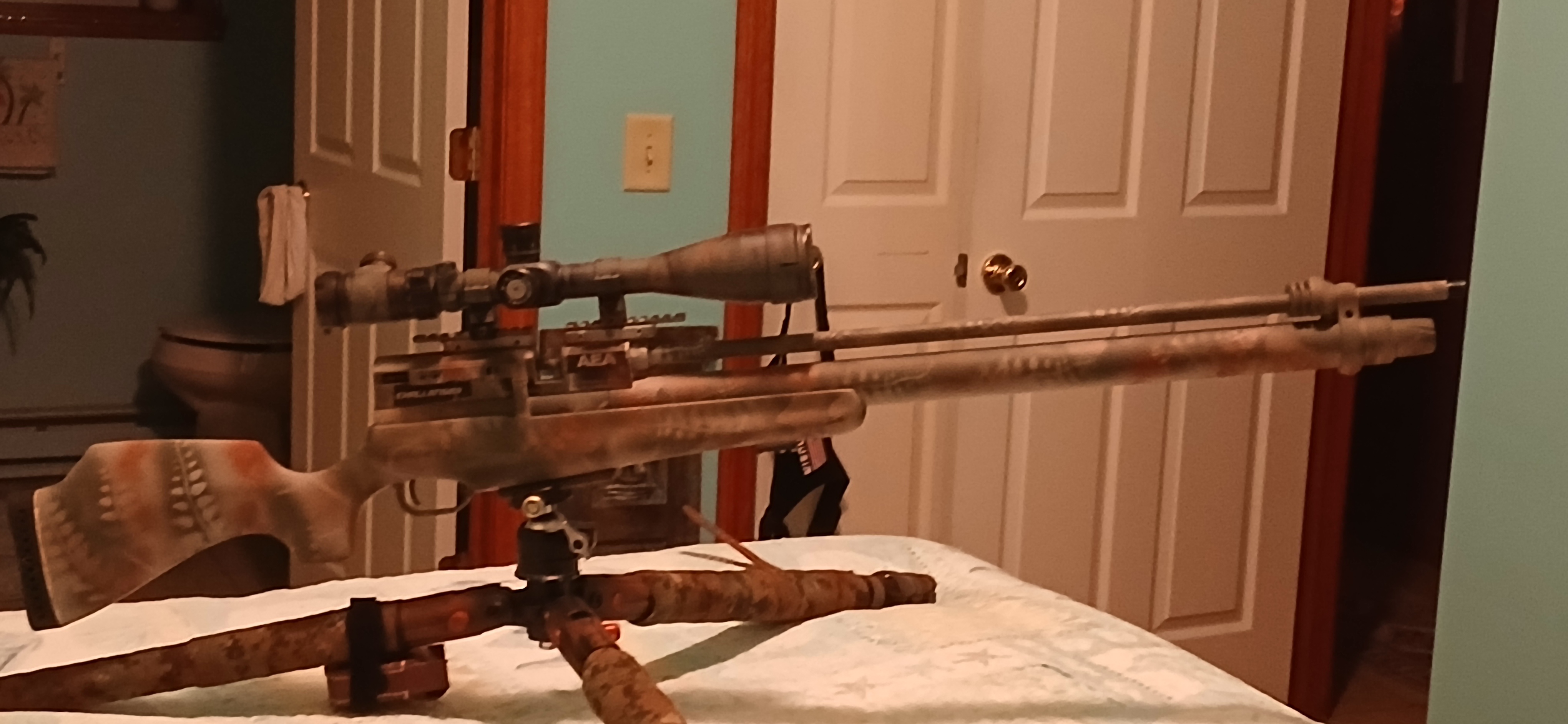

I may be, but why not determine the type of paint used and then find a suitable primer to seal it before proceeding? As a hunter, I wanted my PCP to blend in with the vegetation I hunt in. If you really need to remove the paint, exercise caution. If you decide to repaint, ensure you tape off the parts that should not have paint on them, such as gauges, etc. I repainted over the factory paint.
Who in their right mind would brush paint a Daystate Red Wolf, please post some pictures of it painted before you start working on it.
I know right!
I did some research today as to why? The previous owner was for the most part a crow shooter. The birds apparently would shy at the shine on the gun. He remedied this by toshing it over. I get his idea but I would have hydro transferred camo onto it. I will post some lovely pics.

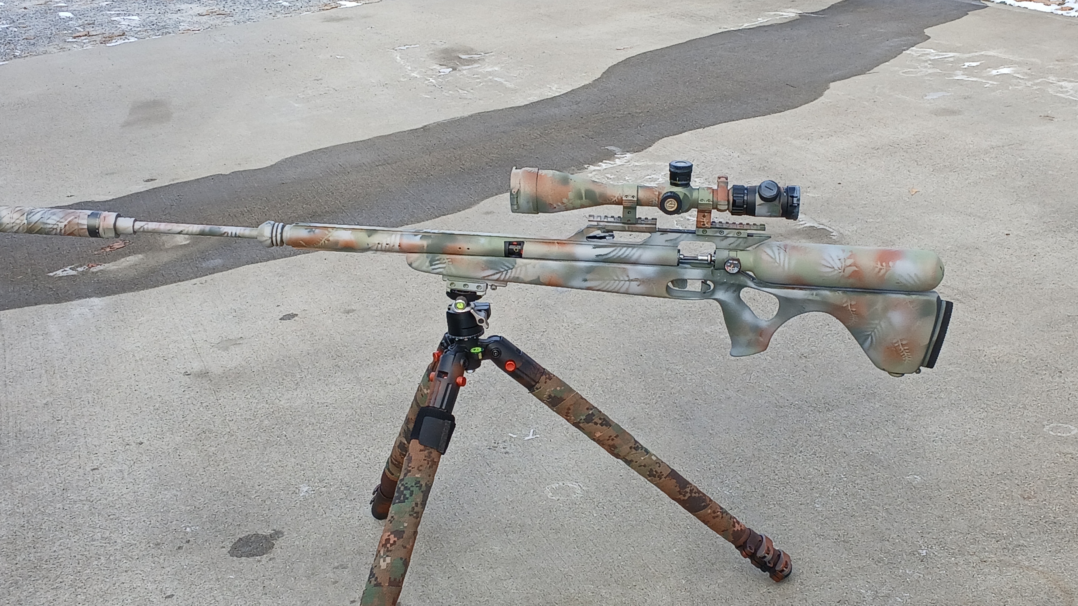

I don't do much hunting anymore, but I used to do a lot of it. Back then I had a few guns that were spray painted woodland colors in random blotches. The idea of it was both to camouflage the guns and to give them a protective finish, but not to make them look good. Here in the Pacific Northwest it rains most of the time during hunting seasons, so these were guns that were going to be getting wet and getting banged around. I wouldn't do that to a Daystate, but I might do it to something like a Cometa or an Air Venturi. It looked really ugly, but it was really practical. Any time the finish got too scratched up I'd just give it a couple more squirts of paint.
