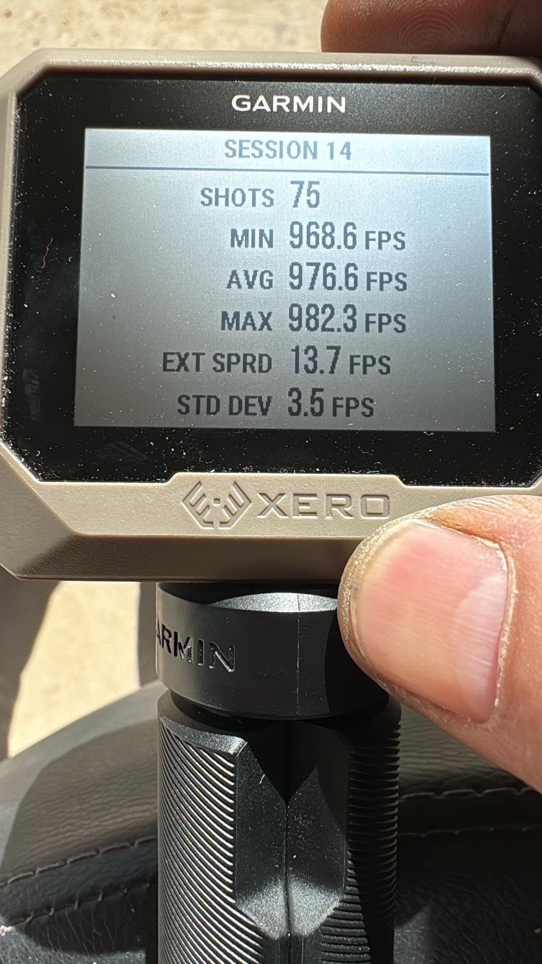

Ha, Cole was my squad mate last month and he saw how my phone got hot and my app wouldn't work so I had to restart my phone and it worked again which is a negative to using a app.
Could still print out different charts for the different velocities but I haven't - yet.
