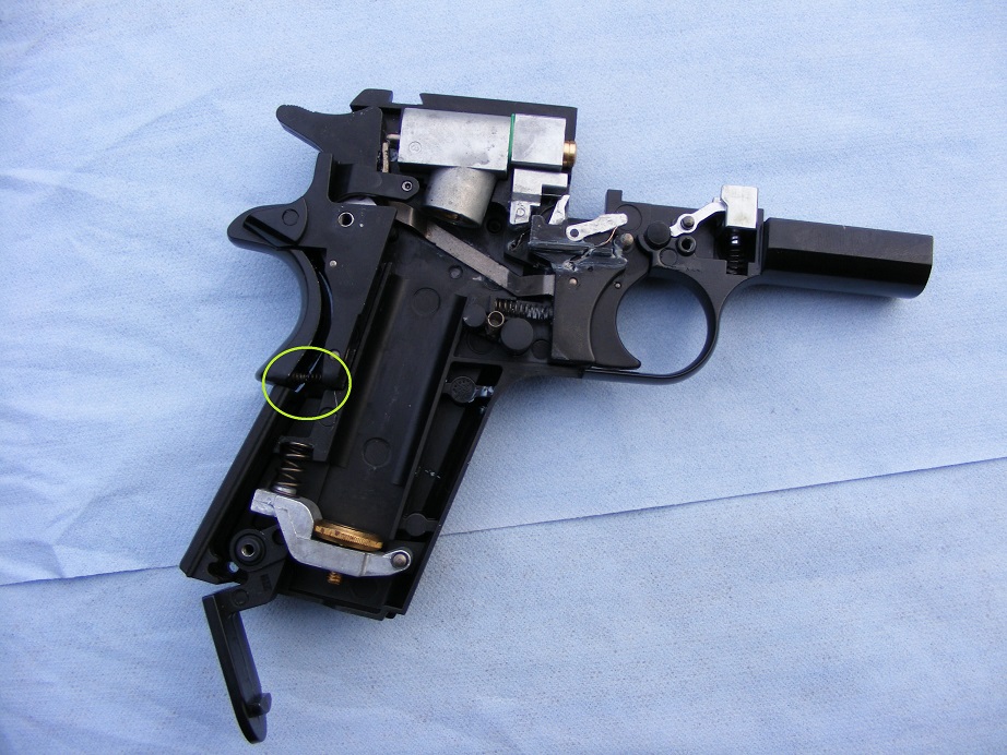

as for the spring heres a pic i found of its location,
looks like you could either shorten it,or possibly use a bic lighter spring as a replacement

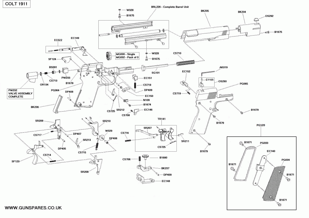

Here is a diagram of the pistol:
Part CS714 is going to be the grip safety spring. I’m not aware of specific aftermarket springs (or parts in general) for these guns, but you could measure this spring and try to find a generic replacement. You could chop off a coil but then it would be better to sand and flatten the new spring end if you don’t want it scratching the grip or frame. You also might need to lengthen it in order for it to hold the safety in the outward most position or else it could rattle. Not saying it will, but food for thought.

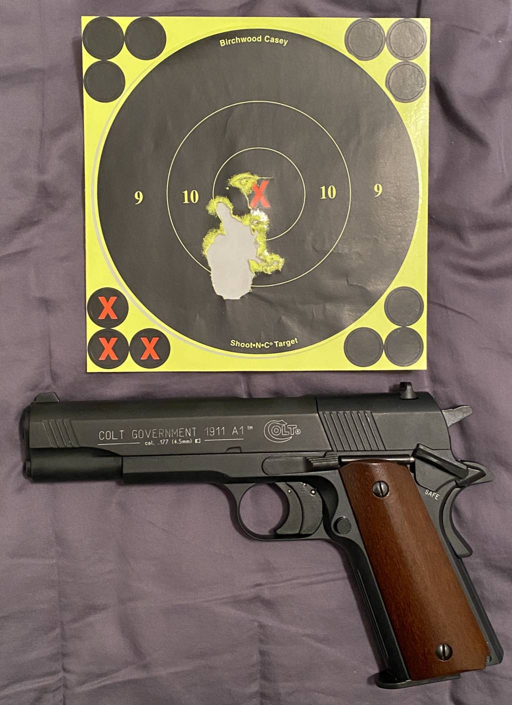

This photo is of my first Shoot-n-See target at about ten yards, single action. I peeled off the target to save it, but it sort of fell apart - too many holes too close together. I tried at 15 yards, and the group was centered over the target. All holes were good, other than the shots when the CO2 cylinder was almost empty. I'll post a better target when I get home. The more I shoot the gun, the better it gets.
