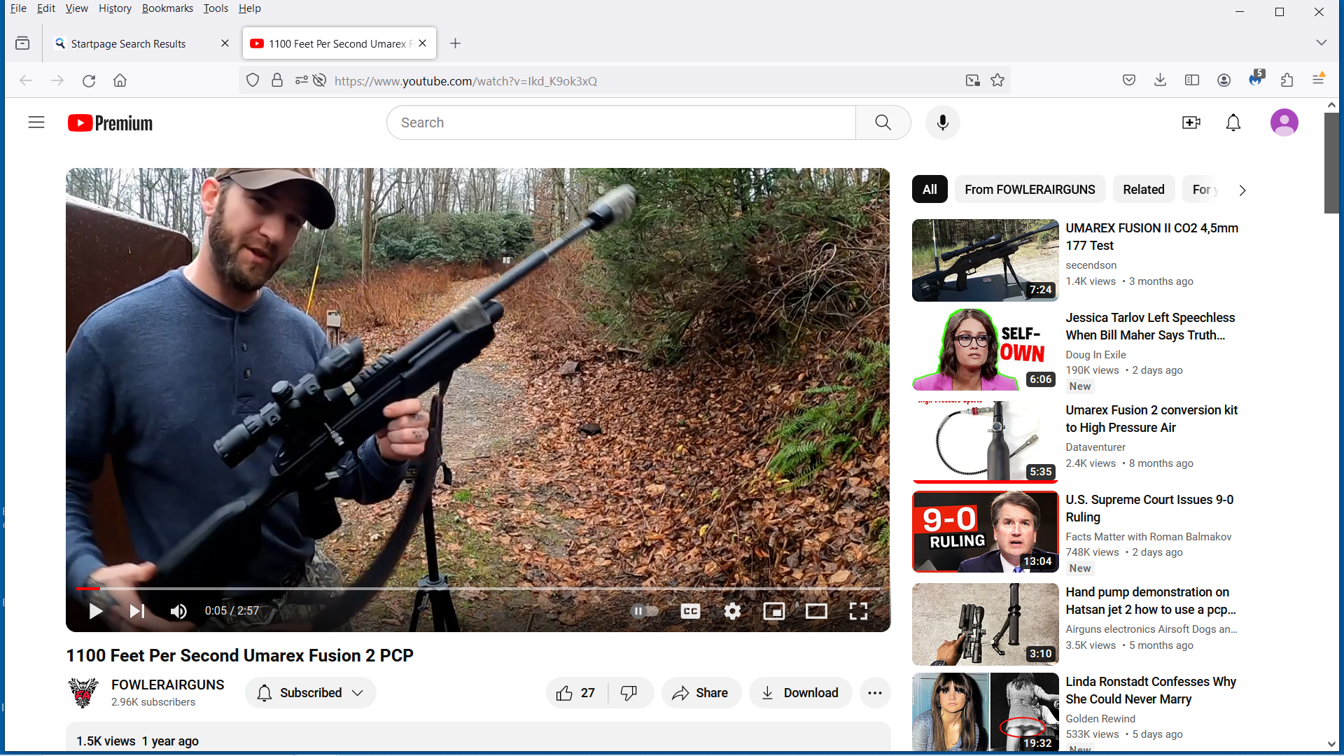

Thank You for your response. Per se, regards the 800 psi, your comment is spot on, so am including here a couple of photos, one off ebay and one from YouTube, FowlerAir Guns with regards to the Fusion2 PCP conversion that was done by Fowler........the tube in the photo am referring to is basically for a Hatsan, but there is no question it will fit the Fusion if a regulator mount could be figured out, OR, if referring to the Fowler video, left unregulated, as he says he is running 3000psi through the gun with no problem ( which I most certainly would not attempt, maybe a max of 1800) but that's what he is claiming). There is also in the comments section a question from an air gun advisor in Canada that essentially pointed out the same thing you did, but again, Fowler responds to him that he is pushing 3000 thru the gun....I have a Hatsan and a Gamo Urban, and several break barrels, so why am I wasting time with this. Good Question.

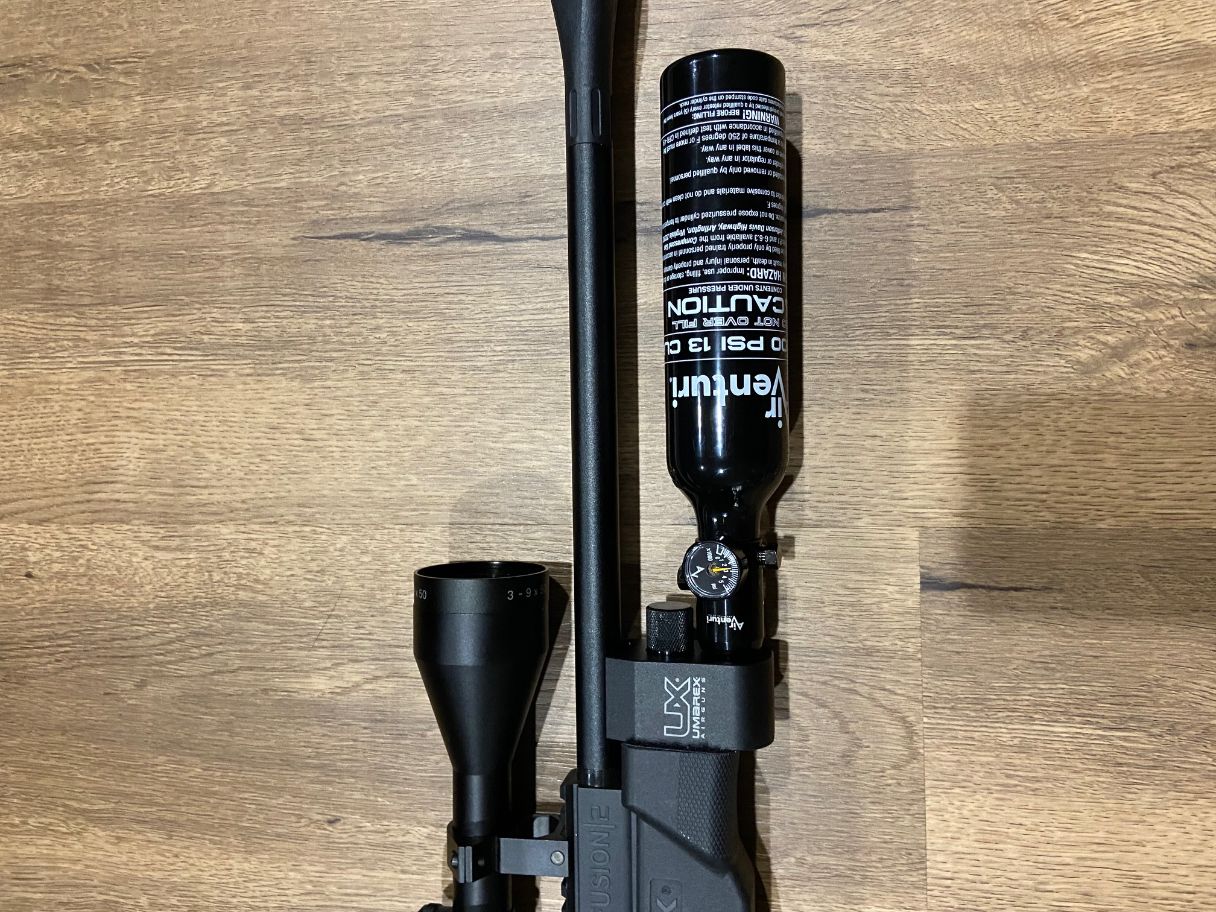

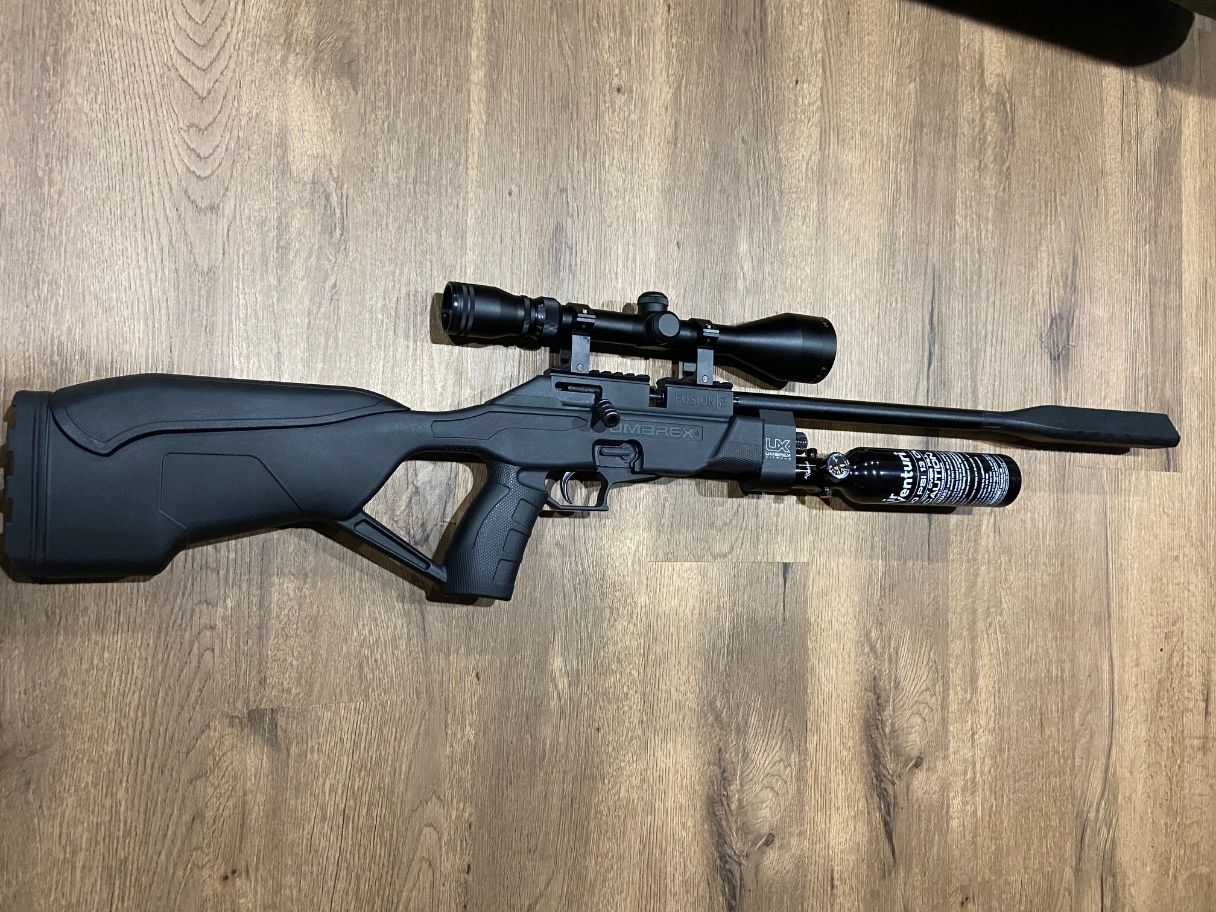

Here is how I did the conversion on my fusion,
Yes you have to pull the stock to cut it,
I know this was an older thread. But I figured I would ask as this is the first I havw seen this.
My father in law bought one of these on a whim a while ago because he thought it was cool looking and was told it would be perfect for the squirrels destroying his garden because it was "powerful" and quiet. It definitely is quiet but lacks power and shot count.
Figured I could convert it to HPA after bumping up power to give him the best from it.
What exactly did you have to do to get this like this? Just get the Umarex Air Javelin adapter and a Ninja bottle? Did you have to replace the hammer spring? Mess with any of the internals?
