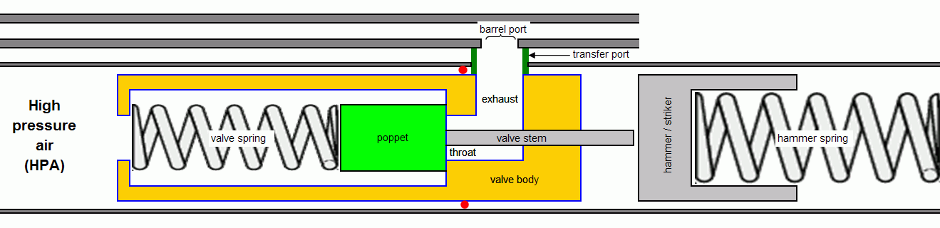

Leaking out of the barrel indicates the poppet is not sealing. The first thing to try is to cock it first. Otherwise the hammer spring may be holding it open.
So if hammer spring holding it back wat should I do this is a first for me
Simply cock it, then attempt to fill it with air.
By cocking it, you're drawing the hammer back so it is no longer pressing against the valve stem, allowing the poppet to seat against the valve body.
