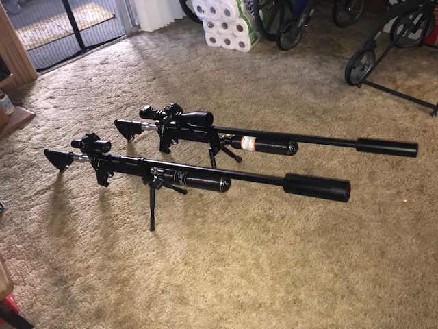

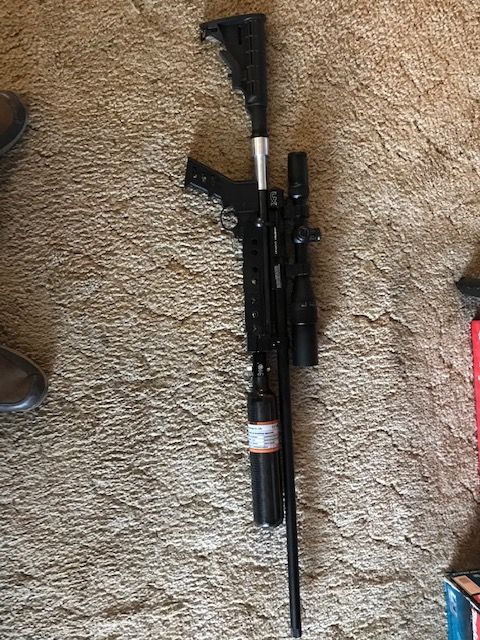

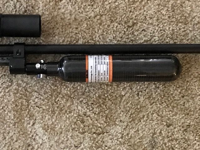

replace the bottle with a larger one, I put a 500cc Carbon fiber bottle on my .25 G1 with a 1900 psi reg and now I get almost 200 shots per fill at 4500 psi, did the same to my .22 G1 with a 1500 psi reg, I get over 300 shots per fill. modded both, you probably seen them on here before
