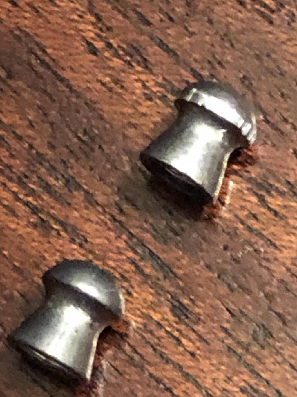

radduci, I’m at the point of sending mine back for lack of accuracy. I believe that the bolt probe is having trouble inserting the pellet, and that the rifling at the breech needs to be chamfered. To test it I inserted a pellet, closed the bolt then pushed it out with a pushrod. The pellet was cut up by the riffling, coming out of the breech with lead flakes. I believe that is where I’m loosing my accuracy.

I hope you’re wrong about breech alignment issues. My bolt, and probe are not loose, but rather pretty smooth, and solid. My theory for the bolt closing problem is that I believe that the rifling comes into the bore, and is finished with a 90 degree cut off. So the rifling comes into the bore, with a sharp edge, and that is what we’re shoving the pellets past, in order to close the bolt. I explained this to Umerex, and got a return label, so we’ll see what happens. Not all Gauntlet 2’s are like this! I’ve seen people with smooth closing bolts, and accurate G2’s. I would like to see Hajimoto, address the hard closing bolt issue. First off I don’t think the G2’s with this issue would give him accuracy. If I wasn’t getting Umerex to deal with it, I would have find a way to smooth out the rifling in that breach. Like put sand paper on my Patch Worm, and pull it just past the breech, a bunch of times. I would have to determine if the transfer port, O rings, or anything could be damaged first.

.20calguy, You are probably right about the barrel end. Someone commented the the barrel looks like it was just machined off at a 90 degree angle and left with no crown or smoothing. I suspect that might be the case on both ends of the barrel, so you may be on to something. After reading your post I checked the breach end of the barrel on my Gen 2. It looked pretty smooth to me. I could not see or feel any rough edges, but there may be an end piece in the breach so what I'm seeing may not be the breach end of the barrel but another fitted piece. I did push a single pellet into the barrel with the probe, but was not able to extract the pellet without severe damage to the pellet. Wish I had a wooden dowel for the job. I did again confirm that there is play in my bolt. I could physically lift the end push probe and had physical play pushing it down. It was very small play but less than a half millimeter. Unfortunately, I am not a gunsmith so there's not much I can further. I do think that the hard 'thump' to get the probe to go the last approximately 1/4 inch is probably the force it takes to actually finish inserting the pellet into the breach. The single pellet did not go 'smoothly' into the breach as they do in my Avengers and my Gen 1 Gauntlet, or my Hatsan AT44-10 which are all smooth actions.
I will be very interested in what Umarex says about your barrel. I listed a number of problems when I sent my Gen 2 back and asked them to fix a number of them. Instead, they just sent me a new Gen 2. I do not think they have time to look at specific issues. They are probably up to their ears in returns on this rifle, although I may just have had two bad Gen 2s in a row. Not sure Umarex is doing much to improve the accuracy of the Gen 2 at this point. As long as it shoots, I suspect it is deemed OK to ship. Hard to blame them when the Gen 2s come in that way from China. Bummer.
