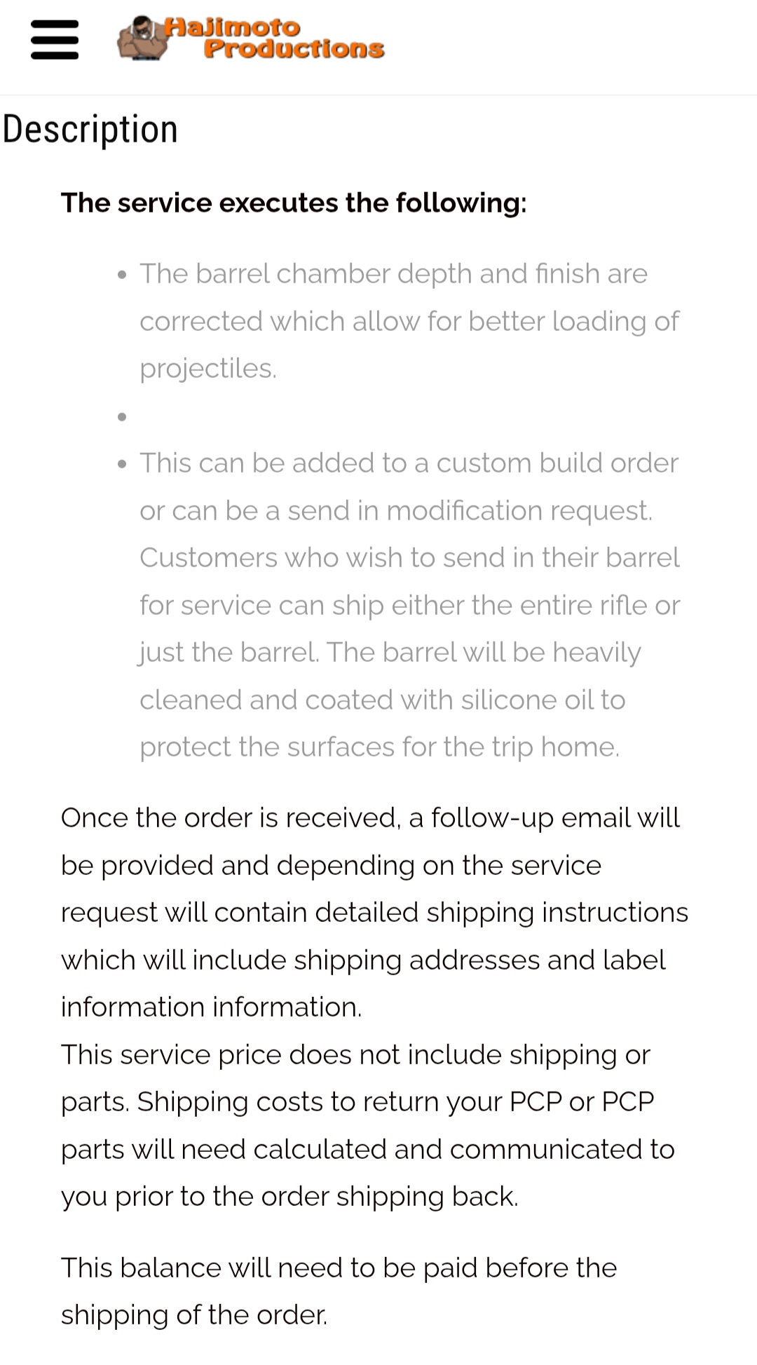

I would like to see Hajimoto, address the hard closing bolt issue. First off I don’t think the G2’s with this issue would give him accuracy.
I have addressed this issue in another post which you may find useful. Keep in mind that any of the services offered in a complete Tune Package, are also available individually for users that only have one item they wish addressed.
I hope this helps.

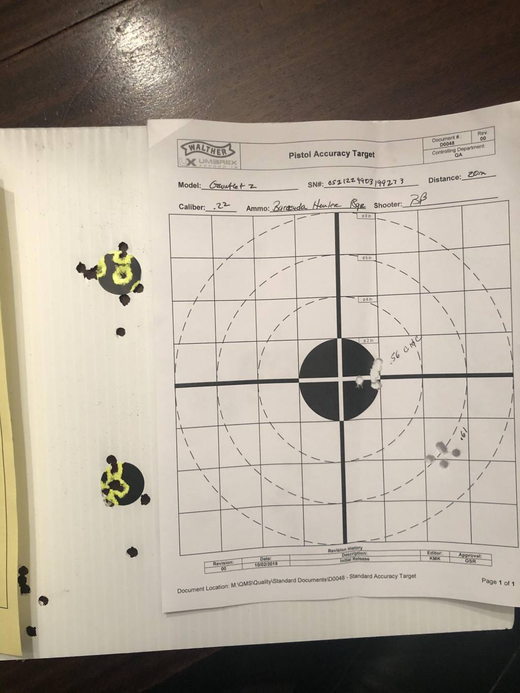

I just got my Gauntlet 2 back from Umerex. My results weren’t productive. I didn’t receive any correspondence, other than a test target, with a .56 and a .61” group at 20 meters. That’s not much better than I told them that I was getting at 50 yards, if you do some math. The best group I got out the gun, was shooting “weight matched” JSB 18.13’s, into a 1 5/8” group at fifty yards. Ten shots with six bulls on a one inch bullseye. A .56 group at 20M, calculates to 1.3” at 50 yards. Not a big difference. So I shot the gun, and found no improvement for our, mine, and Umerex’s efforts.
Hi, .20calguy; Sorry to hear about the return of your Gen 2 with no improvement. My result was basically similar. Fast turnaround but nothing significant changed. I read Hajimoto's comments about the causes of the need for a hard thump to get a pellet into the breach and found it very interesting. It makes a lot of sense, as did your appraisal re the rifling. Haji also spoke about the reasons for the hard chambering..... short lead-in to the barrel and the condition of the rifling at the barrel entrance. There is no doubt about the short lead-in and the condition of the rifling at the barrel entrance, as you also said. I am shooting indoors and probably will continue to shoot indoors using a combination of 4 magazines of Crossman pellets followed by another 4 magazines of JSBs to try to wear down the rough edges. Those hard Crossman's are beginning to make some inroads to wear down the roughness. The JSBs now chamber a lot easier but it will take some time. The grouping of the test shots Umarex sent to you look pretty good to me. If you are getting groups like that at 50 yards you are doing well, IMHO. I was lucky to get 2 inch groups last time outdoors at 60 yards. That was before I started shooting with hard Crossmans. It will be awhile before I feel ready to shoot at long distances again. It will take a lot of lead to polish up the lead-in and the barrel entrance but I have time and winters are long in Wisconsin so shooting outside is not very attractive up this way for a few months. Any plans to improve the Gen 2 yourself or send it for professional work? The end price of the Gen 2 may be a lot higher to make it better.
Hi Radduci, the picture of the groups, show the Umerex test target at 20 meters, or 21.87 yards, and my 1 inch black dot targets, at 50 yards, which is 45.72 meters. I shot those groups yesterday after I received the G2. I’m not sure what the two low flyers were about? Those pellets were sorted, and weighed. The regulator fps’s were amazing. All 977’s with two 979’s, and one 974, which could have been the low guy, if I’d have been paying more attention. After running out of those pellets JSB 18. gr, I ran about eighty Barracuda Match 21.14gr, and they didn’t shoot well at all.
as far as repairing this gun or letting it break in, I’m inclined to send it to Hajimoto, and have it done right. I have been watching and reading all I can find on his work, especially G2, related. I’m sure I’ll have a happier “my gun arrived” message after he worked on it. Lol in the meantime I’m going to shoot it. I’m in SE Louisiana, and this is our best BBQ weather, usually until after Christmas. Nothing goes better than BBQ, and pellet guns! Just don’t get confused, and keep yo hands washed! 👍
Hi, again, .20Calguy; I would be happy if I could get a group like that at 60 yards with my Gen 2. Even at 20 yards, mine won't consistently group like that. I'm not the best shot in the world but the comparison for accuracy between my Gen 2 and my Avengers is staggering. I've not been unhappy with the velocity and fpe measures I've taken with my .22 cal Gauntlet 2. Velocity stats averaged 1023 fps with 18.13 JSBs and 914 fps with 25.39 grain JSBs, fpe of 42.2 and 46.6, respectively (I only fill to 4K psi). Accuracy, on the other hand, has never been very good. I have given the rifle a good cleaning and will do it again after I shoot the cr*&p out of it with Crossmans, but am not sure how much better it will get. Your decision to send it to Hajimoto is a good one. I would also do that except shipping cost for me, even with UPS ground is about $40.00 so round trip would be about $80.00. That's a significant add to the price of the rifle. I can buy a lot of pellets for that much (if I can even get pellets again, with the delays in availability. Fortunately, Crossman are cheap and will hopefully stay available). I could pull the barrel but but would also need to pull the breach block and I'm not keen on doing that. Shipping cost would be cheaper for parts, only but there would still be a shipping cost and the mod is priced at $110 or something like that. Again, I just don't want to pour more good money after bad. I may change my mind later at some point, but for now the economics just don't make sense to me. By the way, lucky you on your location. Temps are running in the low 30s and we've already had some snow flurries here in Wisconsin. My taste for outdoor shooting is waning rapidly. The months ahead will allow plenty of indoor shooting time so we'll see. I do like your combination of BBQ and Pellets :). Also, proximity to DonnyFL 'ain't bad, either.

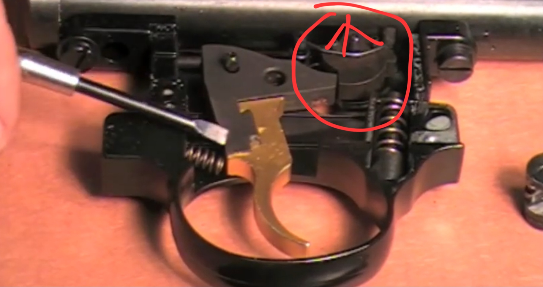

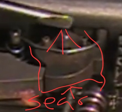

I say problems because it's plural now. First, I'm posting this for a friend, he's the owner of the gun. He brought it over to have me help him zero the scope. I have a standard 72cu' tank from air tanks for sale. We filled his gun to between 2 and 3k PSI per the owners manual. To be specific, we filled it to 2900 PSI. I cocked the bolt to the rear, and loaded a pellet. Put the gun on fire, and all we get is the sound of the sere being released, the spring going forward and the sound of some other trigger action - but absolutely no air released. I had to punch the bore of the rifle with a .22 caliber rod to get the pellet out, because no air was being released. I thought maybe I had overfilled the gun when I read the 1250psi warning on the regulator, but realized later that this PSI only applies to the amount of air the regulator is to release and not the fill pressure of the bottle. Nowhere in the gauntlet's owners manual does it say you can't fill the gun to 3000psi. So we try again and again, and get the same result, no air being released, but the tank pressure showing a steady 2900psi. Second problem: I took the stock off and took the trigger housing group off to make sure nothing was out of order. Everything seemed fine. Next, we removed the trigger group all together and took the rear retaining plug off. Out comes some sort of polymer guide plug, a convex shaped plug with a threaded hole going through it, and a long guide rod with a spring around it. When removing the front screw to the trigger guard, we realized it was questionably loose. Once we had everything out, we decided not to go any further because there were no glaring broken parts or pieces that we noticed. The second problem comes in when I can't get the parts back into the gun. I put them in exactly the way that they came out, and the rear retaining plug will go in - but once the gun is back together, the bolt will not cock the gun and it won't go all the way to the rear. I am at a loss here and open to any suggestion. As it stands now we still have a pressurized gun that won't go bang - and now wont' go back together the way it came out. I cannot find anywhere online a diagram or disassembly video or assembly diagram of the gauntlet. Any help is appreciated, Thanks.
I know this is an old post and you've most likely gotten this issue of your bolt not engaging fixed by now. The problem you were having when you pulled the trigger housing off of the Gauntlet taking the bolts one on each side of the trigger housing you removed the trigger housing and when you did this you disengaged the sear engagement from the hammer spring guide. When you went to put the trigger housing back on the Gauntlet you did not pull the bult back with the two trigger housing bolts one on each side of the trigger housing a tad loose then put the sear engagement back into the hammer spring housing by pulling the bolt back which the sear engagement would go up into the hammer spring housing then tighting the two bolts back up tight there for engaging the hammer spring when you pull back on the bolt. Below I have circled in red the sear engagement. The arrow indicates where the sear engagement needs to be put back in the hammer spring engagement when you pull the hammer back there is a little slotted spot where the sear engagement needs to be put into the hammer spring housing and tighten the two trigger housing bolts back up one on each side of the trigger housing that when you pull that bolt back the hammer spring will engage and pull the trigger the sear engagement will release and the hammer spring will engage smacking into the air valve and the rifle will fire. I hope this helps anyone that mat have this issue in with either the Gauntlet gen 1 or gen 2. The trigger system on both are the very same. Happy hunting / shooting everyone.

If you have a hard closing bolt, the pelets are being damaged in the chamber, by the sharp edge of the rifling, because there's no transition chamfer. Then lead chips from the damaged pellets foul the rifling ruining accuracy.
This is a common issue with some of these that Umerex decided not to warranty and let us live with.

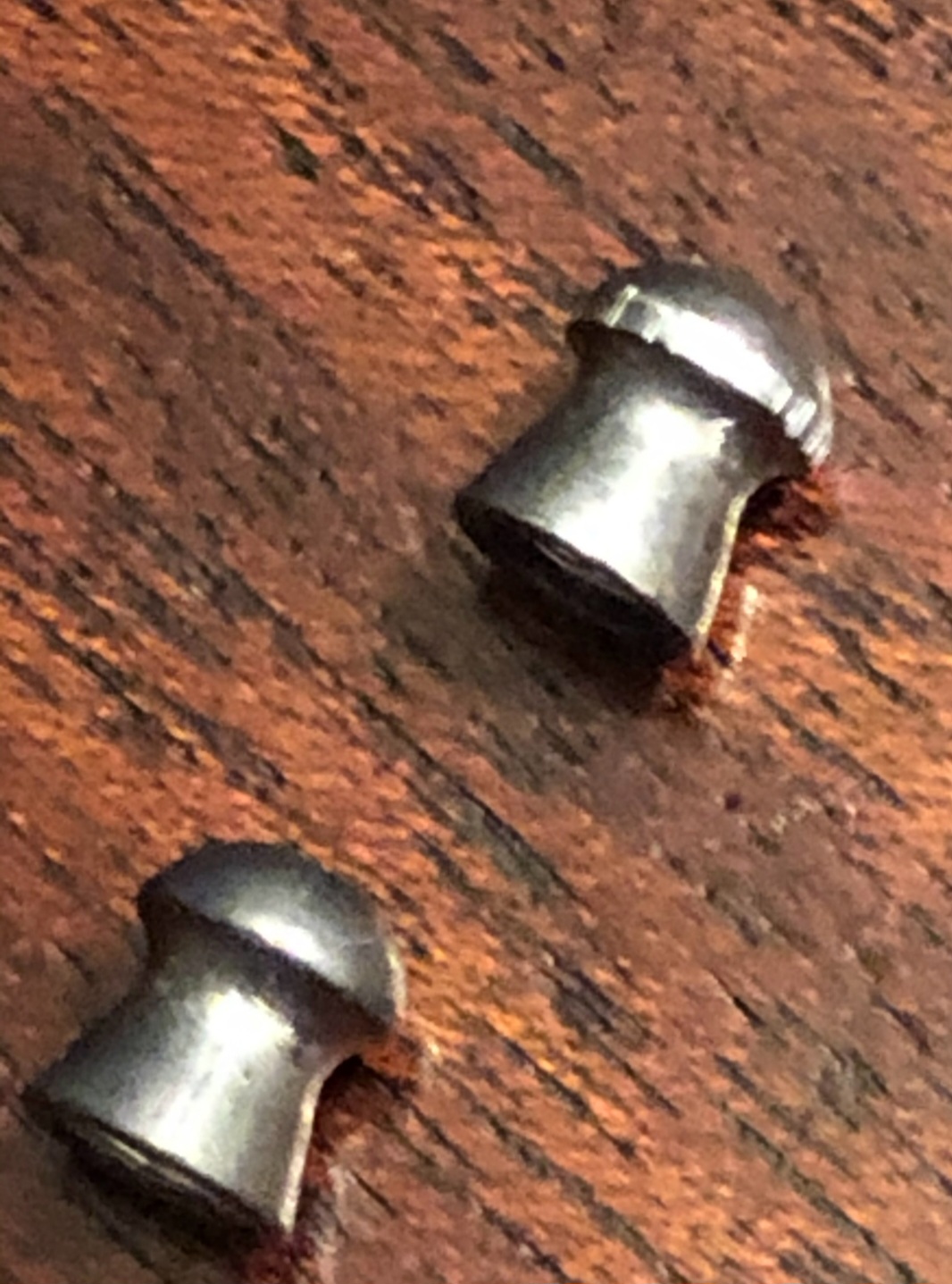

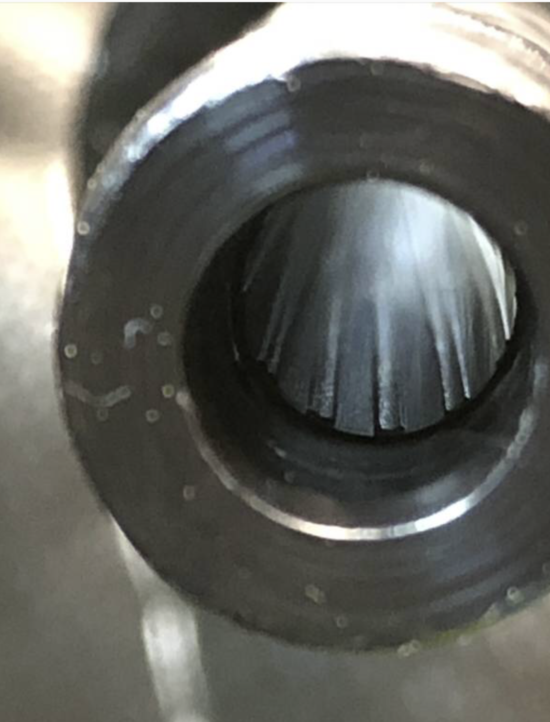

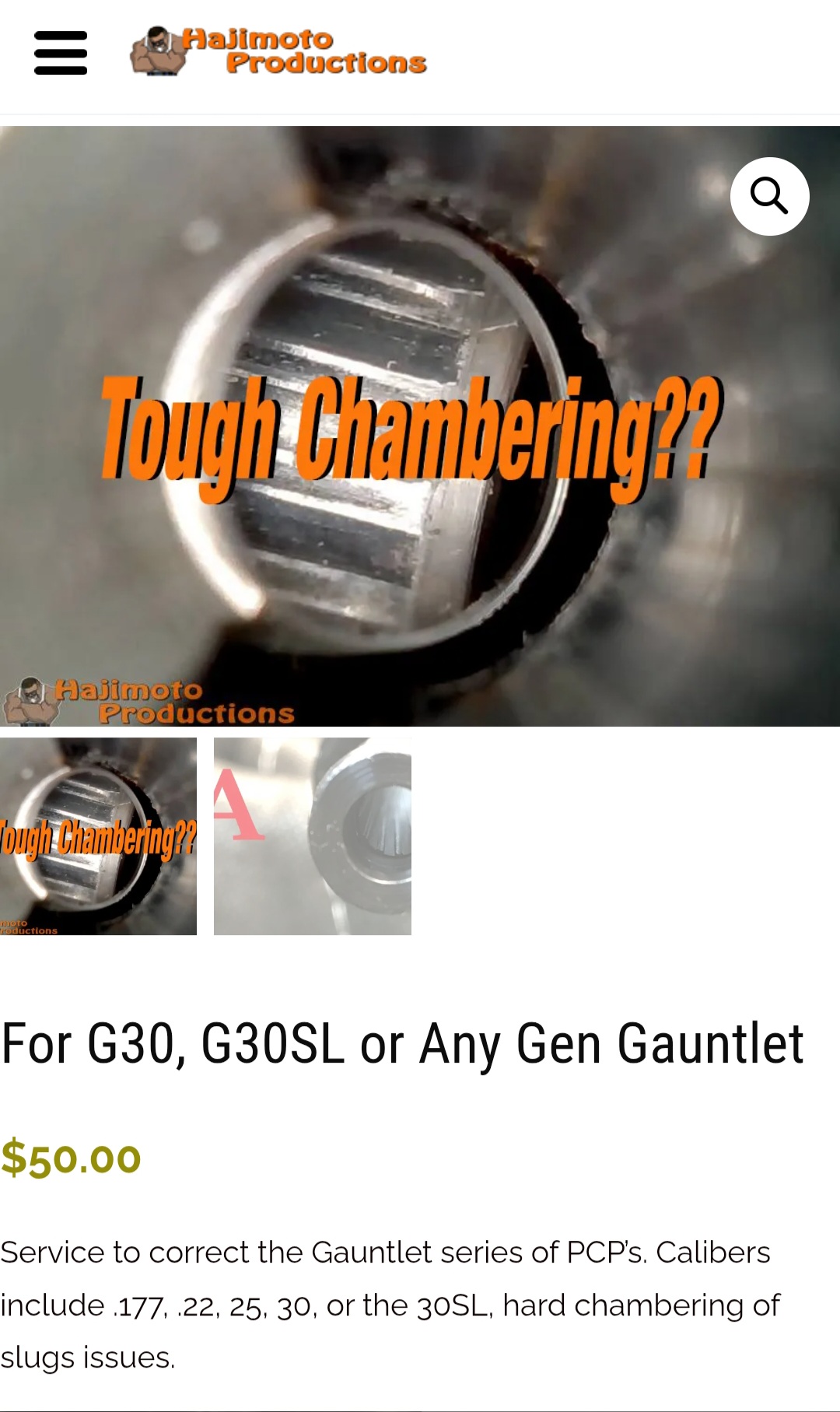

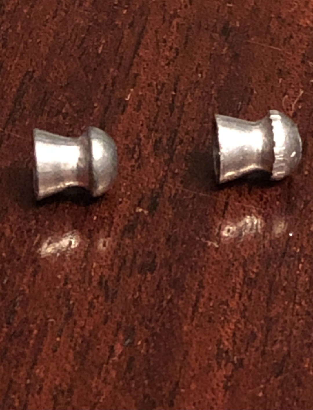

The chamber leade is the culprit. The fix will have to be beveling he rifling leade at the chamber.
When the rifling leade is not chamfered It damages the pellet when it is chambered. Then the chips form the pellet damage foul the rifling.
The pics below show the pellet damage just from chambering, and not firing the pellets.

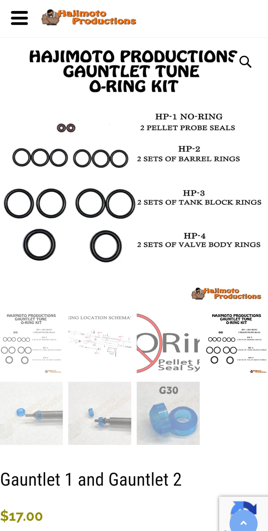

I bought an assortment of .22 cal beveled cutting stones to attempt the fix. I need to figure out what parts that I'll need to get it back together, O rings etc.
So to replace any o - rings that may need to be replaced for your Gauntlet go to Hajimoto's website and order the o - ring tune kit. This kit will have all the o - rings that you will need to replace all o - rings × 2. As far as the damage happened to the pellets I watched one of Hajimoto's videos just this afternoon and truth be told Hajimoto has a service to correct this for just $50 + shipping to and from with insurance to Hajimoto is I believe the best way to go this way you don't damage something that can't be fixed without replacing the entire barrel. Just my opinion but it's up to you. To do a simple barrel polish job is one thing but to do what needs to be done to correct this issue if you've never done so is another. But like I said it's all up to you beings your Gauntlet.

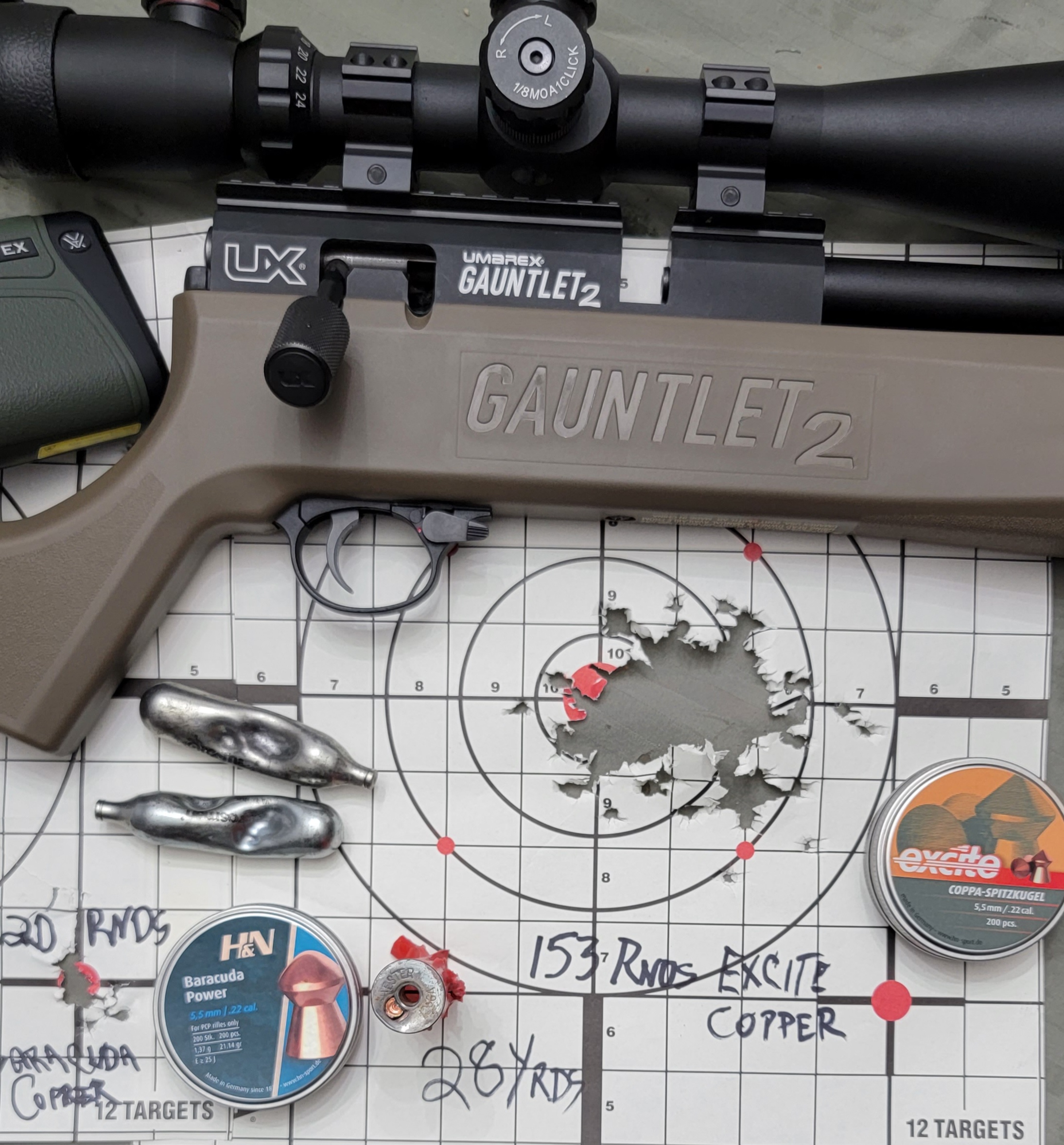

Hajimoto is who identified this issue in the first place. He sent me the picture of the uncut leade on a Gauntlet2. This is an old thread, and at the time my G2 hadn't shown any reason to spend any more money in it
Haji, said just shoot it with hard pellets like Crosmans, so I did. I switched to H&N copper clad Baracudas, and cleaned the barrel real good, and all of a sudden I was shooting small targets at 75 yards until the barrel fouled again.
The gun also holds air forever, and has an excellent regulator consistency. So the gun and I have sort of shook hands. I'll revisit the idea of sending it in. Thanks Rodney.
