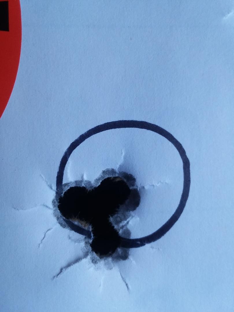

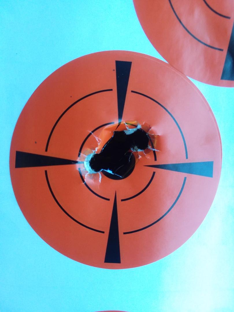

here ya go.......
30yrds
50yrds

here ya go.......
