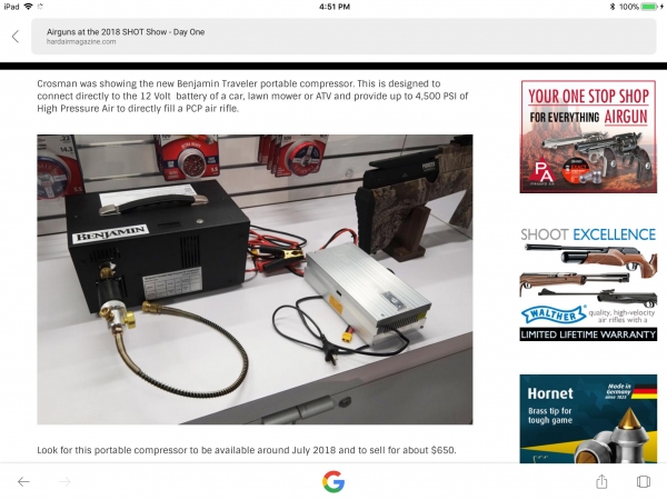

"Imold"Thanks cfarm for the video, for some reason I thought it was a bit faster then that and went to 4500psi, guess I’d still be better off putting my AV in back of my pickup and taking that with. It still has its place if your shooting a airgun with a high shot count then you could reset targets and reload mags while it’s refilling your airgun.
Yeah 900$ and fills to 3500 max, I'll pass.
Ok now we’re talking cfarm, I’ll need to get some specs on the Travler now.
