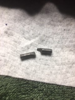

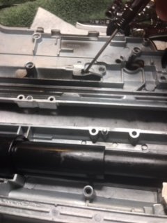

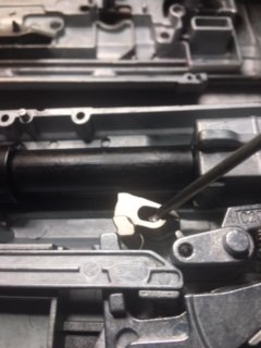

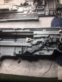

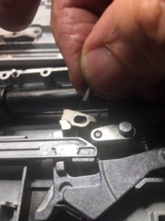

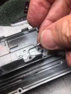

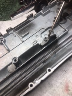

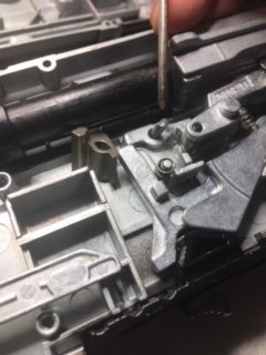

After pulling it all apart I found a small steel pin (3mm x 17.75mm) which had split in half. This pin is in the trigger mechanism and I'm guessing it takes the full impact of stopping the bolt. And after enough cycles it simply fatigued and split.
In the pics, half this pin is seen still in place in the left side housing and the other half is seen in place in the right half housing (I'm using a small screwdriver to point to the pin).
This is not a hardened dowel pin, a file attacks it quite easily.
I'll replace it with something more substantial.
