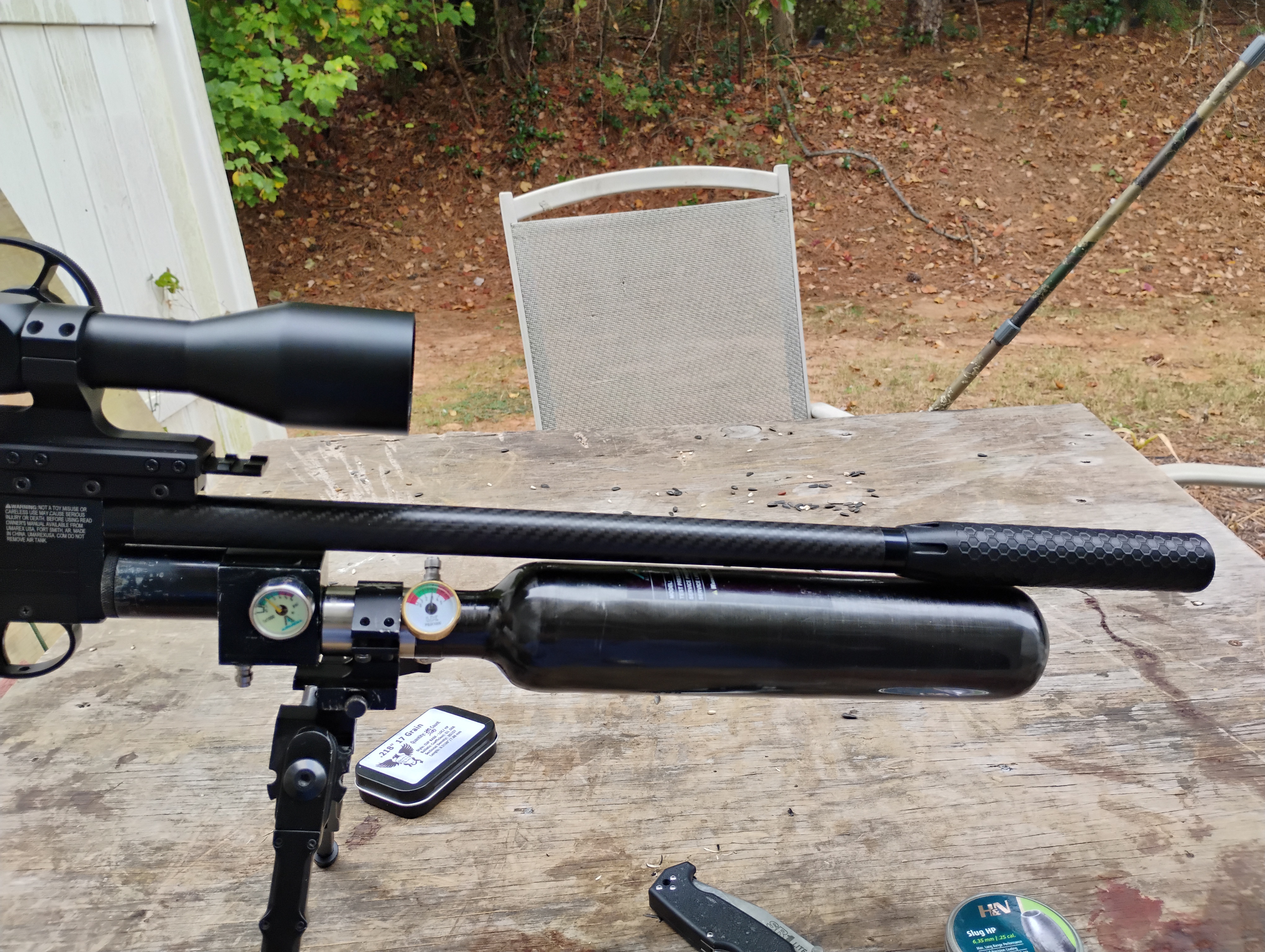

Can any of you share an image of your Notos with the 380mm barrel?
