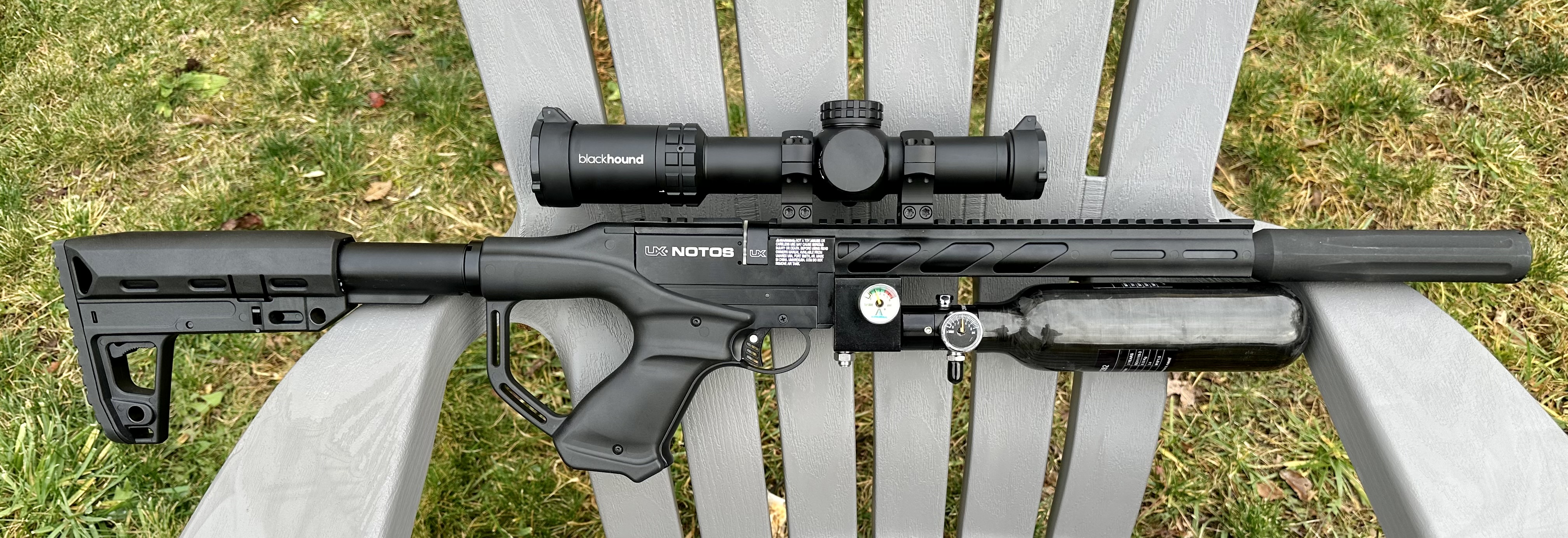

I'm obviously not Firewalker, but here is mine I just got back from him. Very clean install he does. Shot count should be 150+ assuming you keep it at stock power. I've not had the time nor inclination to test that though.

Regarding weight. I didnt take note of before and after weight, but can say that it doesnt affect the balance or weildability negatively at all. I much prefer the balance after getting it back from Firewalker. My only 'want' at this point would be to have something that could attach to the block or frame to allow a small pic rail for a bipod without the need for a bottle clamp. Still, the weight is so low that a bottle clamp wouldnt negatively compromise anything.
