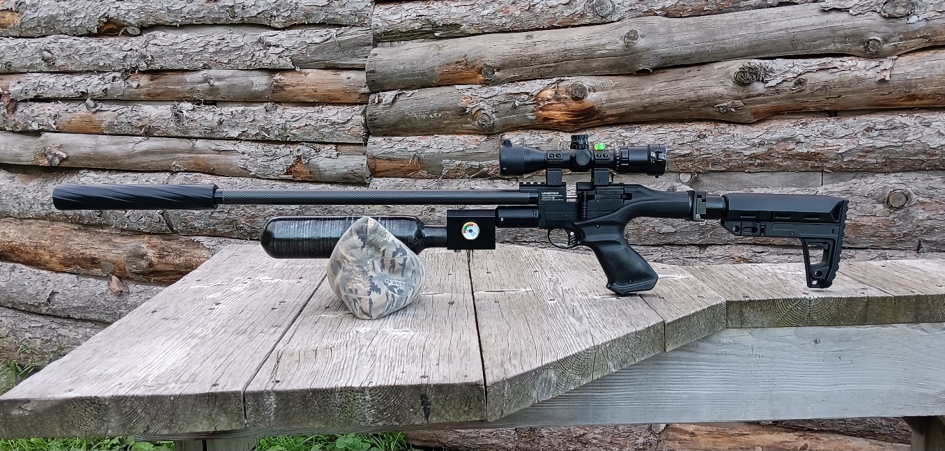

(Nice FX cocking lever)
Plastic lol. The short throw on the side lever was odd too. I was worried I would snap it off on a quick reload following up.
I think I TRIED to break the lever on mine before I swapped the FX lever but it held solid.
If you ever want to try another one, there is a wood stock being made and I have an FX lever... ;)
