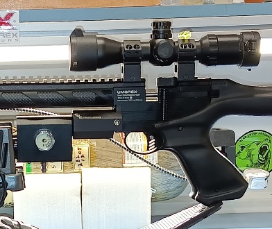

To firewalker I know this was posted last year now but what fx cocking lever did you use I have been looking but the ones I found won't line up
Custom fit Maverick lever, handle and screw. UA carries them.
Just did one last night...
