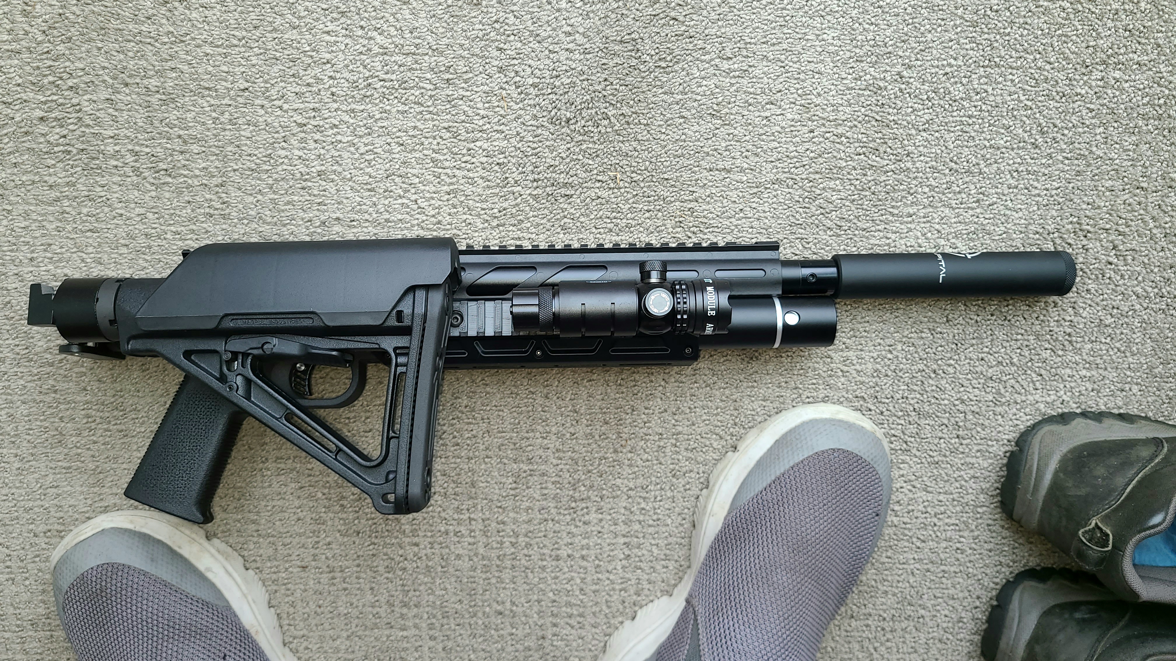

Yooooo I emailed Buck Rail a bit ago and now on his site he says he will be doing side folders with mil spec tubes and also you can get a different grip!!! (Scroll down)
I don't really like how the stock/tube is not in line with the rail/shroud. Wish it was more in line instead of a drop
That was something I noticed too. I'm thinking it is similar to the Avenger tac stock he makes where he did that on purpose to get access to the hammer spring while the stock is on? Hard to tell with just the one photo.
Other thing I can't tell is if the stock folds left or right. In my email I said he should make it fold right since the cocking lever is on the left so you could actually use the gun when it's folded.

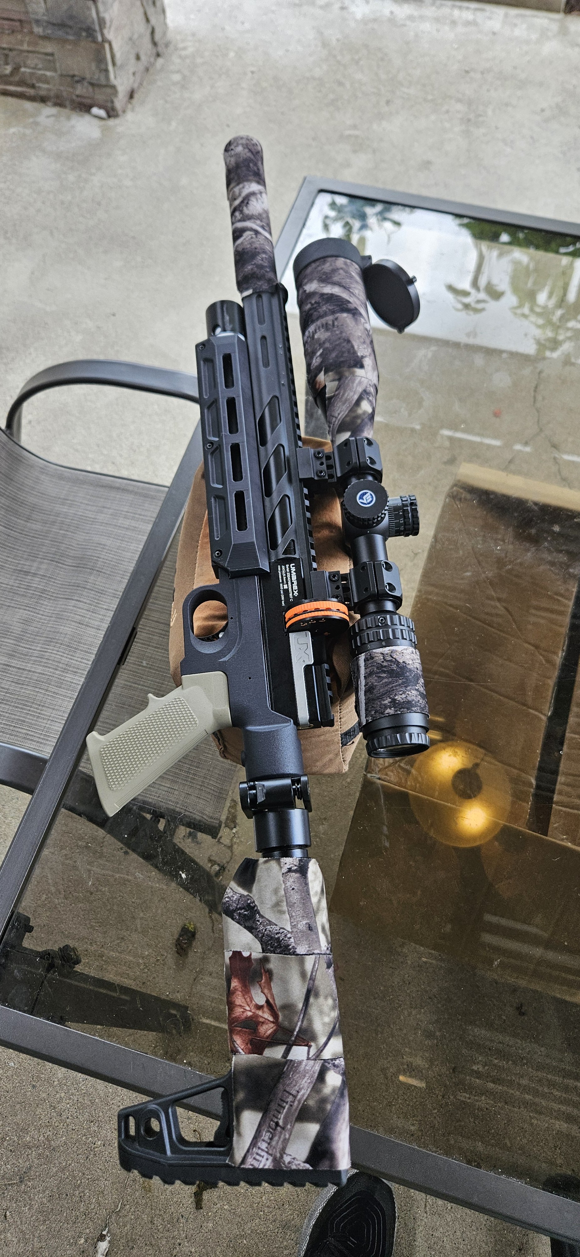

I'm new to the game and I have a NOTOS.Did anyone find the right parts to make to stock fold. ? They have them on Bucks site,but have been out of stock for awhile. They have all the other parts,just not the part that makes it fold......thanks Gary
Reactions: Airgun Al
Yeah I got that part buck sells it works well the problem is he said in a newsletter that the company that makes it is going to stop so that's probably why not in stock now.
