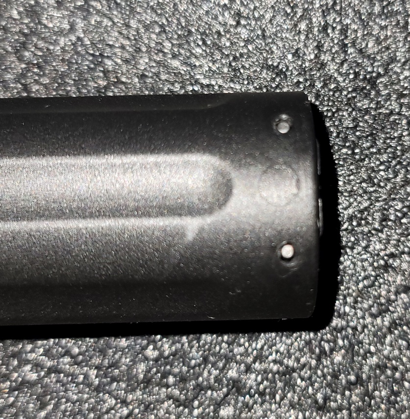

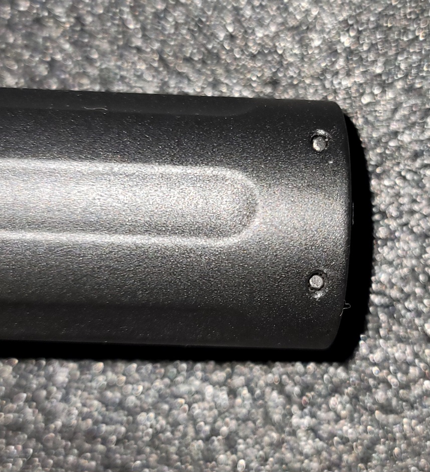

Attached are two pictures of the moderator.
One is from the top and the other is from the bottom.
The bottom has the circle shape between the pin holes.
I assumed the pins went top / bottom or bottom / top. However, perhaps they go side to side (left / right).
Is anyone able to confirm looking at these pictures?
yes pins are vertical and if you remove them the end cap comes off and then you can slide the one piece baffles out.. if you fire it with the end of and baffles removed it pretty loud
