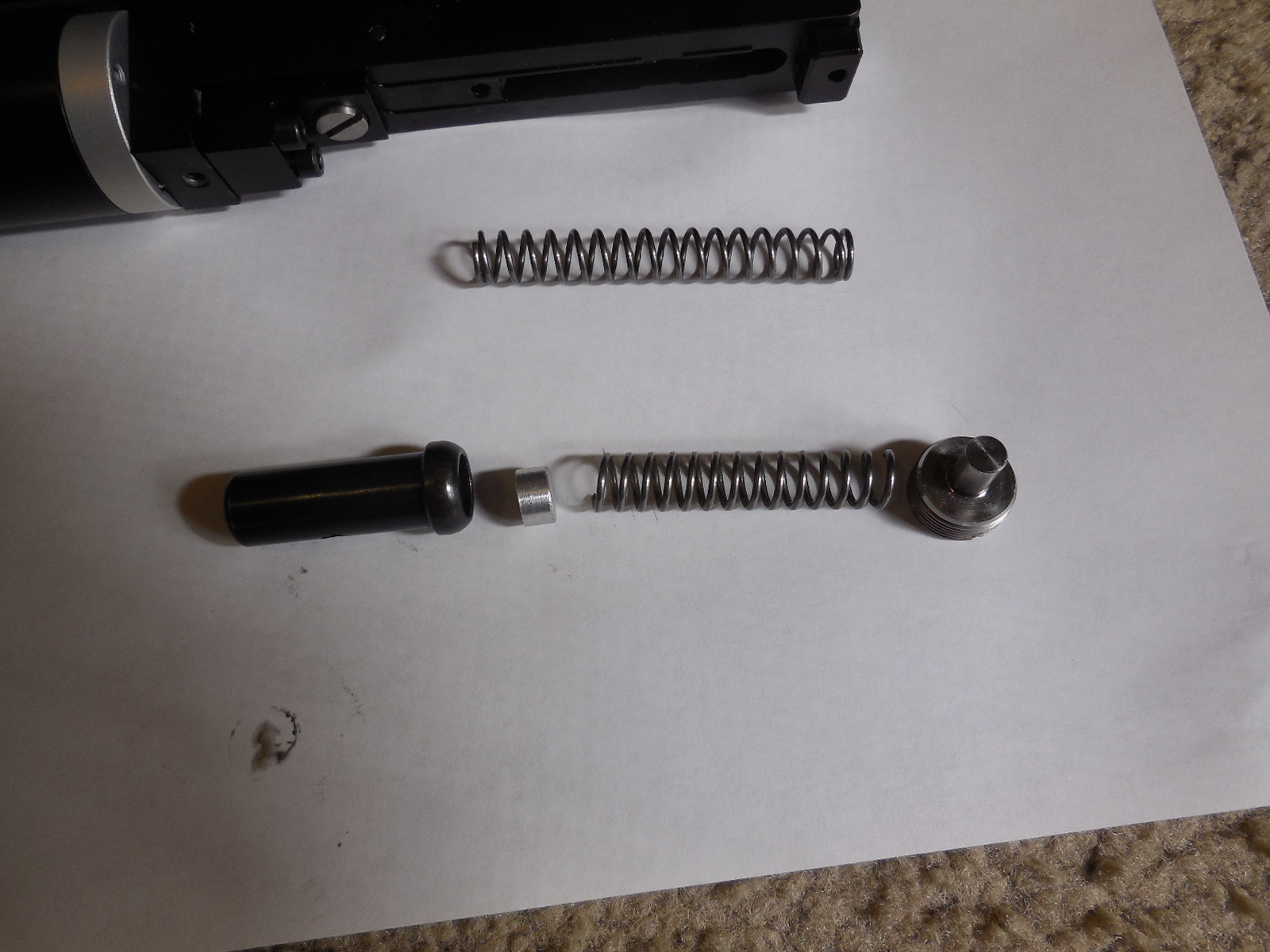

I did adjust the reg bout 1/8 turn CW on the reg. couple more adjustments CW down to 490+. now working CCW back up to 675fps hopefully
So my hammer spring setup top spring in pix is original HS. added a 5mm shim in the hammer in front of the softer spring I had.

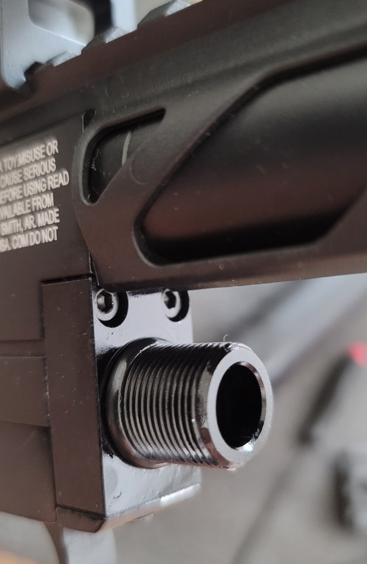

Three screws hold the block that I can see... 1 on bottom and 2 in front as shown here.
To get these out, it looks like the handguard rail is in the way. Does anyone know if / how to get those screws out?
edit: Seems like the screw on top of the rail and then potentially a screw underneath that for the barrel would allow the whole assembly to come off - is that was has to be done?
The bottom flat head screw on the bottom in front the trigger guard helps hold the trigger guard. With the the stock off and under the hammer spring adjuster is a round Allen key screw think it’s 3mm unscrew that the bottom pistol gripe detaches.. I haven’t figured out how the barrel detaches.
Appreciate that info. If I understand correctly, that will still leave those 2 screws blocked.
I thought I remembered reading that the top screw on the handguard/rail can be removed. And underneath that was a loctite'd grub screw which secured the barrel. Maybe I am remembering incorrectly...was hoping there was a way to put in the gauge block without removing the barrel. Maybe that is not possible ... or maybe there is another way.

Take a look at the new block I believe there are 4 actually maybe 5 holes for bolts I am not at home right now, but from memory 2 in front one from the grip (actually have to remove the rear for the grip too) then 2 more under on the backside once you remove the grip.
That block holds the poppet valve spring. There are 4 allen screws holding it. First you have to remove the barrel and shroud as a unit. Top rail has a screw you remove this first, then under it is another set screw for the barrel retainer. It is a 1.5mm allen and has a thread locker, you may need to heat it if too tight. After this you can slide the barrel and shroud forward. Then you have to remove the trigger and grip assembly, one screw in front of trigger guard and on the beaver tail. Then you will see the two allen screws facing forward. After removing all 4 screws, you can slide the block out. While you have it out you can drill the air way bigger to 5mm if reusing this block. It will reduce the pressure deferential between plenum and valve during firing moment resulting in speed gain. Note be careful when reassembling trigger assembly. It's easy to kink the sear lever spring if not properly aligned.
Appreciate those detailed instructions. The plan is to use the PP750 Gauge Block with Picatinny Rail from airgunarcheryfun. I'll need to allot more for this replacement as it seems more involved than first thought.
