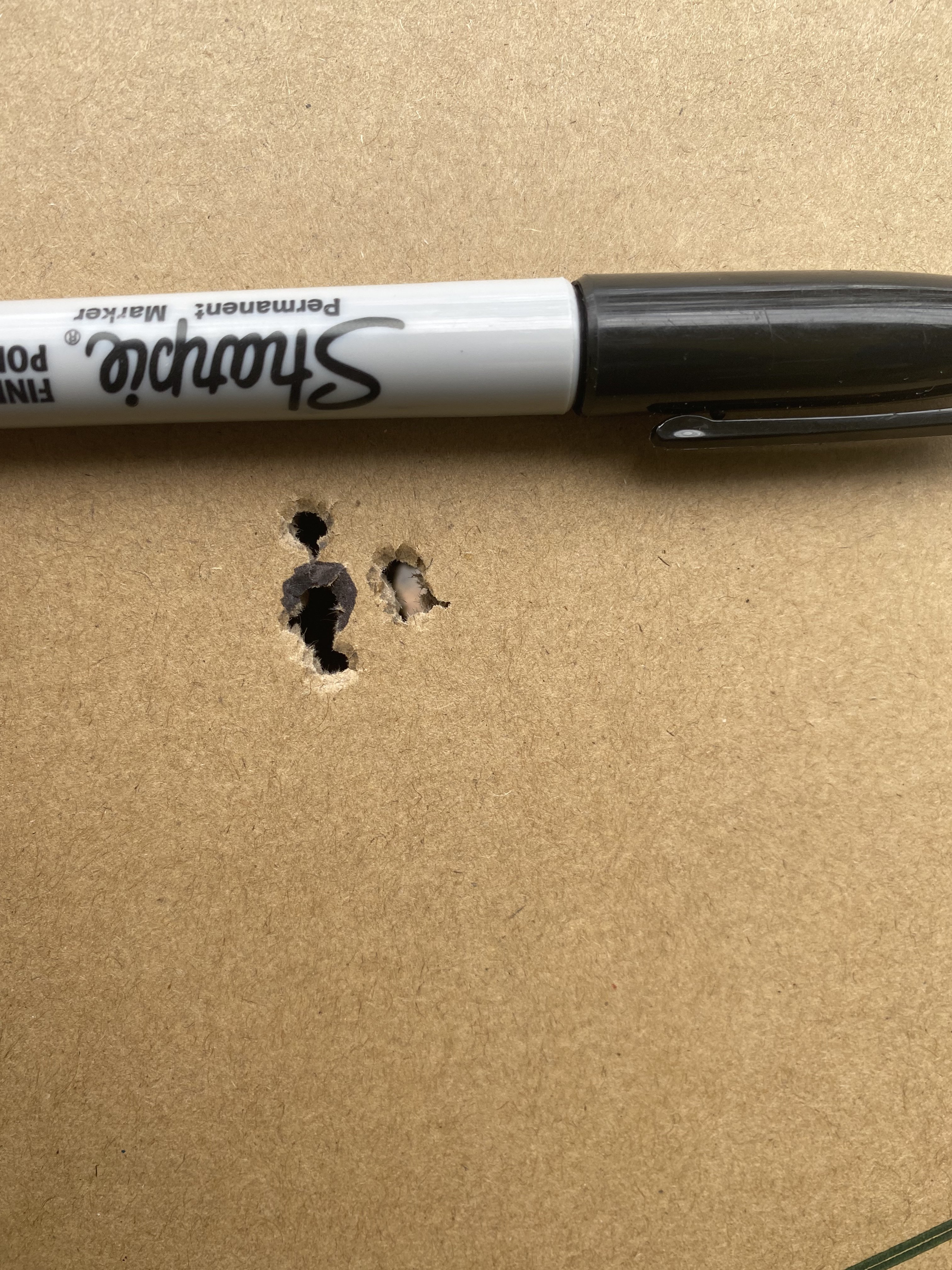

This is a 25 yard , 7 shot groups where the magazine gave me problems. It’s definitely deforming the pellet as they load. Not sure what’s causing this misalignment. Can’t see anything obvious that’s causing it.
This is 7 shots at 25 yards, with each pellet loading well. ( I’ll show another pic next showing a group with the magazine loading roughly.) For best accuracy it seems it’ll require the single shot tray that comes with it, but my “good” groups at 25 so far are plenty reasonable for me.
I’m using 18gr JSB’s this morning. After going through my .22 pellet shelf I cannot find any of the 15gr JSB’s I planned on trying. Otherwise I have a plethora of 18 gr FX and JSBs and a variety of H&N’s from 21gr down to 18gr, as well as a bunch of NSA slugs.
With the velocity sitting at @700 with the 18gr I don’t think there’s any point in trying any of the heavier H&N’s or NSA slugs. Gotta order some more 15 gr pellets to try out.

I’ve put some silicone oil here and there and worked the bolt back and forth a couple hundred times. Have probably put 100 pellets through it today. Ran another 7 shot magazine over the chronograph after the rifle had been out in the cold for a while to see what effect that had on it. Still pretty well hanging in @ 700fps-ish. Able to hit soda cans at 60 yards, but I think thats beyond the intended hunting range of a little pistol carbine like this.
This is a 25 yard , 7 shot groups where the magazine gave me fits. It’s definitely deforming the pellet as they load. Not sure what’s causing this misalignment. Can’t see anything obvious that’s causing it.

I shot my groups from my Caldwell tripod so there’s minimal issues with hold. Have not tried the single shot tray yet but I definitely need to.
It’s a little too chilly outside today for me to be able to settle in and really get down to the nitty gritty. I’ve just been spending a little time here and there shooting a few magazines and then coming in to warm up.

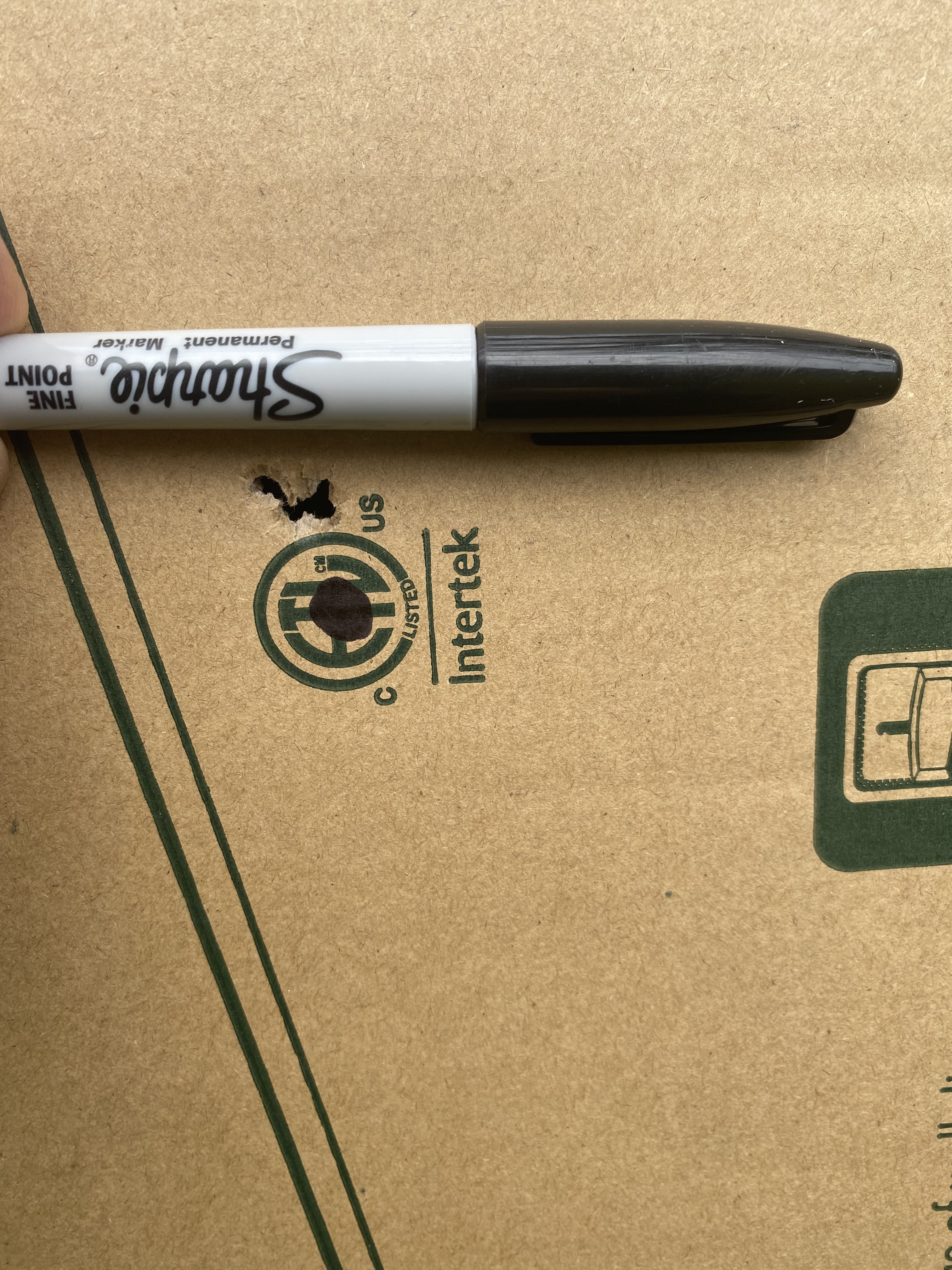

I received my notos today, this thing is awesome compared to the Jet 2 I have which had no accuracy whatsoever out of the box and is a work in progress. It fits and feels great! I had a problem with the second load of the mag too, but when removed the pellets and reloaded them all was well. I really like this one! Here are some pics and stats. These shot are only 13 yards indoors for now but the attached moderator DOES NOT NEED TO BE REMOVED! She is quite!!
What a great little rifle! I think these are going to be very popular pcp’s. Can’t wait to see what kind of aftermarket stuff pops up for them. Congratulations on getting yours! Do you have any lighter pellets to try in it?
