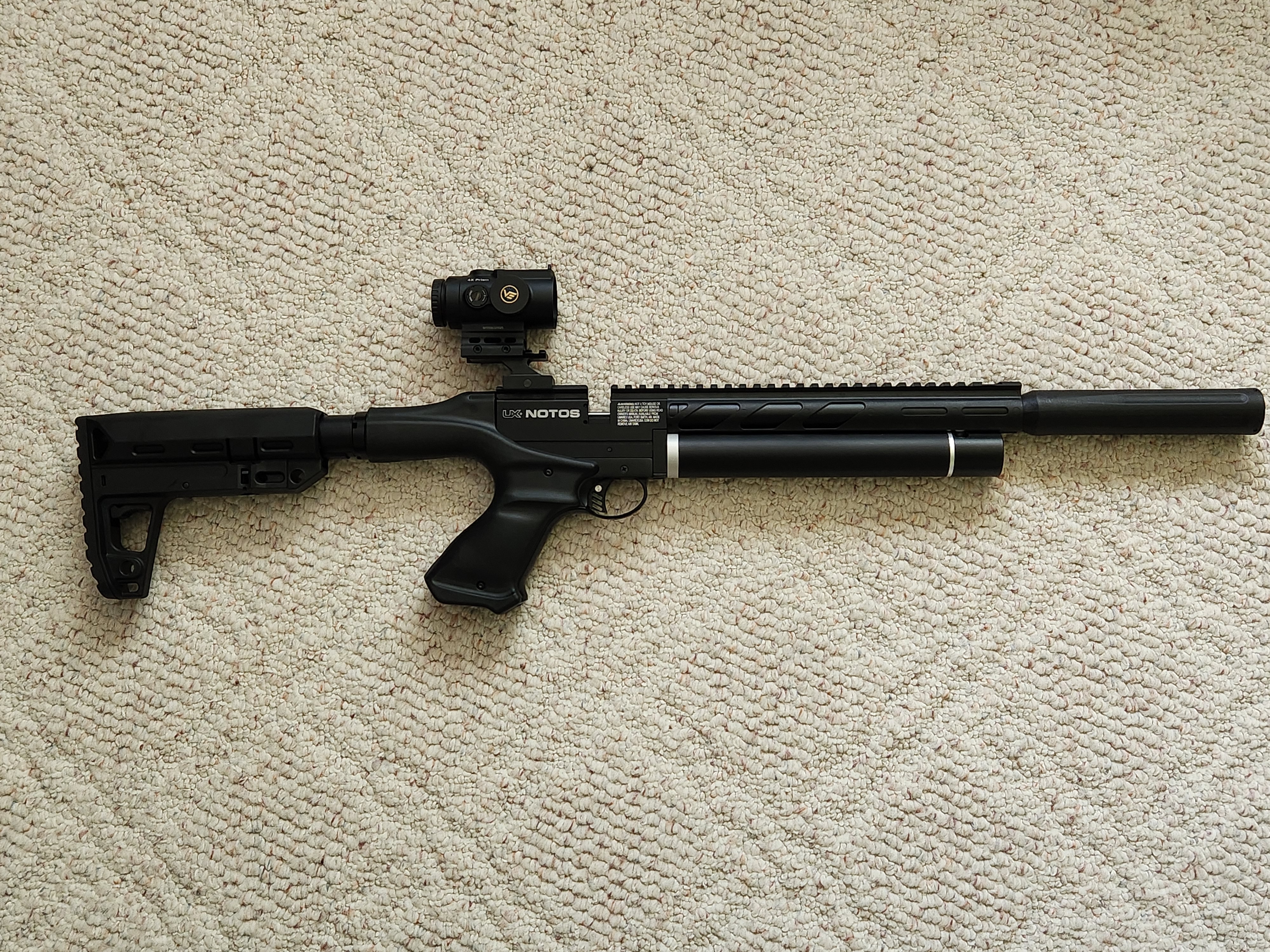

Looks high but I luv it! Vector Optics Paragon 4x24 micro Prism.

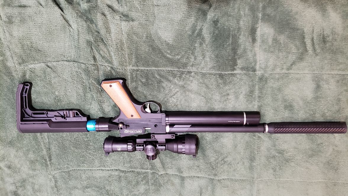

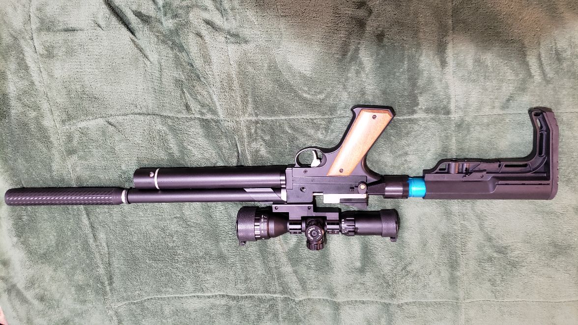

I have been thinking of purchasing a NOTOS but have been working on my PP750. I just added the buttstock adapter and waiting for the gage block for the reg pressure. Then I will do some tinkering and see what I can get out of this fully dressed 4.5 lb. mini carbine. Anyone know where to get black pistol grips for this?
Nice, I got mine from umarex. It's same price as the independents. Where did you get your buttstock adapter? Unless you got a longer barrel the speed you get will be limited as there will be a lot of wasted air. The umarex's barrel is very long and what gives the notos its speed.
Allen

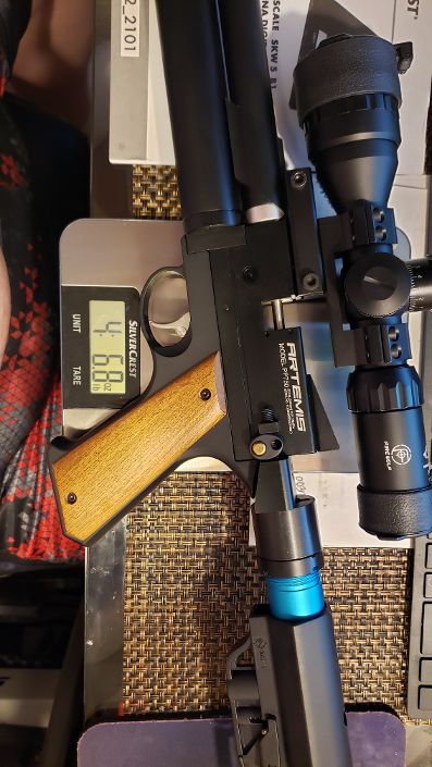

I bought the adapter on EBAY. I think $28.00 plus shipping. Does not come with tube or butt stock but I had 1 laying around. I want to buy the longer barrel and shroud from CANADA but he is out of stock. That is where I ordered the gauge block from. Do you have a NOTOS and can you measure the air tube. The PP750 tube is only 7 1/4 long. If it is longer I may see if one of the guys that converted to bottle wants to sell theirs. My PP750 only weighs 4.5 lbs with scope.

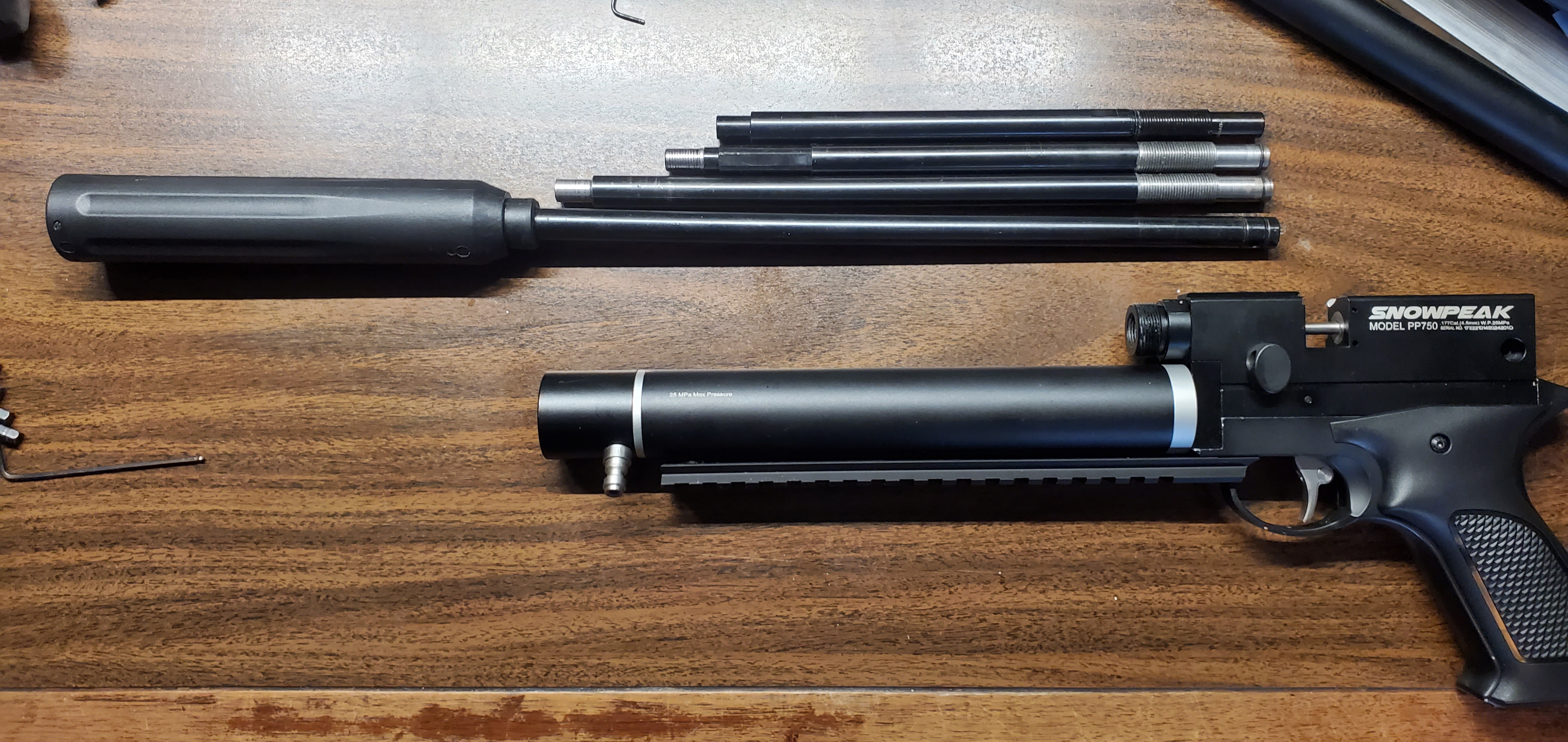

I dunno where Wes was sourcing the barrels from. The notos barrel extends beyond the shroud (so notos shroud does no sound suppressing) and well into the moderator.
Top barrel is the pp750, then 2 aftermarket .177 barrels and then on the bottom is the notos .22 barrel.
Oh sorry the shroud length is the same on the notos as the pp750. But the pp750 has a threaded barrel unlike the notos. The shroud on the notos is actually threaded but serves the notos no purpose.
Allen
As mentioned before they are the same gun with some small changes. The main block is machined slightly different. The barrel slides in vs threaded. So basically those items will not interchange. Some can be modified to fit.
