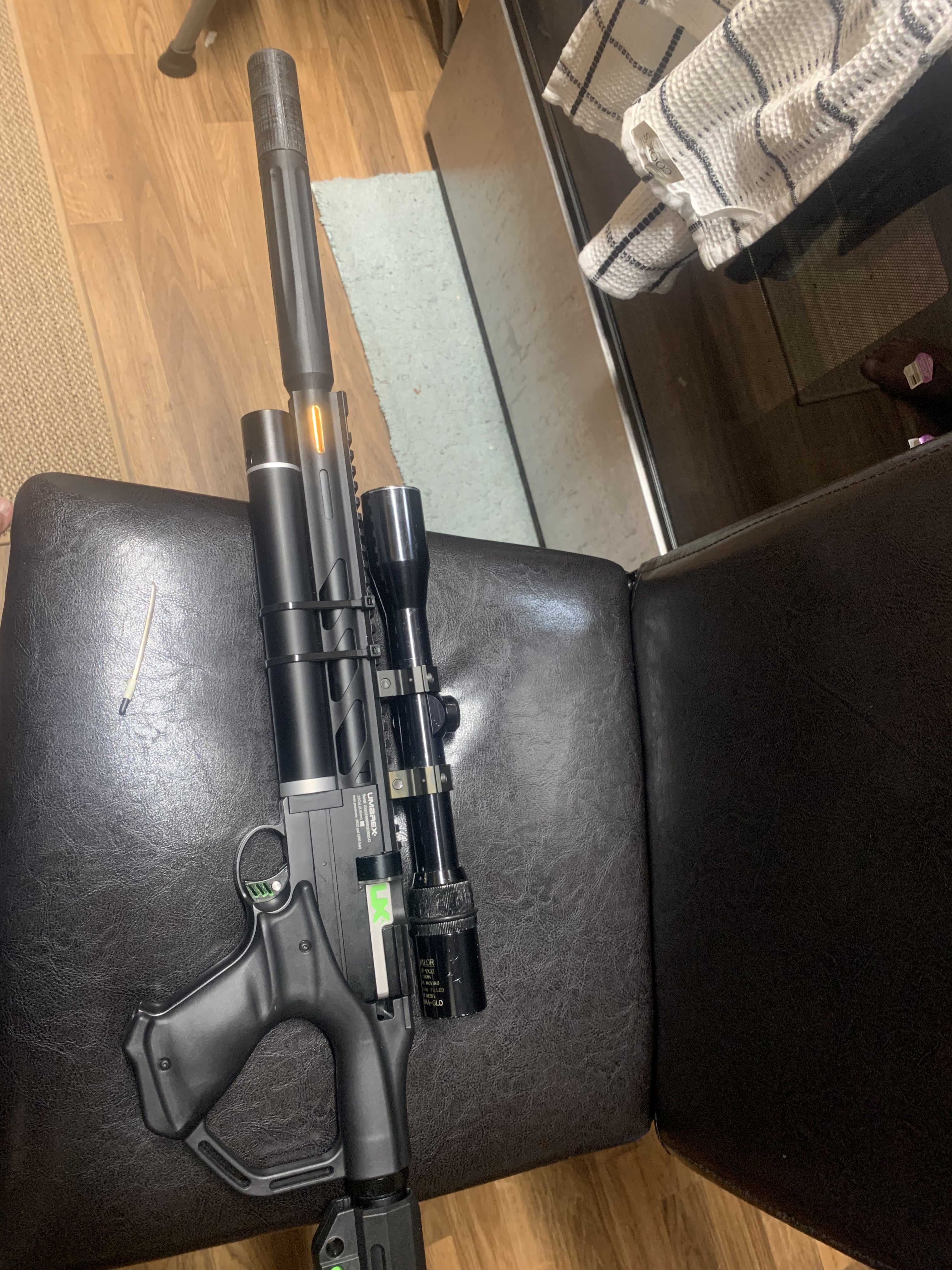

the printed moderator insert printed by miksatx is functionally magical! it’s so much quieter now, i had to pull out my chrono to make sure it was still a 775-780fps slapper.. and it is! thanks mike!

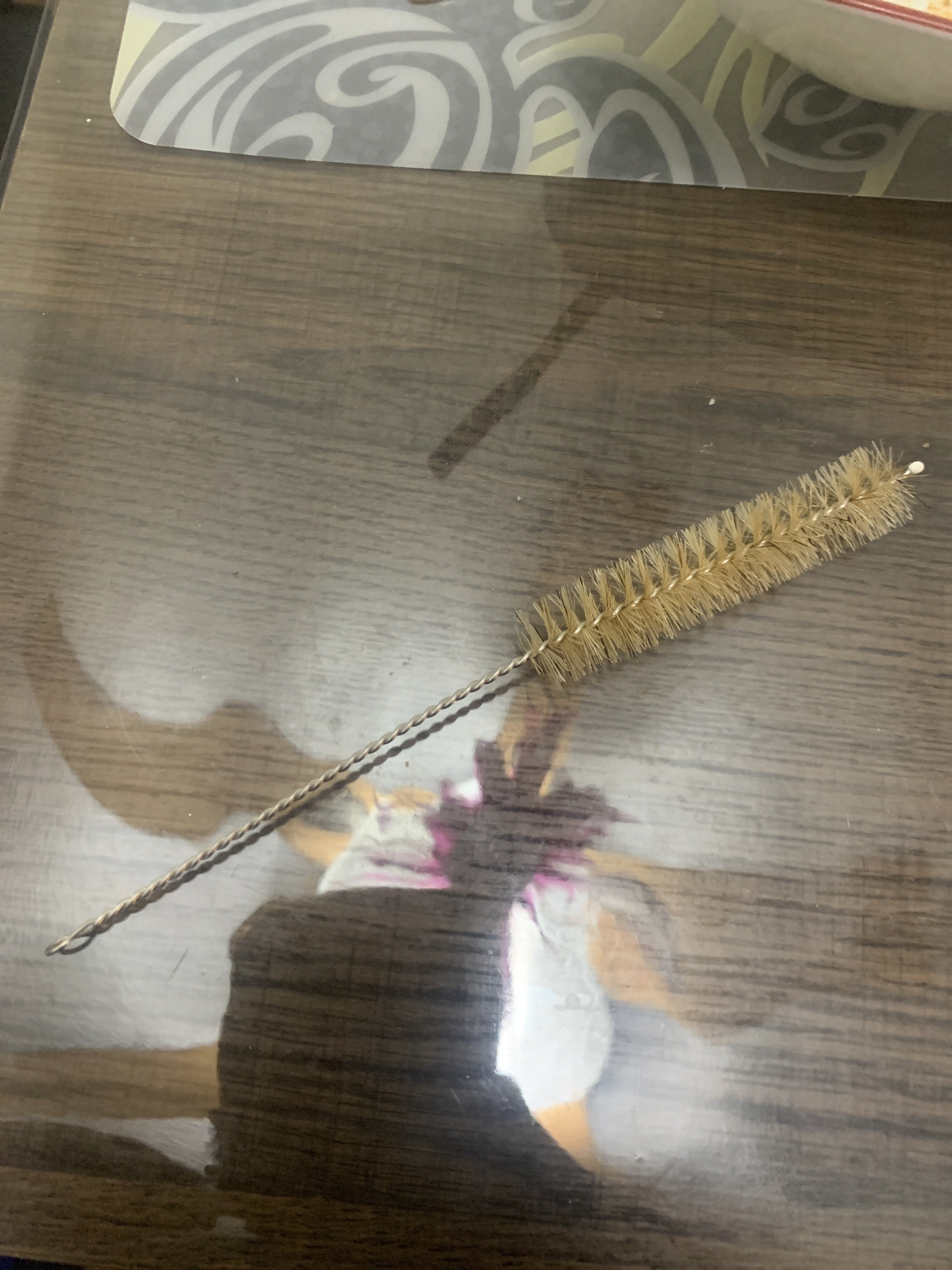

i sanded the insert a little bit to lessen the glossiness. there were also some super fine printing strands inside the insert but a straw cleaning brush cleaned that up nicely. i also cleaned up the pin holes with a matching drill bit and oiled up the o-rings with silicone. removal of the pins and insert is now a breeze(easy peazy barrel cleaning. the two black zip ties are just to hold the barrel shroud still until i find a better solution. i dont know about anyone else but that tiny bit of flex from the barrel shroud was like a splinter under my nail.
i also sanded and polished the trigger adjustment screws and piston release point.trigger break wasn’t bad before but it’s truly a night and day difference after the trigger tune. it was too fun to shoot so i procrastinated on the trigger tune till now. 😆 no regrets!

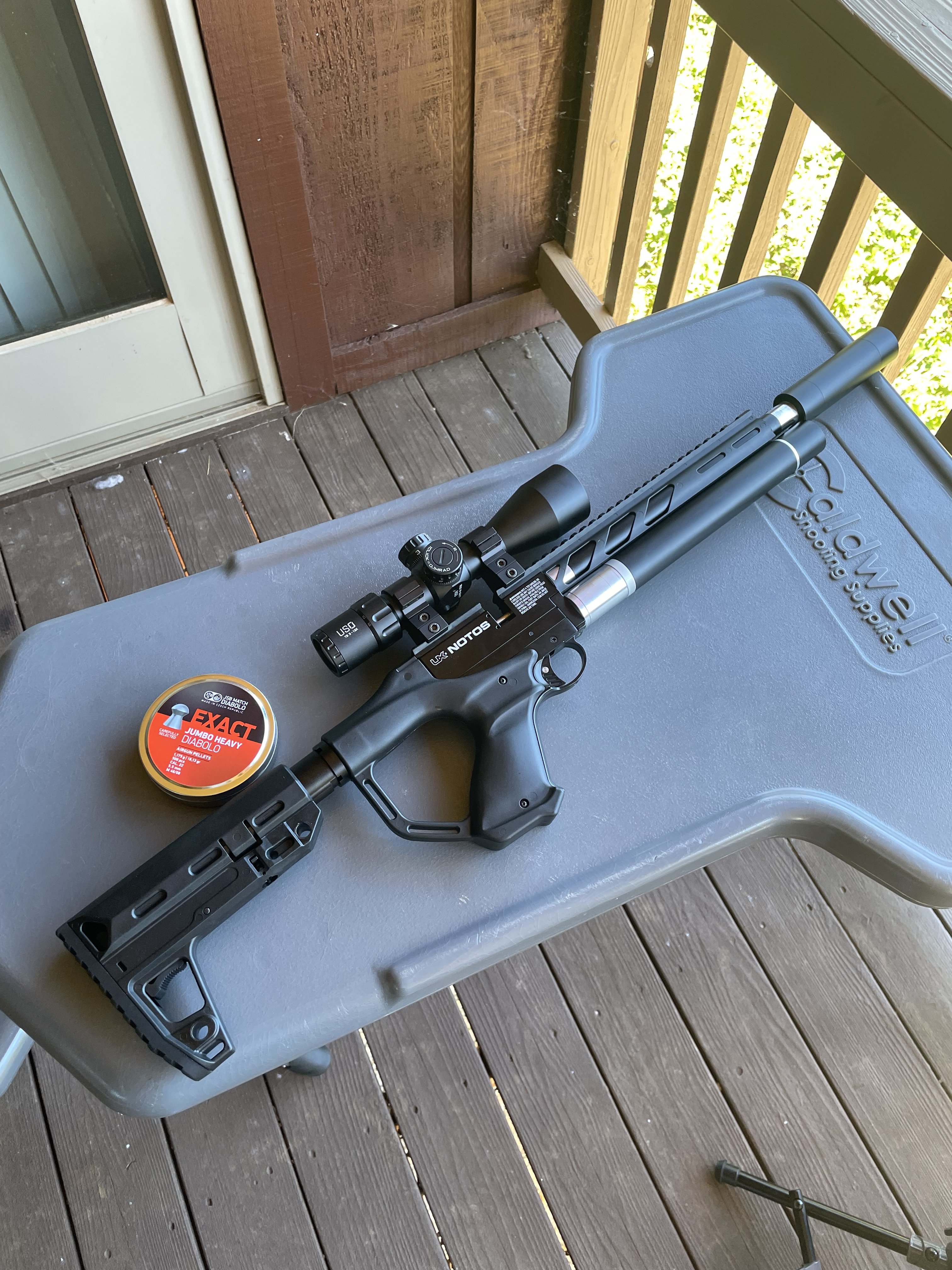

Yes... by completely replacing the lower and using a AR grip lol This is Buck Rails plan for the Notos. He will have a folding stock kit and use the AR grip on there. Link just scroll down for Notos article. I and another guy asked him in the comments why the stock is lower than the rail and he gave a good explanation there. I think with the magpul stock comb riser he offers it won't make a difference for scope height for CARM mag users.
