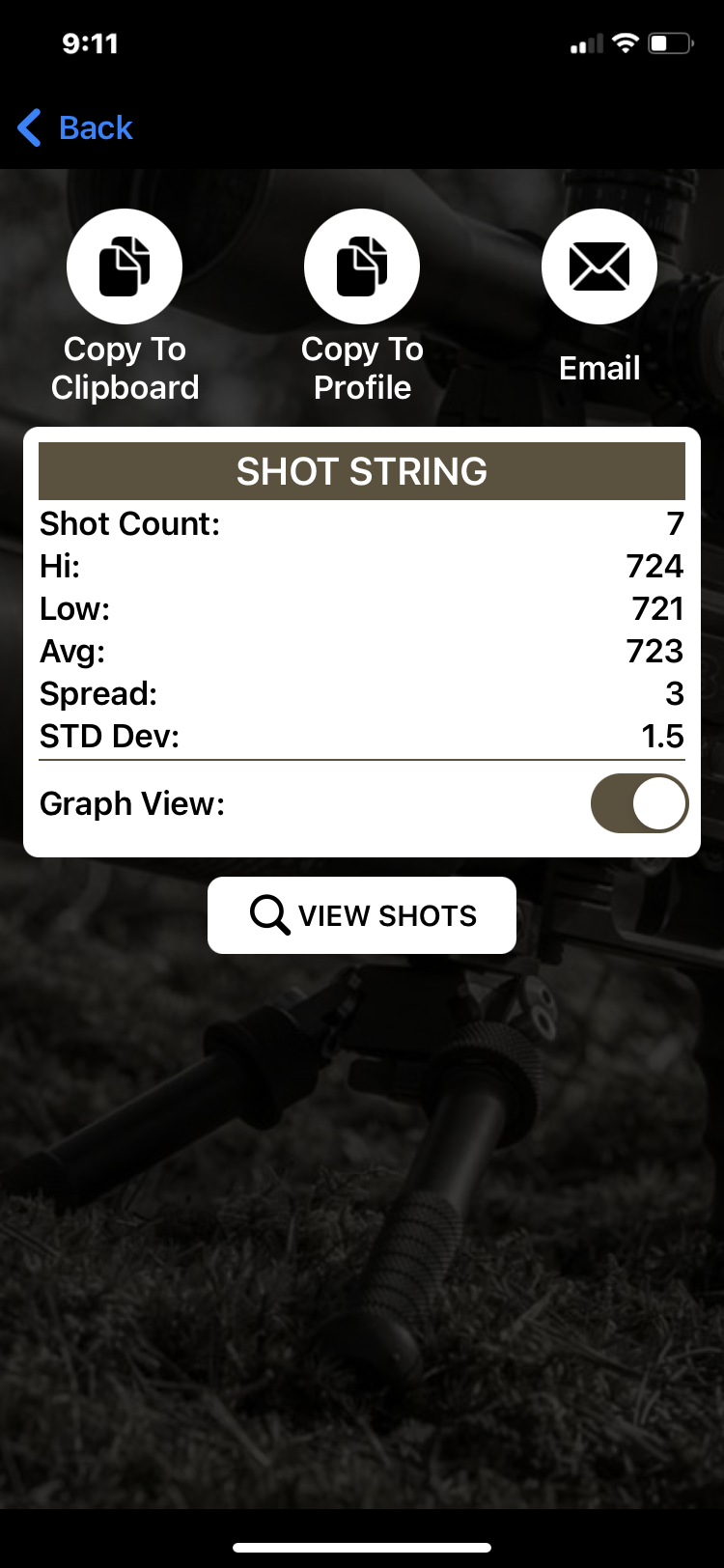

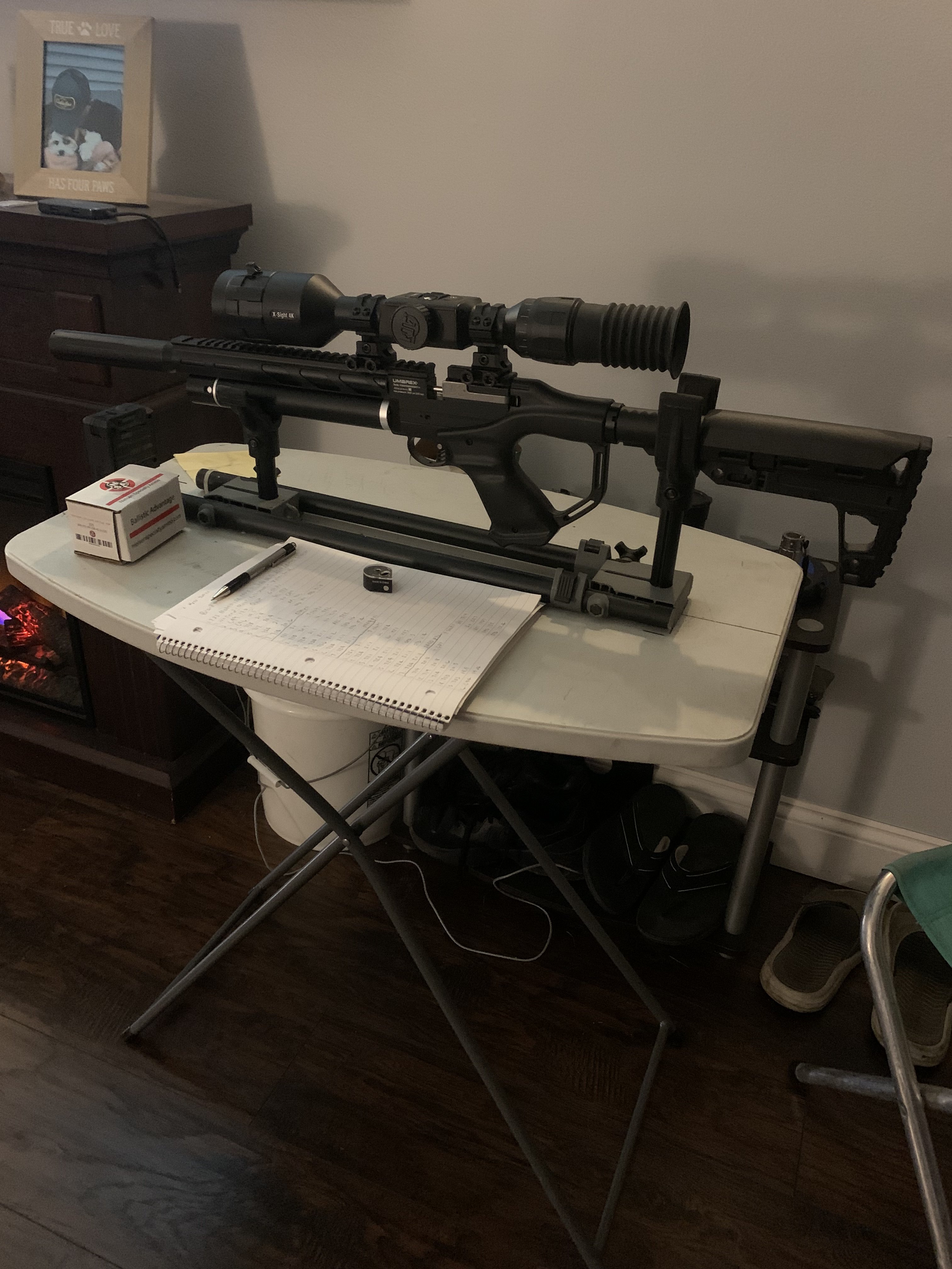

I received my notos today, this thing is awesome compared to the Jet 2 I have which had no accuracy whatsoever out of the box and is a work in progress. It fits and feels great! I had a problem with the second load of the mag too, but when removed the pellets and reloaded them all was well. I really like this one! Here are some pics and stats. These shot are only 13 yards indoors for now but the attached moderator DOES NOT NEED TO BE REMOVED! She is quite!!

Well 14.3 crosman premier I get an average of 775 with good accuracy with the .22 hyrids say 630fps with so so accuracy and with the 13.7 crosman domed I get a average of 779 with a good spread and STD but accuracy is off. Also I bet you can put a folding stock on this to make it more compact. I love this gun!! I did adjust the trigger for my liking it’s lighter to me.
