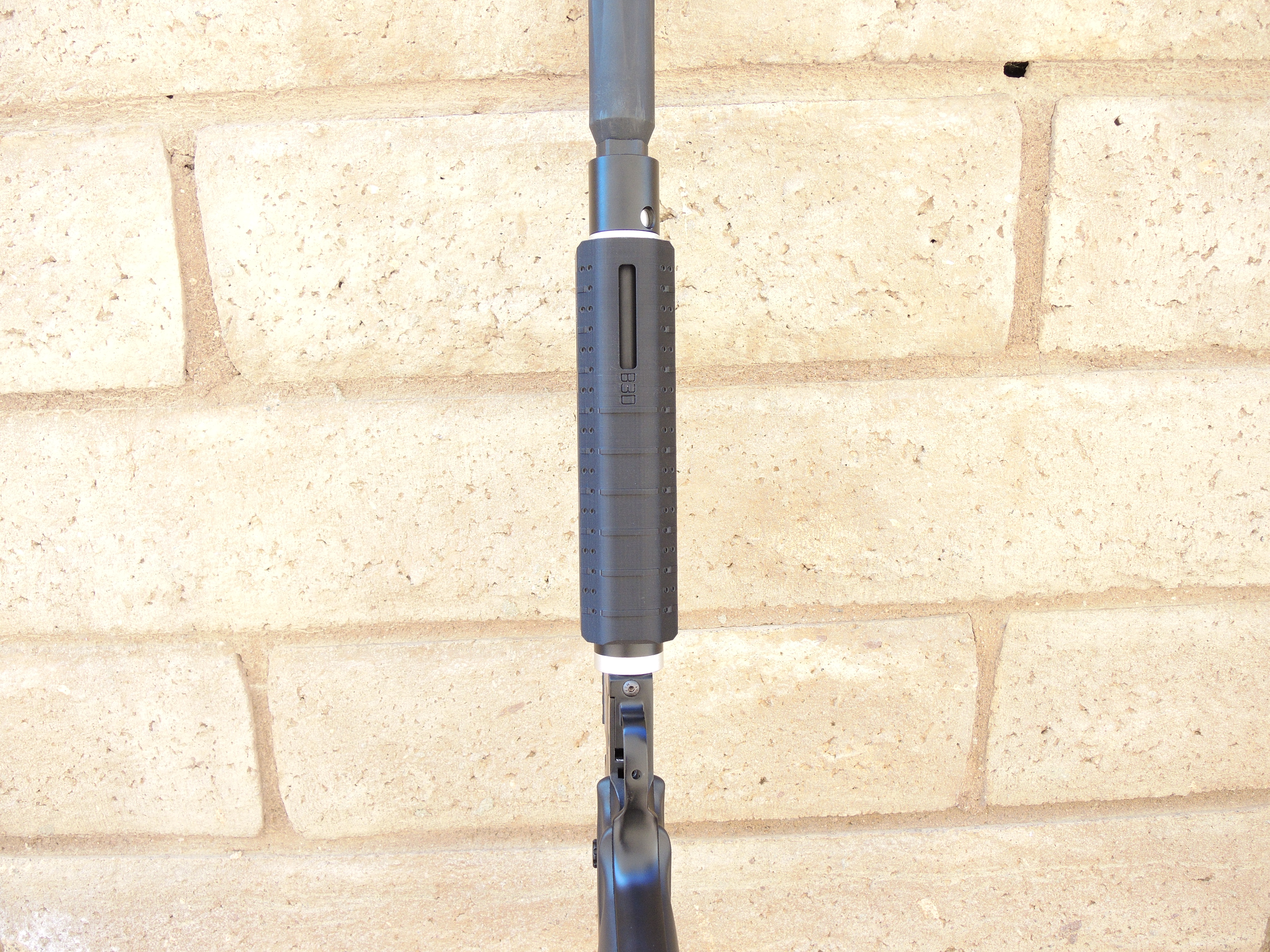

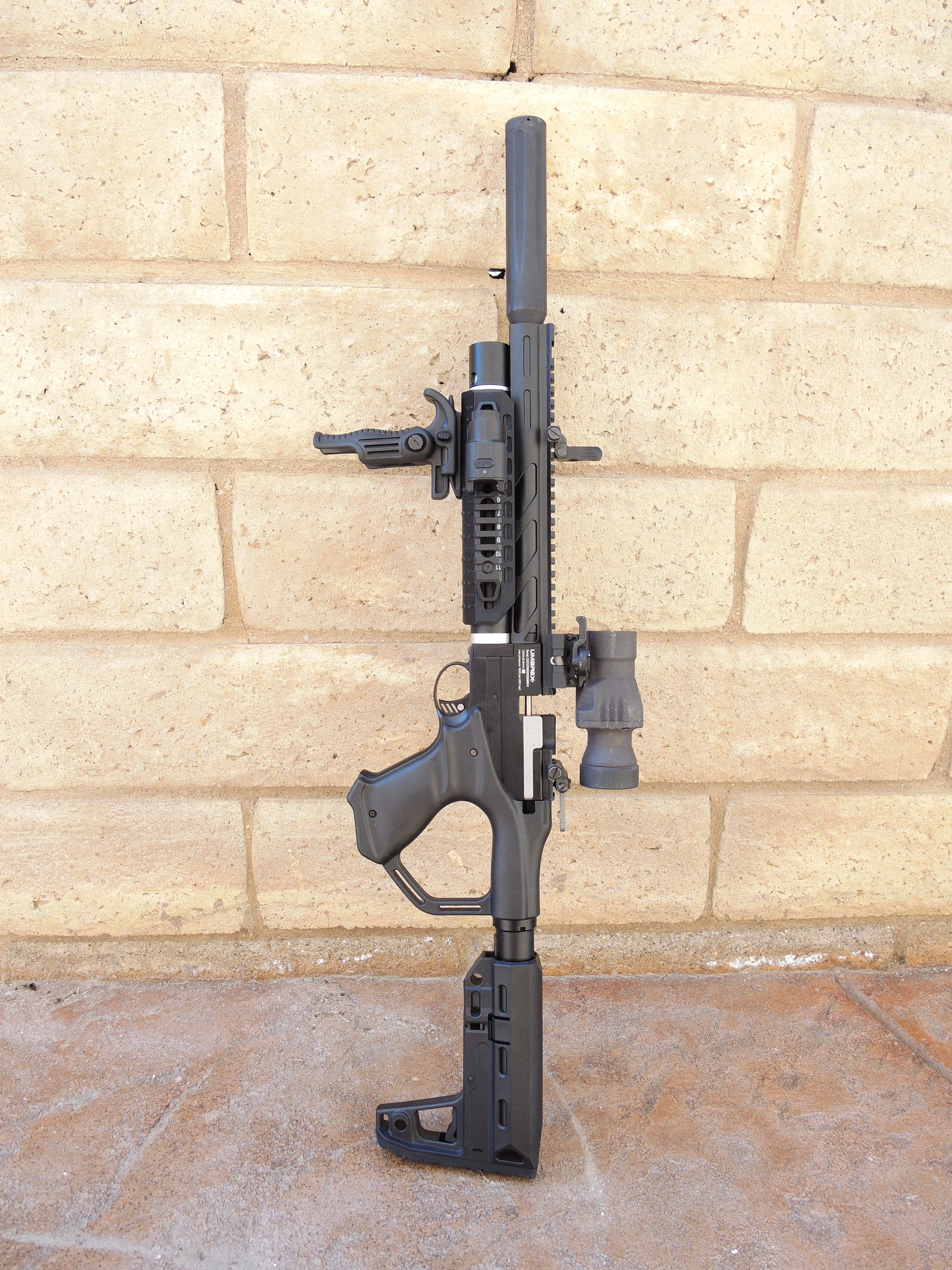

@Firewalker So What's going on in this photo? Is that an additional 3D printed moderator affixed to the factory moderator? I've been loosely following this gun this year and I like some of what I've been reading about it. I'm still not too familiar with it though. I've found some decent info on how to install the moderator from post #s 490, 512, 530, but where'd you get the moderator?
Where did you get the moderator? @Firewalker
Reactions: Firewalker
I carry the moderator insert as well as a screw on version by Big Air called the "Long John".
