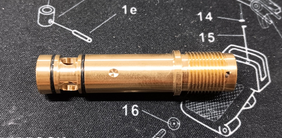

You may be able to get more fps by using higher hammer spring tension. Once the reg pressure reaches a certain level it will reduce dwell time on the valve and give a reduction in fps like you shows in the video. You can bring the dwell back up with more hammer spring tension. If you already have the stock hammer spring tension maxed by the adjustment screw you will have to change springs.

Yeah my spring was maxed out. Definitely if you're wanting more power/velocity then different HS and probably some porting is needed.

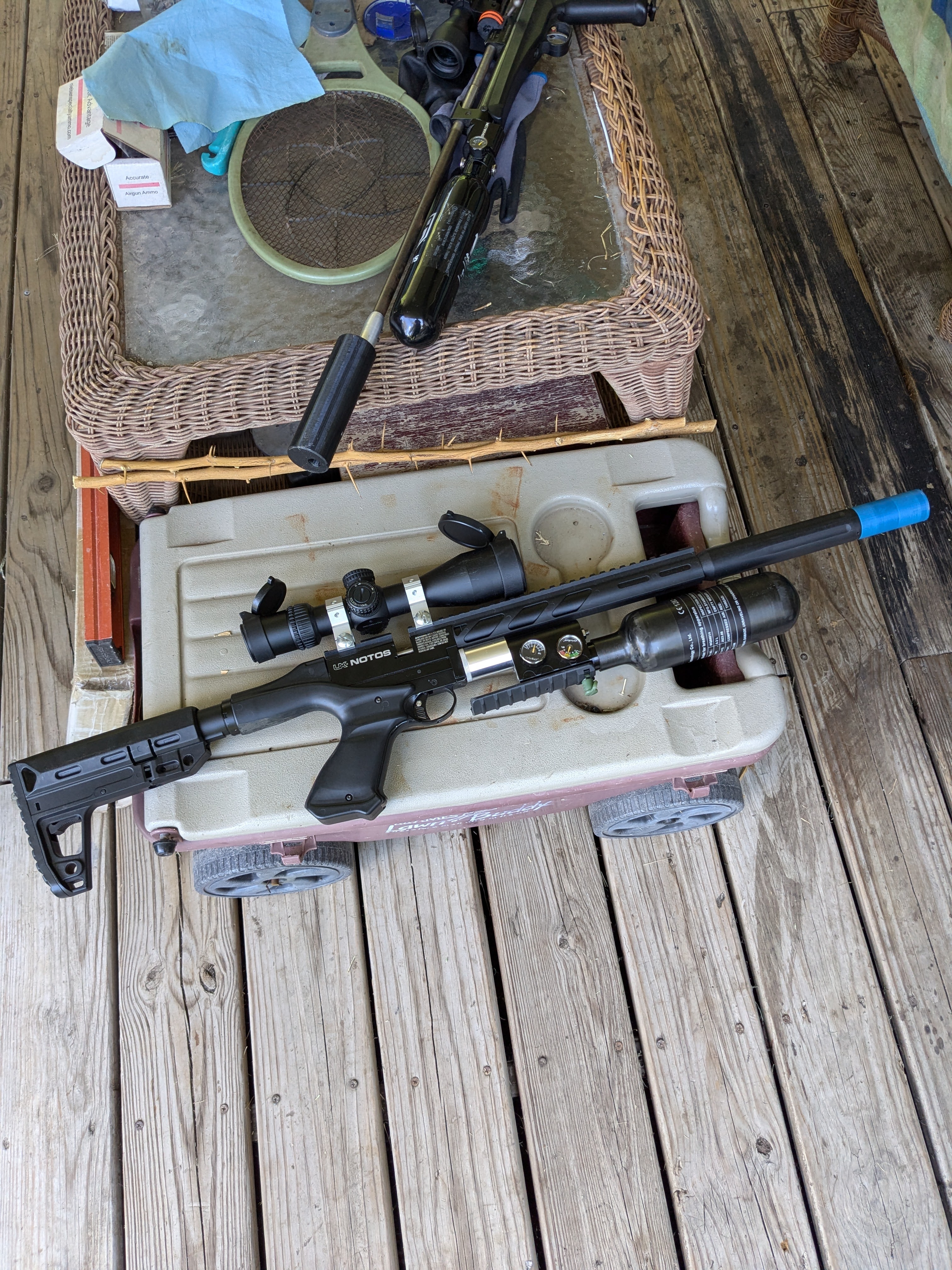

Mine is ported between bottle and reg drilled it to.177. so what size is it everyone else drill to? I also rounded up the old original hammer spring and installed it back. Just run 4 mags of 14.3 crosman hps. Stock transfer port. I'm backed all out on spring adjuster and showing 150b. What size TP is everyone drilling?

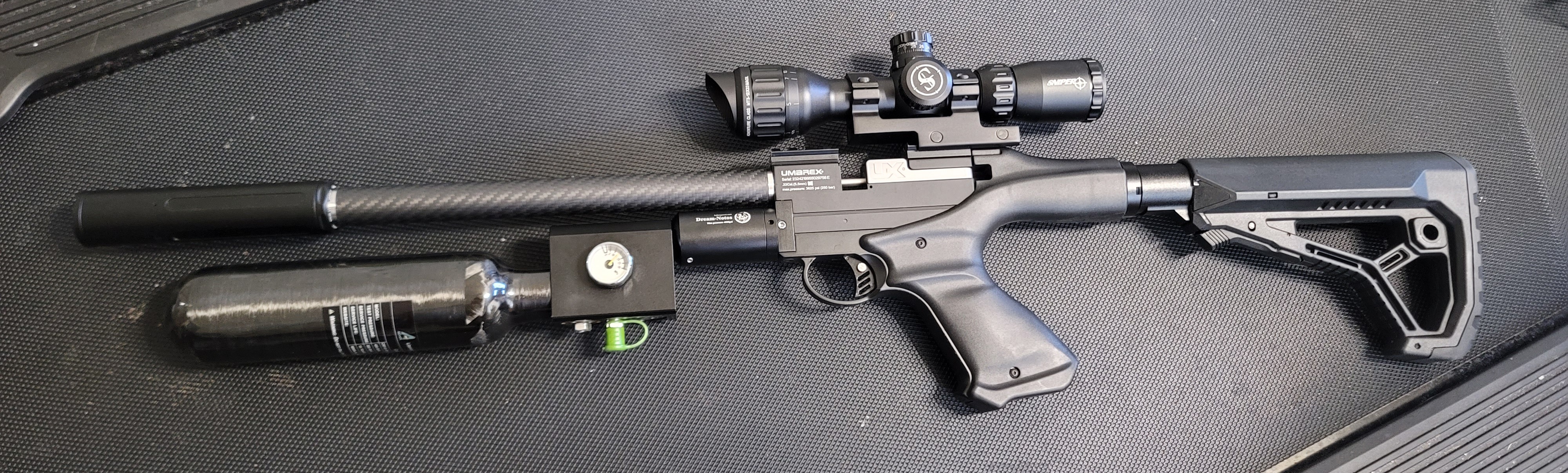

On mine, the ports are drilled to 4.2mm. The hole between the plenum and valve isn't drilled but rather milled... it's equivalent to maybe a 6 or 7mm hole. With the huben reg reading 145bar (which seems to actually be more like 155 when reading my trustworthy gauges).
I'm getting ~815fps with 15.9gr JSBs. Hammer spring tuned for max fps, which is about 1 turn out on the screw. Stock barrel but a half inch shorter.
