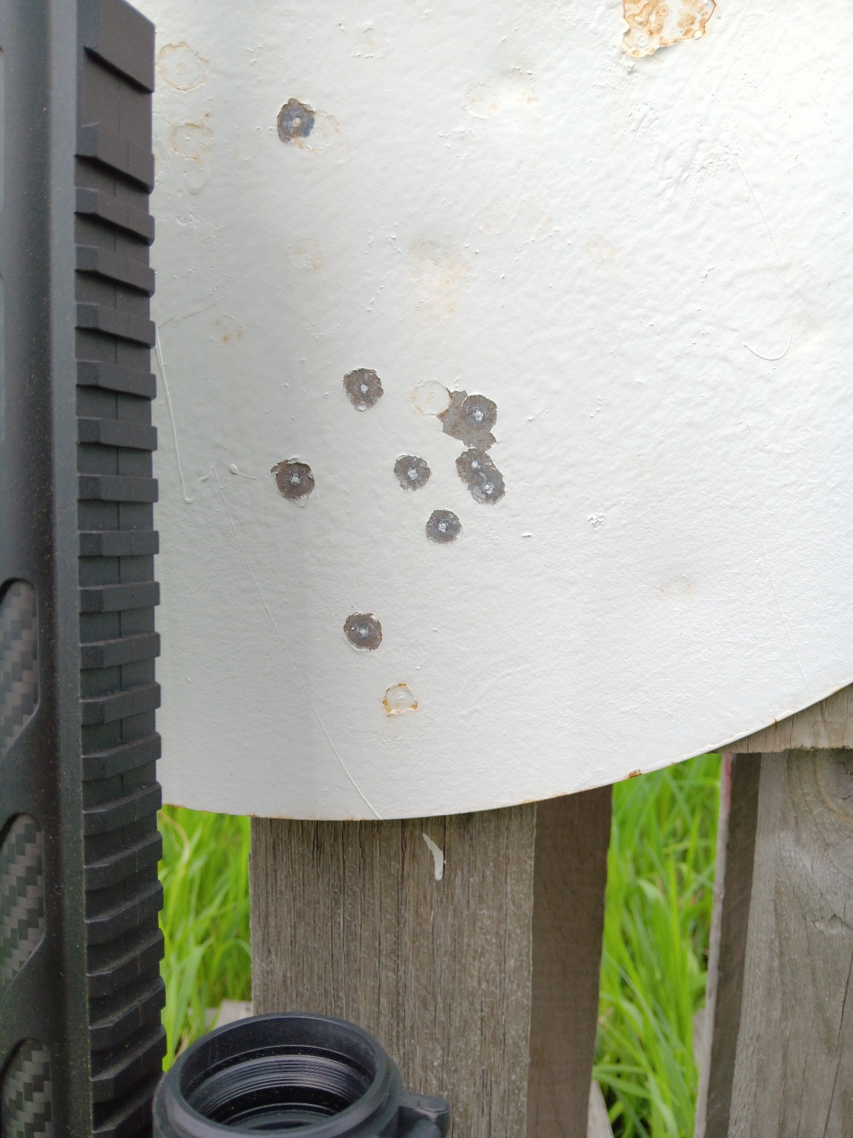

Yeah that's kinda what I was thinking but wasn't sure on how to remedy it. This is my first regulated gun other then an inline reg on a big bottle. And yeah I got eager and pre-ordered slugs when I ordered the gun and the 23gr did not like the stock barrel at all so did the 500mm kit to get the slugs to fly right. Good news tho I guess, the 23s are same hole at 30 going this slow.
The stock barrel is actually pretty good.
It's a 1:22 twist which makes it so accurate with 18.1 gn pellets or less. But, due to the low power It's appreciable range is about 40-50 yds max. I don't shoot it much because it's so underpowered and my desire is to shoot farther.

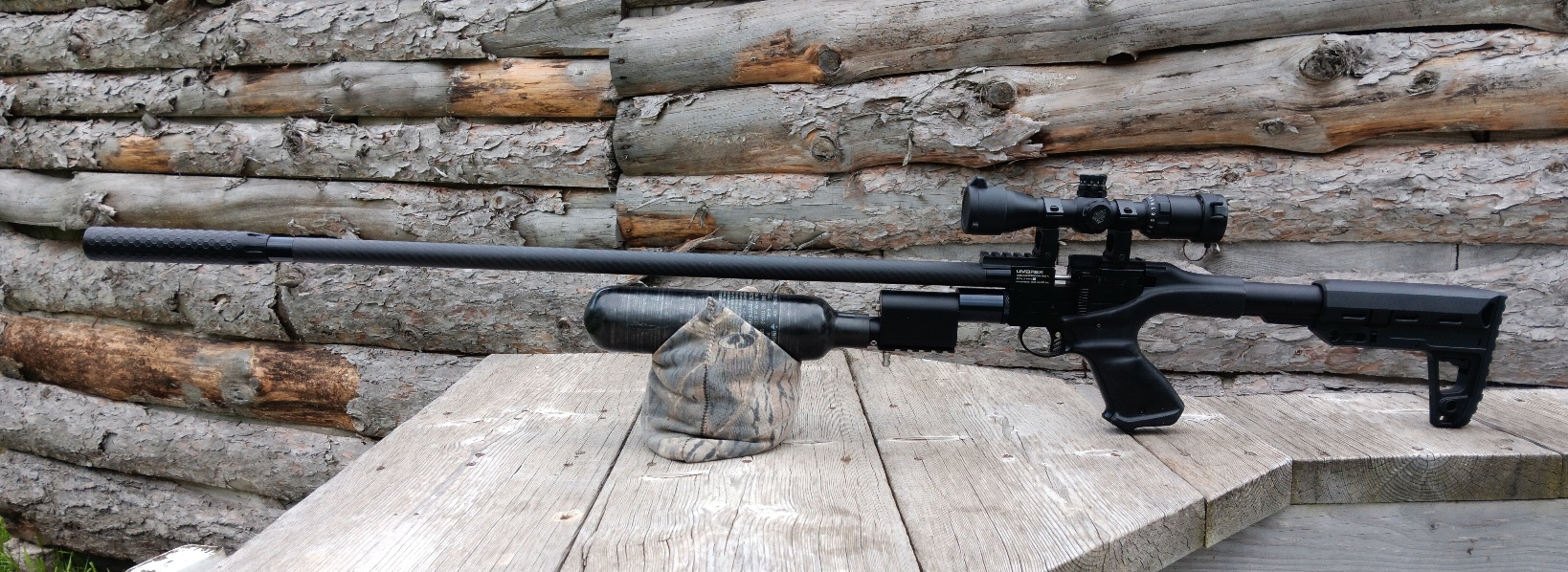

I've been working with c88machining to develop his kits to be as efficient as possible but with a stock Notos, you don't have enough air being released to overcome friction, thus you get slower speeds.
Herd is my kitted out 700mm FX barreled, fully ported Notos, shooting 14.39gr at 1050fps.
