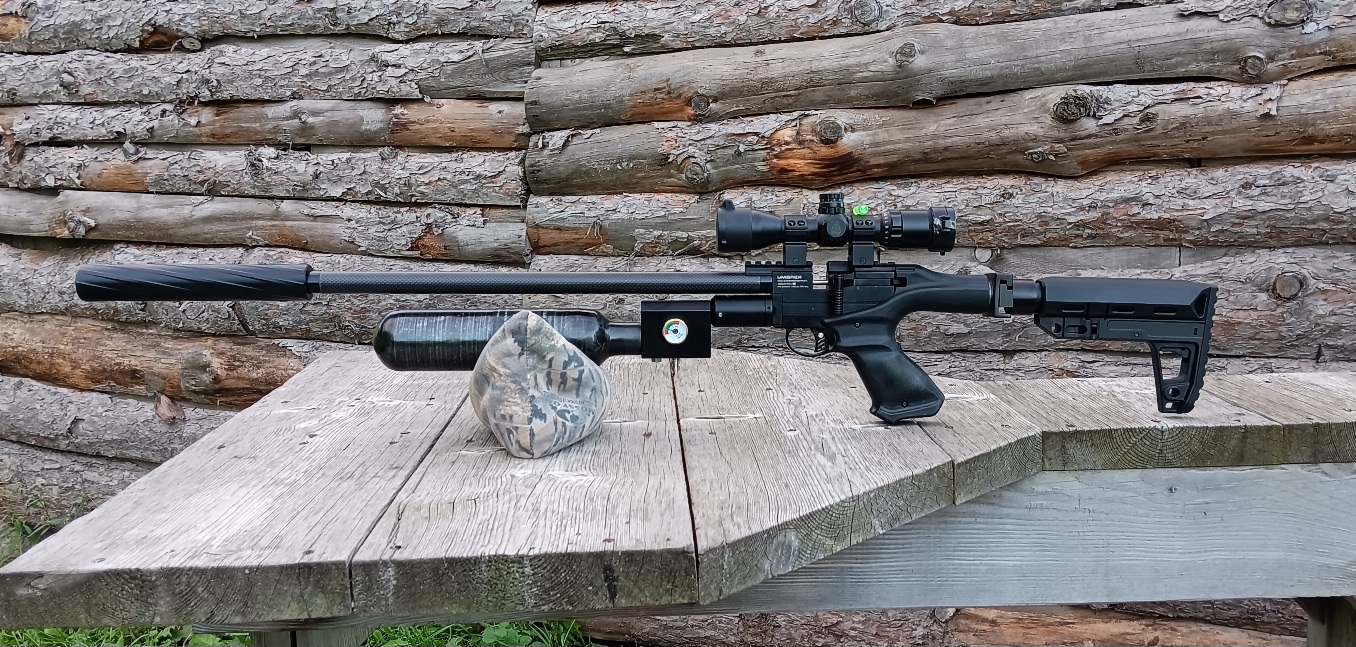

Quick question, any body have any experience with modifying the return spring on the umarex Notos poppet valve? Im trying to maximize volume of air (extended barrel) to push some slugs hard.
Any suggestions on a good replacement spring?

I'm actually getting the porting done now. Btw is that a 700 mm barrel on your Notos? If so I can you DM me where I can get one?
