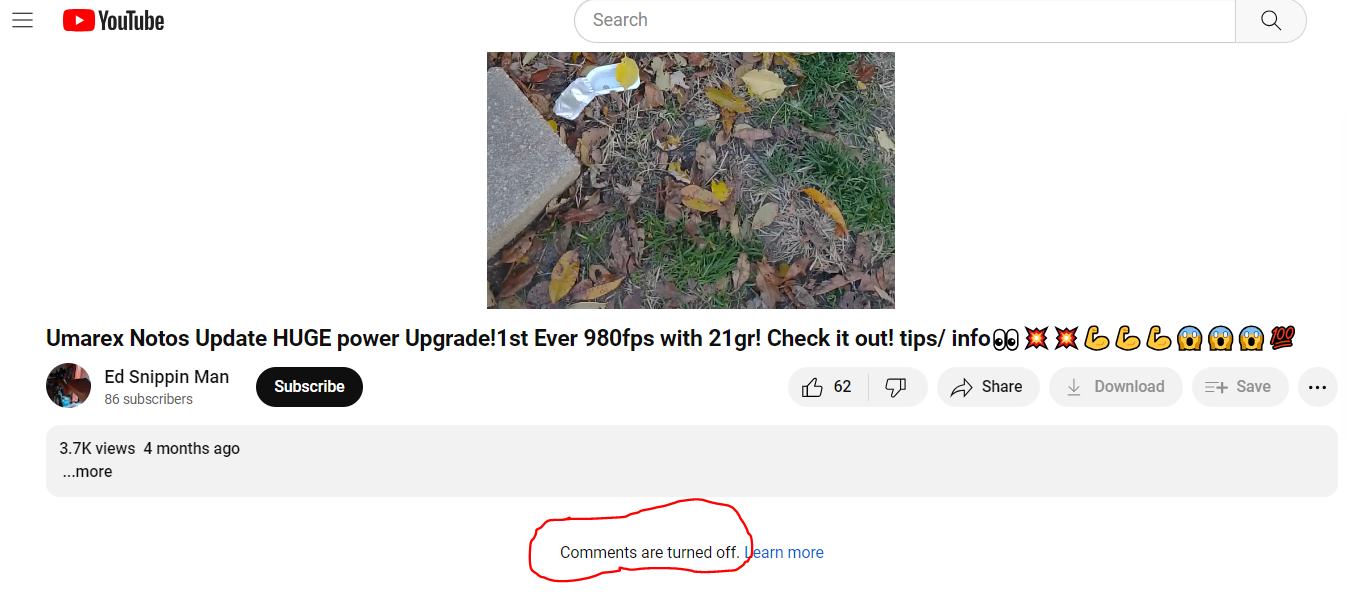

Umarex "Umarex Notos Update HUGE power Upgrade!" Or is it?
So $980?… Thank you for your honest assessment…
Give or take, again I spent about 100 on a bottle cause I lucked out, could've been $250 instead. And none of this is mentioned having someone port the gun for ya. If you can't do it yourself that is. I believe @Firewalker charges anywhere between 300 and $350
I'd say that's about right.

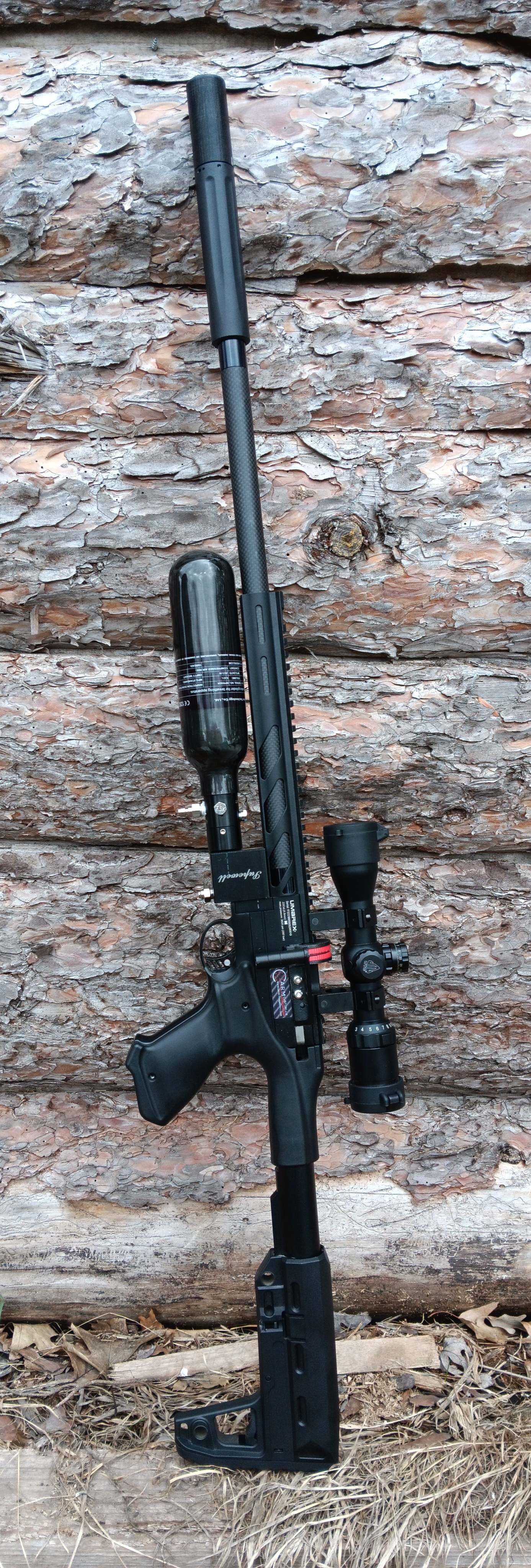

Not sure if there is a better location. If so, tell me. However, I designed this up while Firewalker was upgrading my notos. Here is a picatinny mount that clamps around the barrel and .22L bottle with two 3mm screws and nyloc nuts. I tested it out yesterday with my pic to arca adapter and arca bipod. Plenty sturdy. I used proto pasta CF filament.
Files on Printables

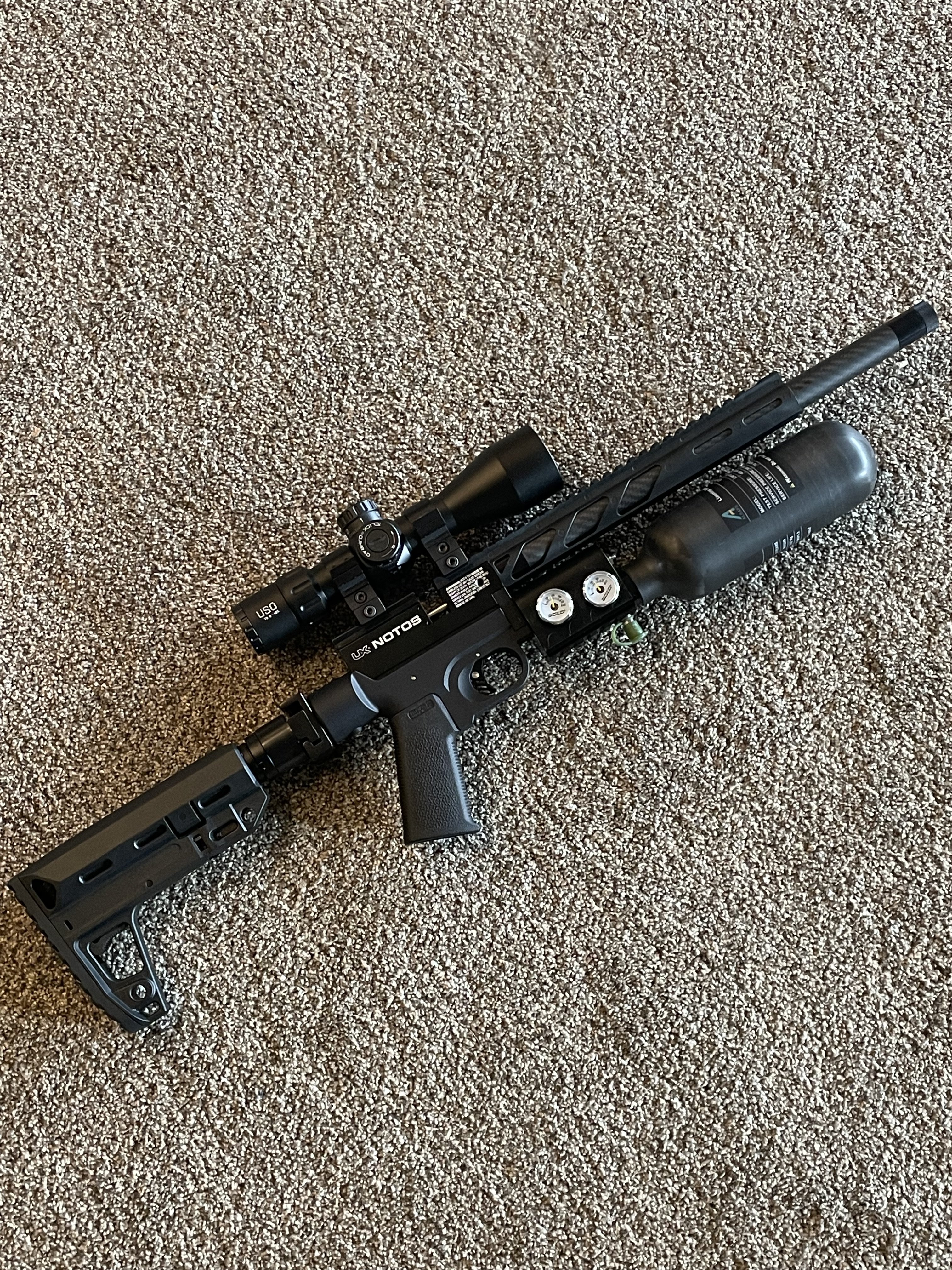

Update! Actually love this gun bone stock! I have a wicked rat problem living in the City, & Jesus these things don't have a chance! Only upgrads thus far are on the the optics end. But this thing is perfect for dispatching rodents quick, quietly, & efficiently! That being said I may keep this for just that alone, as well as it's lightness my Girl has no problem tossing it into a back pack.. (Oakley Kitchen Sink) that is until I get the folding stock adapter... I actually ended up grabbing an FX Dreamlite compact in 25 cal for my "power" needs for now.. FX.. I know.. but the sale allowed me to snack one up for just under a Grand.. I do like it, but modding FX is like throwing $ down a rabbit whole lol. Still loving this Notos for what it is. As well it's good to know that I can always add more power & customize it when I'd like.. winter is coming up so plenty of time for that! Just would like to thank everyone here who's helped me out via advice, support & most importantly, your time. I'll be back here shortly after some more upgrades with new updates on progress. Thank you all! -SF

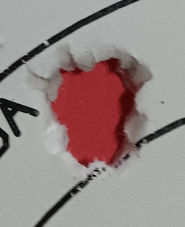

I'm up too 800 fps with no porting thanks to C88 and his FX barrel!
0.159" center to center 20 shot group.

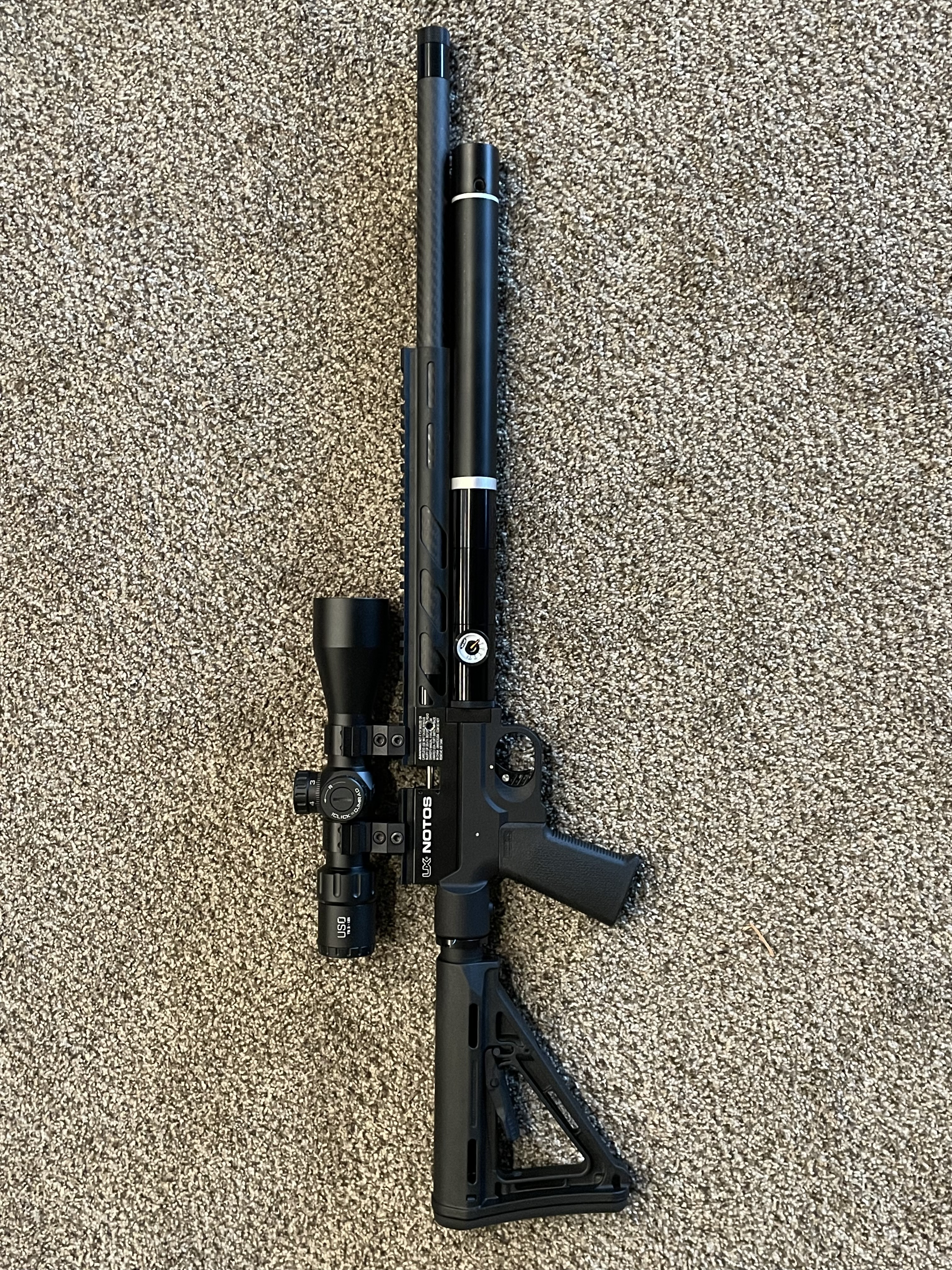

The old girl has been dismantled, parted out, ported and sold. So long old girl...
