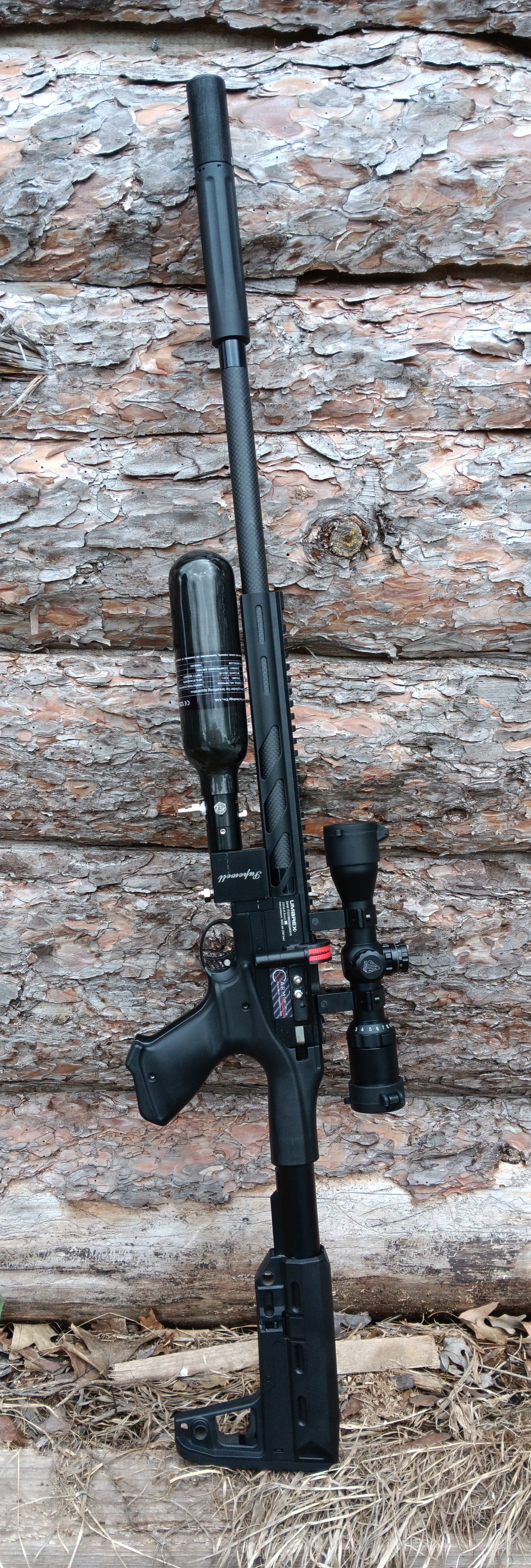

I hit 800fps with CPHP's with no porting at all with C88's FX barrel kit today!
WHOOT!! He is also the bloke that's shooting 18gr JSB's at 950 from his Notos.
It's a good day to own a Notos!
@Firewalker did you get the 500mm kit?
Nice looking group!
That looks as long as the Zelos! Maybe it's just your extended moderator... Speaking of which, how's the noise level?
Yes, it's the 500mm kit. I'll bet it's longer than the Zelos but that's OK, this is all about potential!
I chopped off 8-5/8" off a 700mm barrel to get rid of the choke, I am dreaming about slugs... 🤩
(Don't tell anybody but Im getting a prototype 700mm kit too!)

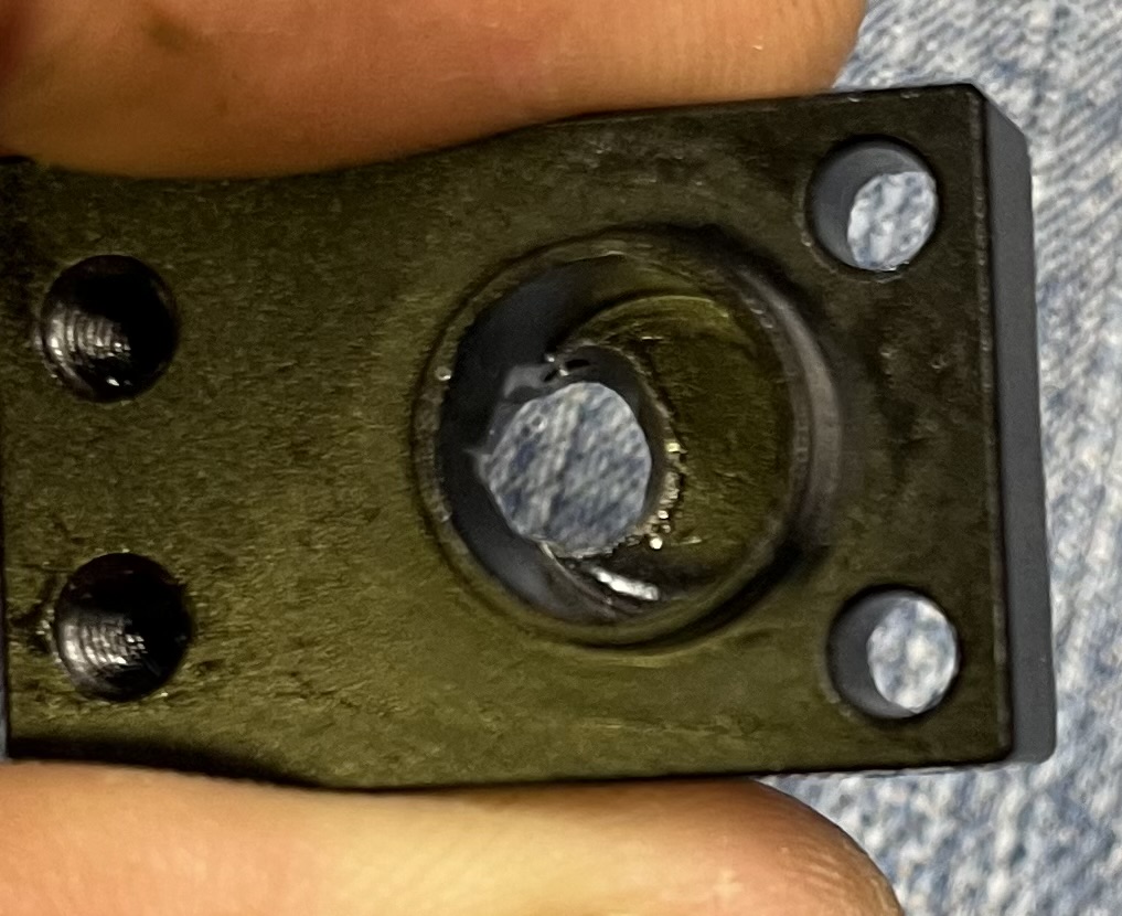

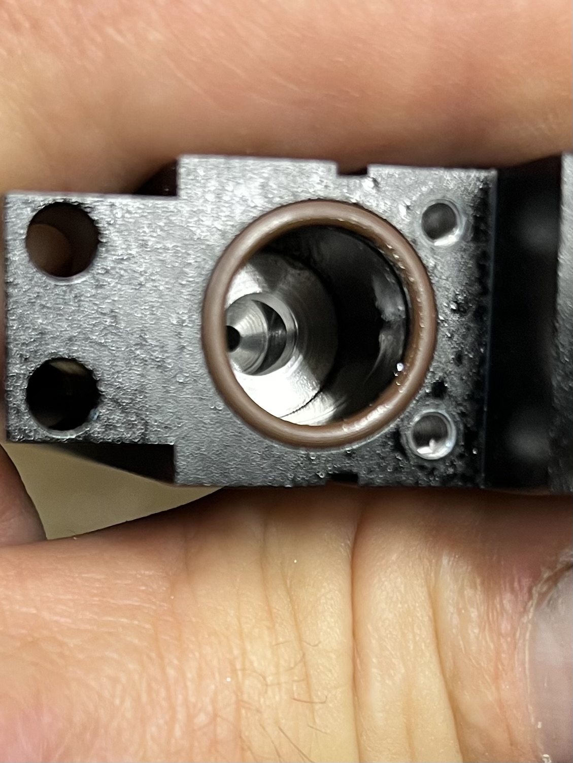

I’ve had a chance to do some experimenting since we’ve had all the rain/storms around here, I’ve had some inside the shop time.
Opened transfer path to .213”
Opened barrel transfer to equivalent

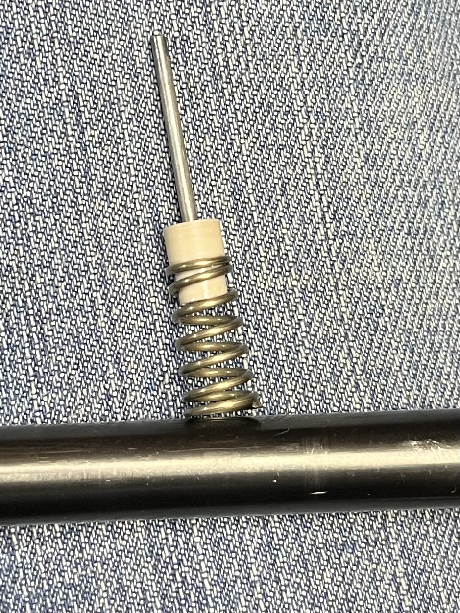

Moved probe shoulder back and thinned
Made a flat seat valve w/peek poppet
Poppet stem .078”
Factory valve spring
Opened up the tank mount path
Transfer path required tapping bottom drill plug for 1/4-28 and making a new screw, the same oring was used here.
I set the factory reg at 2600’ish checked via the bleed port.
2 coils clipped from stock spring
Bored hammer then added back plastic spacers to make adjustments and lighten hammer. This thing barely has any hst adjustment travel.

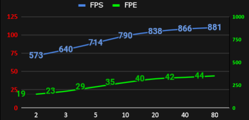

Stock tank with no added plenum
14.3gr @ 960 (cphp)
25.4 @ 784 (Jts)
Comes off reg after shot 5
Surprisingly consistent

Is it possible to remove the barrel without discharging the plenum?
Yes, this build uses the FX system where the liner is rifled and the barrel is for tension and is just a threaded stainless steel tube.
The liner removal is the same with the Notos 1 piece solid barrel and the FX liner kit.
Remove the 2.5mm buttonhead screw from the picrail.
Pull the picrail off the gun.
Remove the 2mm grub screw from the receiver (it's right under the buttonhead screw) and pull the liner/barrel assembly straight out.
No degassing etc. Just make sure the lever is not cocked.
