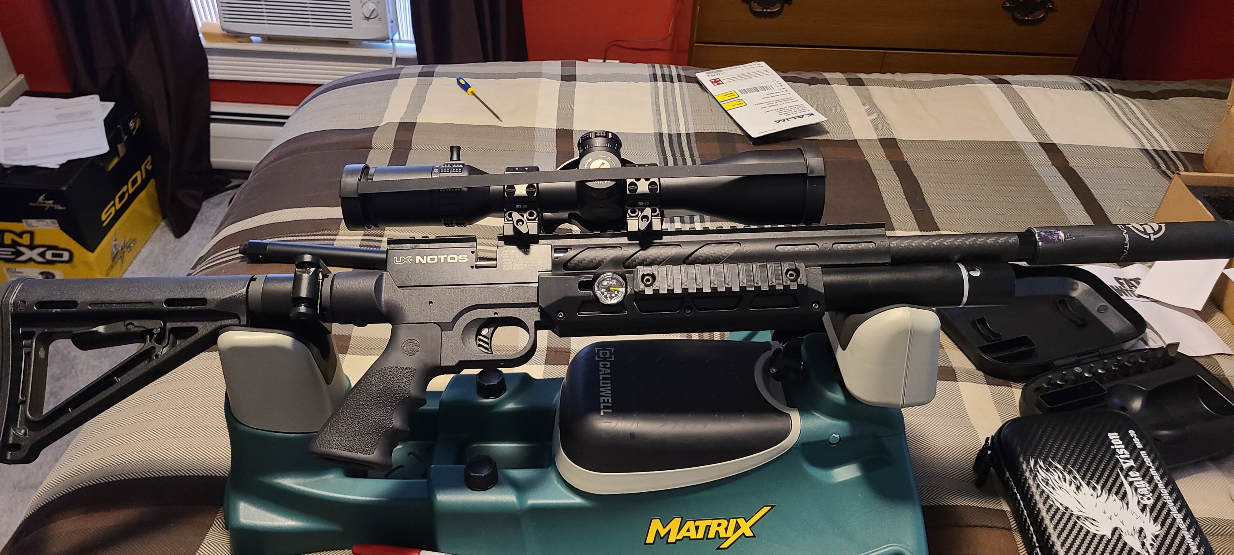

So Firewalker cut and crowned an FX liner for my 380mm barrel kit from C88machining. I also ordered c88's plenum and plenum extension. I already had a gauge block from Wes @ Airgunarcheryfun.ca and decided to keep it on there.
Man oh man, it was close to not fitting but it fits.
Moderator is close to the airtube but doesn't touch, about 1mm of clearance.
Overall length is now 36-1/2" as I use it with the stock extended and a Donny FL Tanto on the end. And it still feels light!
It weighs, as you see it, 5lbs 1oz according to my kitchen scale. Scoping it will put it over 6lbs but will be worth it.
Here is the kit laid out as I got it from Firewalker after he cut the barrel and assembled the kit for testing.
He and c88machining both did a great packing job on the parts.
Just did some testing and it looks like I gained 50 fps while still having 4mags before I drop off the reg. Nice!
CPHP were doing 825fps for 21.6 FPE and are now going 875fps for 24.32 FPE. H&N Slug HP .218 were going 675fps before and now are going 730fps.
Without a re-zero while doing chronograph testing, I was hitting my spinner about an inch up and to the left.
Finding accuracy should be a breeze.
Famous last words, lol.

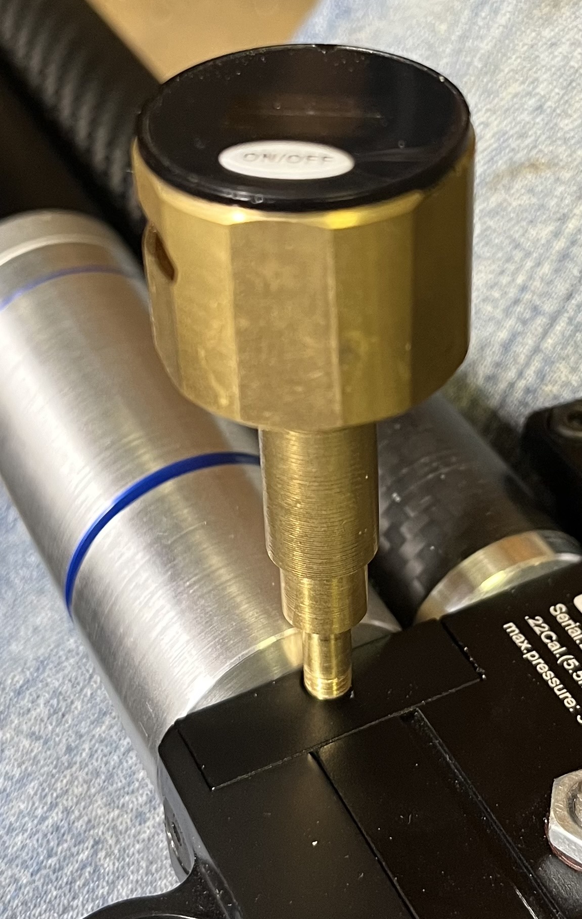

i have a question it looks in the picture that brass piece with the transfer hole only has 1 hole in it any idea what they call that or where i can get one as mine has 3 transfer holes

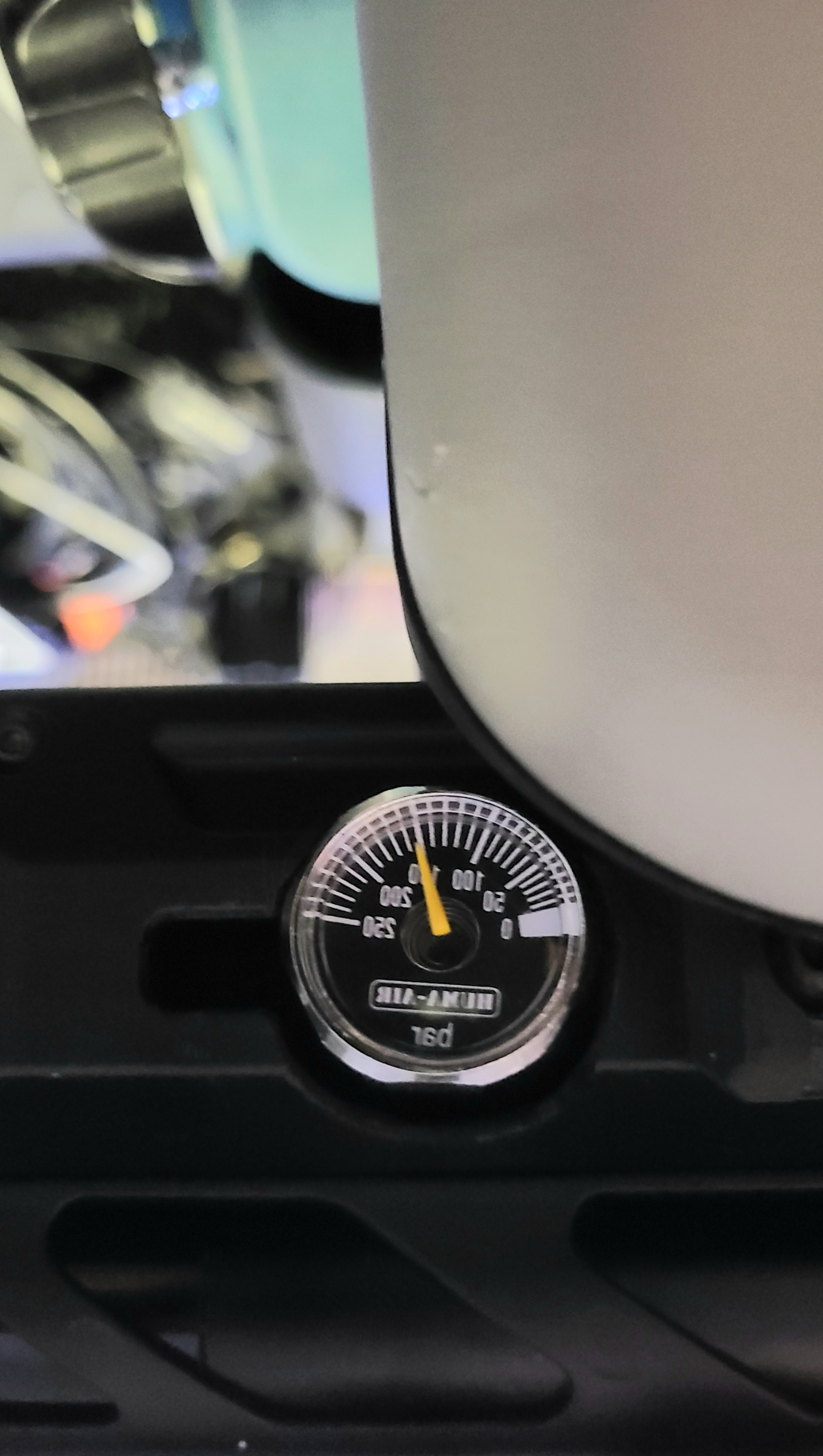

I like how the huma psi gauge fits ever so snug in your setup! So let me see if I got it right. Please correct me if I'm wrong:
1.Buy the FX 380 barrel and liner kit. (Is it plug & play without any modification) *if not what's exactly involved to make fit/work?
2. Go to .c88 machine's store on eBay to buy the plenum and plenum extention with gauge port.
* Again what entails modification?
Apologies for all the questions I've never did much of my own work on pcp's. If we were talking big bang sticks I could still most likely disassemble/ reassemble Armerlite, G19/17 or even a 1911 blindfolded still lol. But old-school Fun-Smithing helps me like tits on a Bull when it comes to these things. I do still have all my tools measurement vernias/calipers. Also a nice laser guided drill press as well as files and different kind of torx, Allen,and all the other bits Phillips / flathead. Chapman sets etc. wish I had a Bridgeport & lathe...
Another thing I saw on your picture if you could explain what you got it the side picatinny rail. Did you go to a place that begins with buck for that and it looks like you have a folding stock as well which I'd like to get. If I could get mine looking and performing as yours does I'll be one happy Hunter 😄 Thanks again for your time, help & support.

yep, the barrel kit along with the plenum and plenum extension with gauge port from c88 machine on eBay
then you will need the fx ,22 380 mm liner pyramid was out so i got it from Utah air got my Notos from them as well.
as far as the plenum and plenum extension goes
you need to dump all air pressure out of the gun
then with a firm grip unscrew the air cylinder off the gun have some silicone oil or grease for air rifles just to lube the o rings
once you unscrew the air cylinder lube the o ring and screw the plenum extension on to your cylinder just hand tight
then the plenum extension you need to install one o ring lube and install and then screw into the plenum extension
then install on the gun you will need some Teflon tape for the for the gauge as there bsp thread
DONT..... install the gauge until you install the air cylinder as you won't be able to install the cylinder with the gauge mounted.

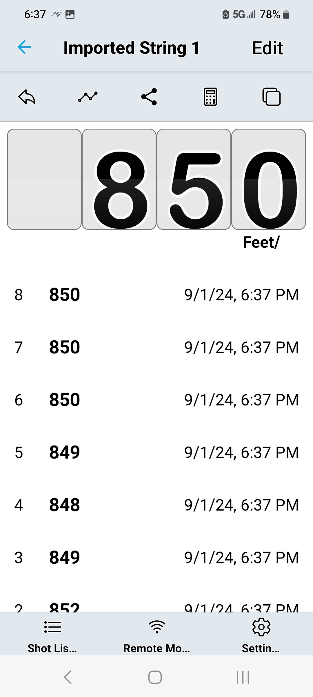

Shot another string today with
16gr Hts hp
