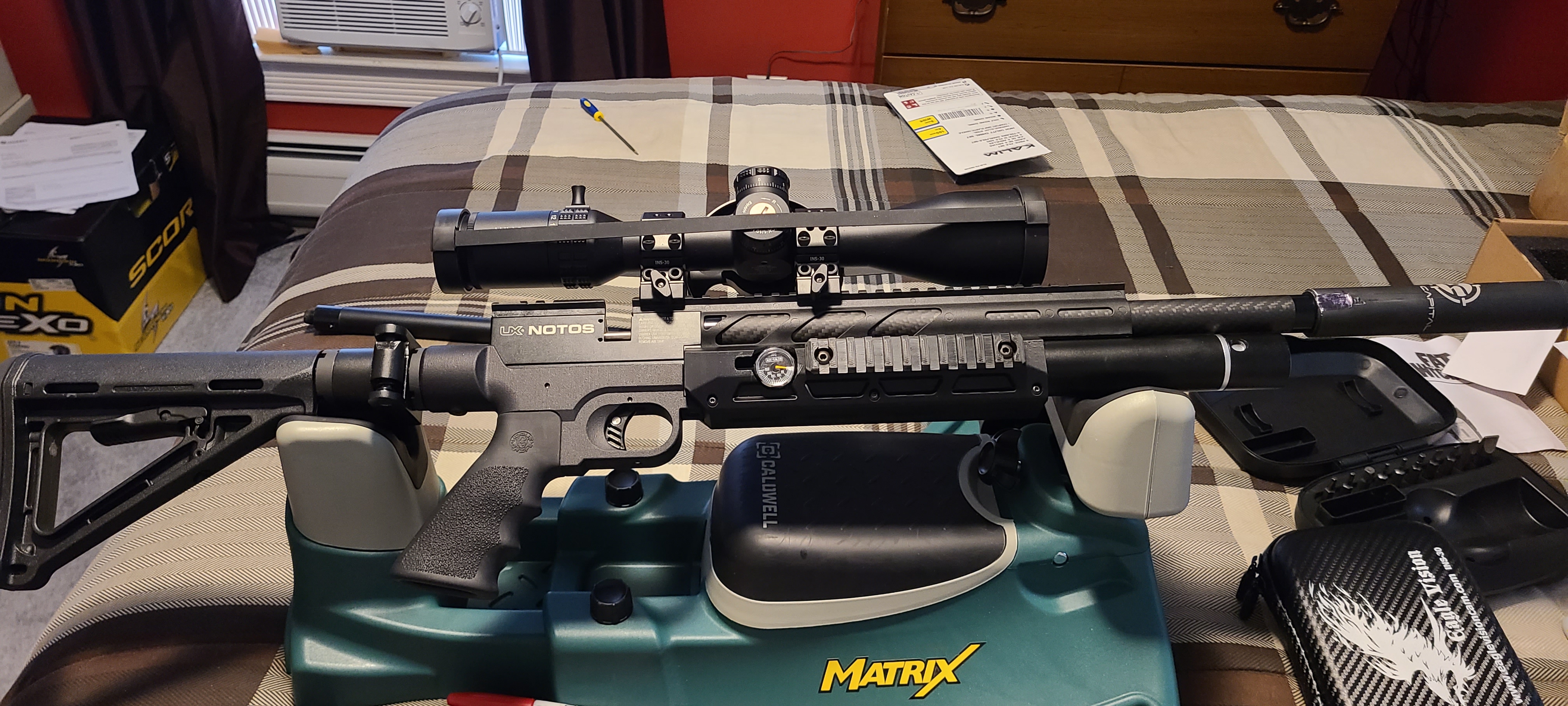

Umarex "Umarex Notos Update HUGE power Upgrade!" Or is it?
This was the 2nd string of shots reg 150 bar 380mm barrel plenum and plenum extension stock hammer settings A/C moderator
Couldn't be more tickled with the outcome
Special thanks to this forum
Ànd C88 machine for all the excellent work in craftsmanship
Very sweet set-up! & The number are incredibly consistent! Definitely reaching out to C88 Machine to try & get mine done up like that. Need same body kit that your running as well so I can fold the stock & for proper lighting/Laser load out. What company did you get that from? Not sure if I asked that question. Also the mags... Maple or charm? Thanks again -SS
Oh I thought I remember you saying something about needing a chronograph.. looks like that one is working quite well. But if you'd like the new Garmin ballistics chronograph I can get a 15% veterans discount on one. Believe they're around 500 bucks or so. I was debating about getting one but I settled for the old school long won you shoot through with the two light bars that you need to plug in if you're shooting indoors. Only spent about $150 on that. I'm sure you have something better than the one I have. I forget the name of it at the moment but it has a digital readout/out loud in the front & about a footlong, gray with two metal antennas sticking up from each end.
@Surefire , what is your fpe goal again? I think you mentioned 40fpe. If that is the case, you may need to open the gun up to breathe a bit better. I think you you mentioned you didn’t want to do that but it’s not too difficult.
Dave
Yes Dave 40 consistent Fpe would be quite nice, the more the merrier 🙂. Yes i was contemplating about how to make this kind of powder. Shout out to @turbocoupe88 for has been great by helping me understand how to do the .22 FX STX barrel & who to get plenum mods from. In Truth I have done a a whole bunch of tunning with umarex's .68 & .50 paintball/marble shooters getting pretty good #'s. Infact I got over 4o+ joules of power from my HDX shot gun. But that was before my accident. I mean I was already injured from my days as a Marine (3½ tours in Afghanistan), but refused to go on the Va's disability. Started paving Driveways by hand for a few years until the owner passed away. Than I entered the laborers union 10+ years ago, became a foreman the last 3-4 years of it, than I was atop an 8ft ladder @ Deer Island ripping a drop sailing down and then moved on top to the wall that needed to be taken down. Than a few wacks with that of my mini sludge, & felt like the god Zeus hit me with a lightning bolt. Thus waking up on the floor. Needless to say my hands don't work as well as they did. (Have a tremor & they get numb, hot, & tingly/pins & needless sporadically.) Surgery has been recommended for my couple of cervical herniated disc's. But I am pushing through. So that's why I was a bit reluctant to open the Notos up... But as long as it's not super hard I'm down for anything! I already have a few big bores, but with this new injury makes em a bit heavy & wanted a nice light, small, yet powerful & accurate backpack style PCP. Was going to go with an FX compact Dreamlite, but even with the sale that's going on this weekend still going to be over 1100$. I started reading on this form everything that can be done with this particular gun so I went and ordered one of course with modifications in mind. Any & suggestions are welcome! For this seems to be a very good form and everyone thus far who's commented has been very nice and super helpful. So what do you recommend I start with? For the package came in yesterday and I haven't even opened it yet...

used that calculator that you mentioned and shooting these H%N 16.36GR looks to be 26.25 Fpe 40 holy cow not sure about that
i would say Firewalker and sb327 would be the ones to ask about that i would say some port work etc need to be done im still green to pcp guns but learning
i wish i had a notos main body id cut it in half with the water jet and take a look at the ports and port wall thickness
I'm pleased with my results i may back off just a taste on the reg to shoot consistent 790-800 fps
i get 19 good shots i use maple leaf 10 shot clips they work flawless there are other ones as well
the body kit is from buck n rail hand guard rails folding stock does nice work as well
look forward to seeing your build good luck
Reactions: Surefire

that sir is some info i was looking for i was not sure how much air was needed to increase the fpe
as i did buy a couple different regulators to install a small maybe 200-300cc bottle
but i also like the slim design with the stock air cylinder with plenum extension's
if i could get 28-30 fpe that would be my goal
but if it has to be bottled to get 20 shots at that i can be humble at 26 as i like to plink and small pests
these pcp guns are a new sport for me i like the adjustability and the accuracy is amazing

that would be stepping it up to the next level 28-30 fpe is my goal 40 that's too much for my application nice but not needed my Huben is for that.
im just looking to get 2 10 round clips at full power was not sure if i needed to bottle for that i bought the regulars just in case
but was trying to do it with the stock cylinder plenum and plenum extension
can you screw 2 stock cylinders together? does anyone make a brace to support it?
that id be interested in doing
Reactions: Surefire

im just looking to see if i can get 28-30 fpe 40 to much i used a calculator came to 26.25 fpe,, just trying to figure to increase to 28-30 what it would take
hammer spring and setting is stock airports stock adj the reg to 150 bar so 2170 218- psi from 1900
just makes me wonder even though you raise pressure but no more volume
seems like both need to be increased as there seems to be a fine line between volume and pressure balance or am i thinking wrong?
