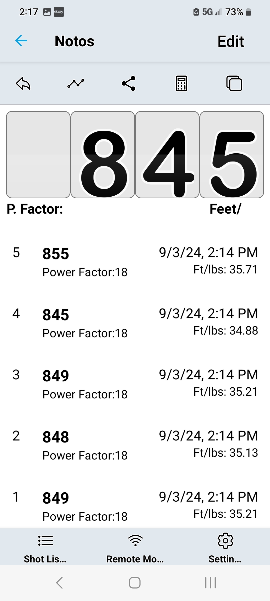

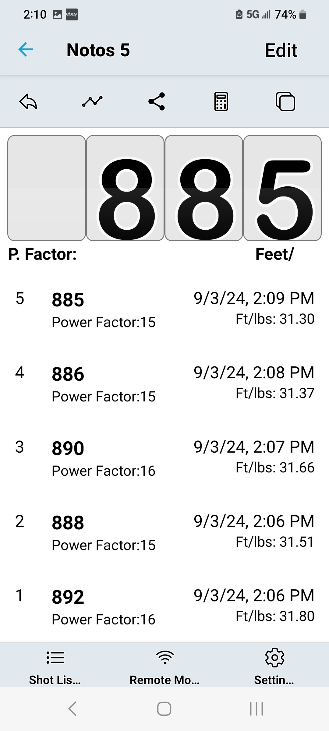

Well took the gun completely apart to get ready to bottle
So while it was apart I decided to open the hole in the block behind the reg to 3.5
Put it all back together orig air cyl with plenum extension
Reg 2100 psi
Backed the hammer adj flush vs 2 turns in
Shot 15.89 and 22gr jts here is the results
i wonder if a different hammer spring would help softer?
Reg 2100 psi
I take it that the first shot string you shot was with the 22gr's & second with the 15.9gr's (due to the FPS vs the FPE... Damn on them 22grain's you've got some really good powerful consistent shots! I'd be happy with 35FPE out of a .22... Not sure if regarding the hammer spring lightness helping for more power, that's above & beyond my knowledge. But seriously, I'd be pleased with that kind of power. Especially seeing how u didn't even pout it on the bottle yet... Didn't mind if I ask, how many consistent shots @ that power on the stock air tube?
