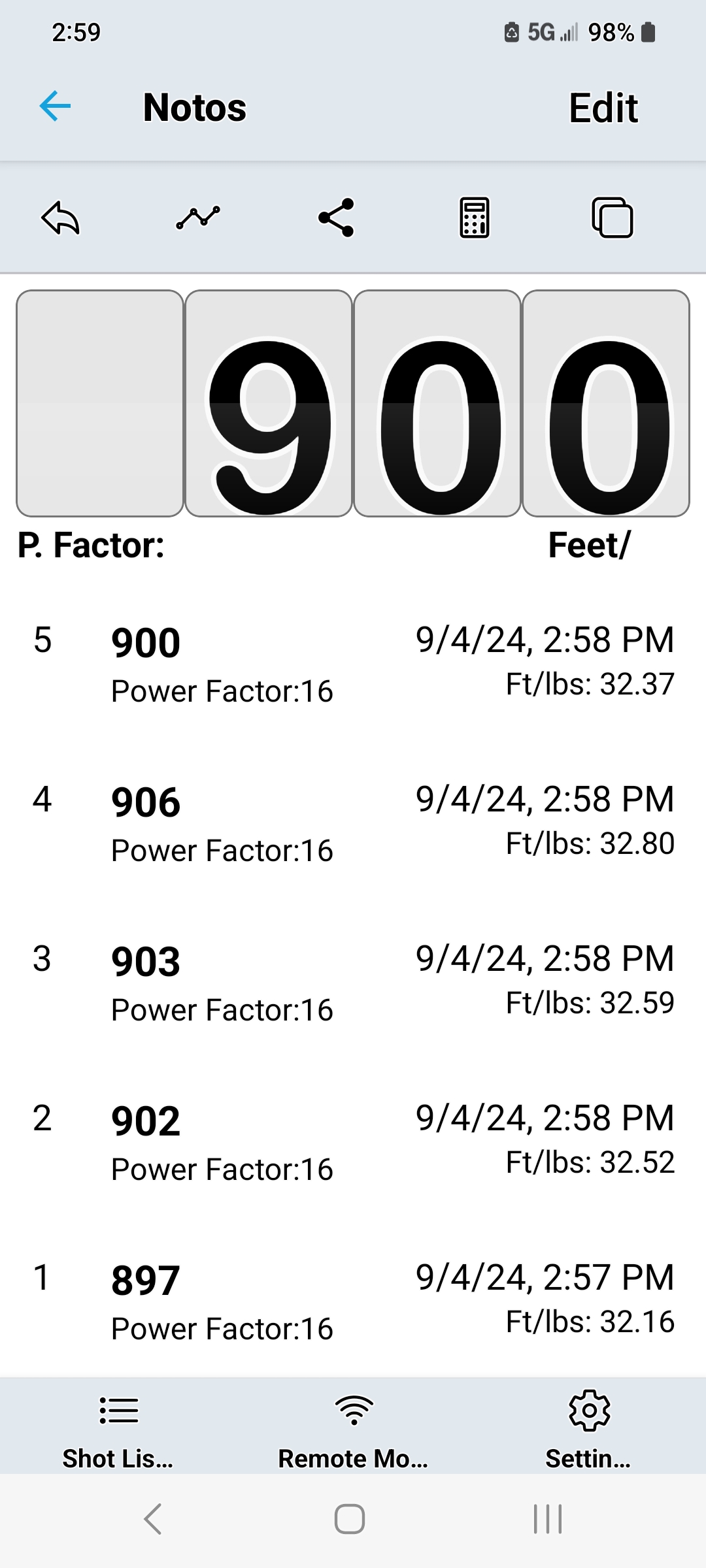

I take it that the first shot string you shot was with the 22gr's & second with the 15.9gr's (due to the FPS vs the FPE... Damn on them 22grain's you've got some really good powerful consistent shots! I'd be happy with 35FPE out of a .22... Not sure if regarding the hammer spring lightness helping for more power, that's above & beyond my knowledge. But seriously, I'd be pleased with that kind of power. Especially seeing how u didn't even pout it on the bottle yet... Didn't mind if I ask, how many consistent shots @ that power on the stock air tube?
Yeah opening the port to 3.5 mm made the difference in both Fpe and Fps
On the sock air tube with 2 plenum extension I get 14 shots before if falls off the reg
I have a .42 bottle coming just waiting for that found some hammer springs
Once the bottle goes on going to try 23- 2400 psi
Should break 900 fps with 15.89 well see Thursday
My goal.was 8 -850 with 28-30 fpe
If it hits 900 I will shoot a couple strings and turn it back to mid 800s

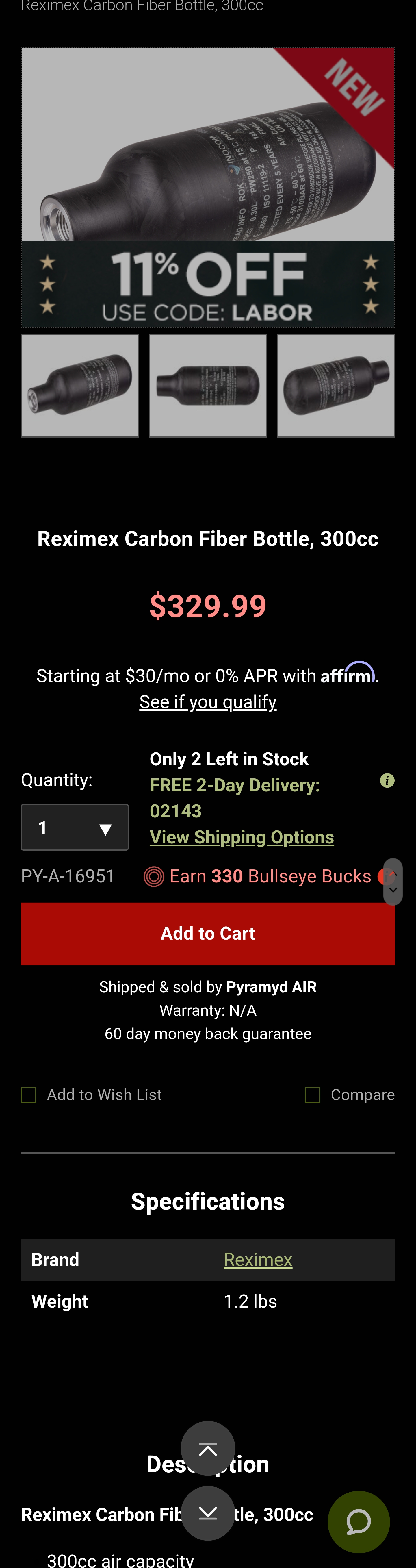

amazon has tuxedo cf bottles on sale for 109 300 bar

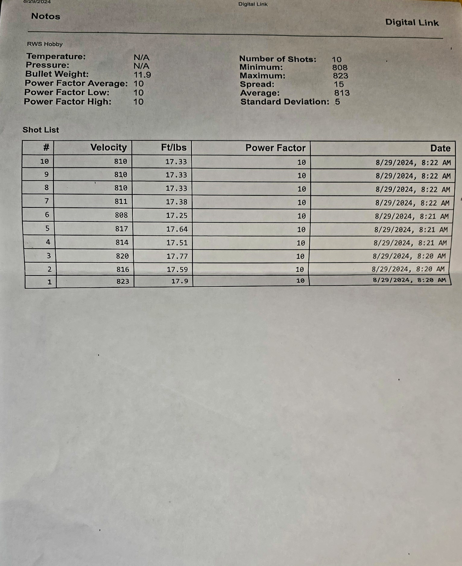

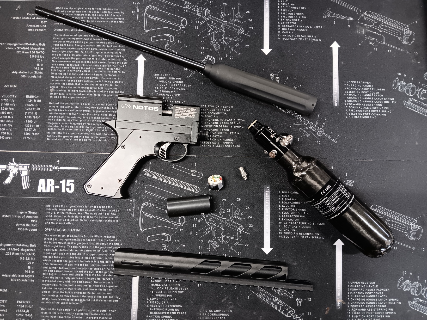

Okay guys finally got the thing together as I said I was that day but ended up leaking air... Sent it back had them do a 10 for 10 they ended up doing & a bottle air pressure test for me on the house ... Needless to say got it back yesterday and honestly right out the box can't complain, I mean 20 FPE from the factory is not a bad platform to start out on. Now I can see why you guys love these things so much! Heres there shot string, and I'll have mine up shortly just having some fun with the old man using the single shot tray. As you guys said these factory umarex mags kind of do suck. Testing different ammo at the moment have about four or five different tins. I'll post the other results shortly. Thank you guys for all the help and support! Definitely going to start modding shortly. Definitely thinking about the restrictor plate getting reamed out, along with the Huma dream regulator with the FX STX barrel mod. As you guys suggested. Let me post the 10 for 10 that they got and my setup for now tried to use my Tricon MRO atop the Notos but the amount was too short for it was a top an ar prior. -Surefire.

Suddenly, I now fully understand Umarex's warranty model, and realize why Umarex does not sell parts to the public.
Kudos to Pyramyd for performing warranty work on a airgun that was disassembled for unknown reasons, then reassembled improperly,
After all that effort , it sounds like your now back to a stock, 18 FPE, out of the box Notos again?

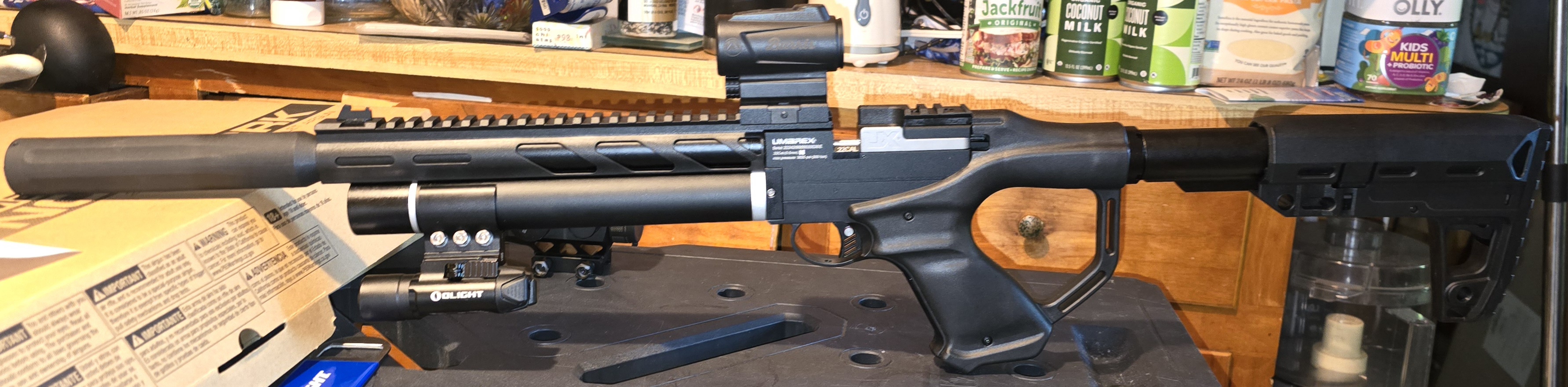

When I built mine with the dream valve, the bottle, 5 custom mags and mod insert. I was $690 price of the gun included. That's not accounting for adding the fx barrel kit $130 for the 380 and $160 for the 500mm, also not including the $110 barrel liner. And I got my bottle for like $100. You can easily get into dreamline, agt vixen, taipan veteran prices.
So $980?… Thank you for your honest assessment…
